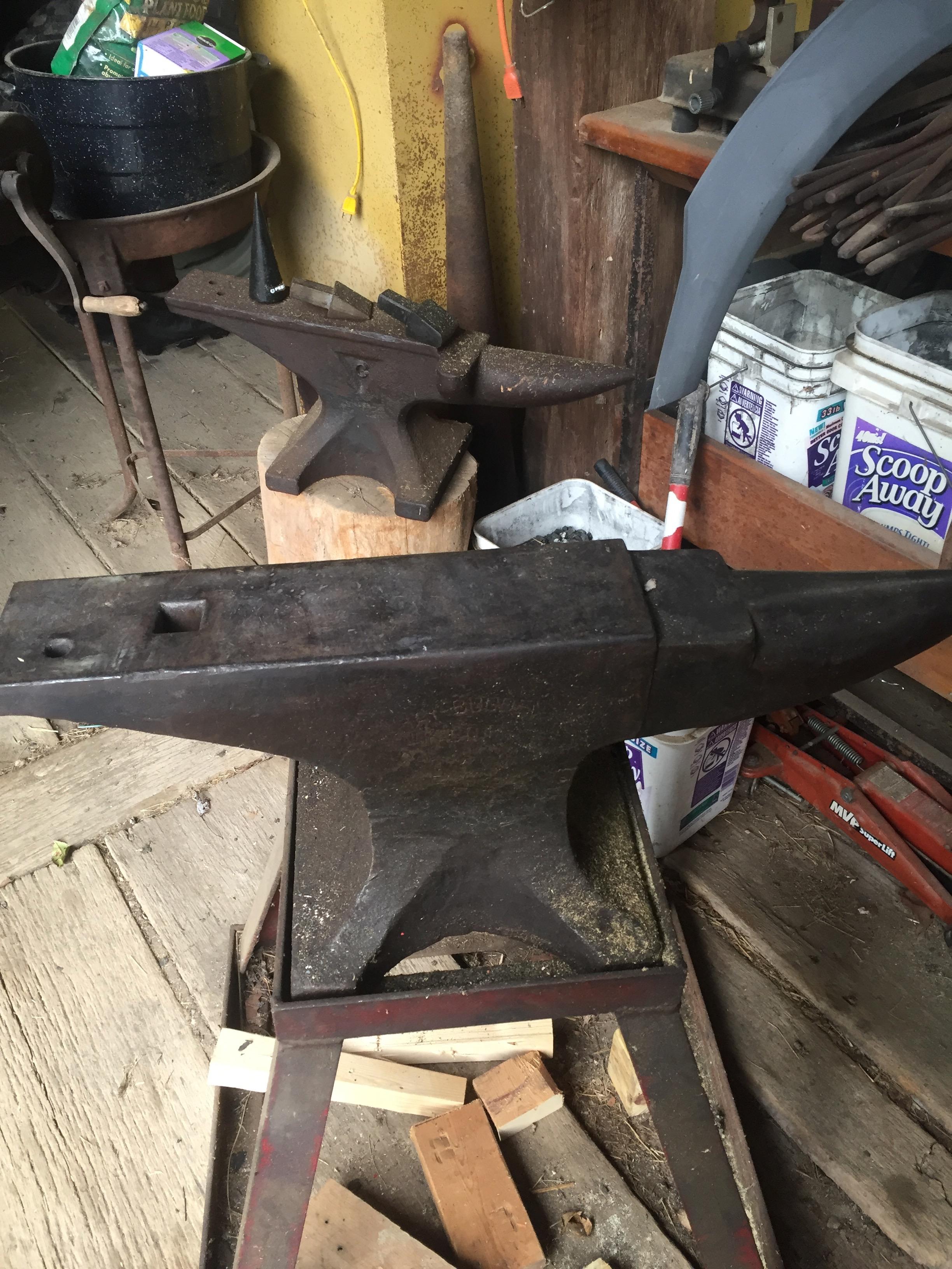

unimog Posted November 16, 2018 Share Posted November 16, 2018 Here is my anvil Quote Link to comment Share on other sites More sharing options...
jlpservicesinc Posted November 16, 2018 Share Posted November 16, 2018 Nice anvils.. Since others will come along and tell you.. Welcome aboard.. and please post location.. Quote Link to comment Share on other sites More sharing options...

Frosty Posted November 16, 2018 Share Posted November 16, 2018 On 10/24/2018 at 6:29 PM, hawk18 said: Those darn bicycle lock people made that cable about 6 or 8" too short. I may have to use a piece of chain. Sounds like a natural early project to me. Forge/bend up a couple steel bands to clamp it down. Putting lots of wraps around the anvil is less stable than two single ones. Hmmmmm? Nice stand Unimog. A flange up angle iron rim is my preference for holding the anvil, neither of mine move in use even without the hammer/tong racks wedging it in place. I like a tripod better than a quad but if you have a smooth floor it doesn't matter. Frosty The Lucky. Quote Link to comment Share on other sites More sharing options...
