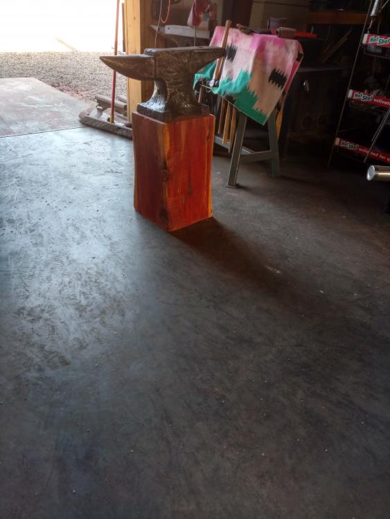

Rojo Pedro Posted February 25, 2018 Share Posted February 25, 2018 Actually 3 4x12s. It clamps real tight and I could hear them crunching as I tighted them up. Works much better than the the ratchet strap I was using. This was the first time I used my post vice to forge with, bent the corners then cleaned them up on the anvil, very fun to do, love my new hobby! Quote Link to comment Share on other sites More sharing options...

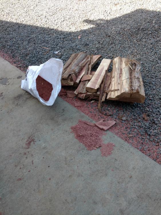

JHCC Posted March 5, 2018 Share Posted March 5, 2018 I hope you saved the bark and the offcuts from squaring up the block. Makes great tinder and kindling, excellent for starting the fire in your forge. Quote Link to comment Share on other sites More sharing options...
Reeltree Posted March 5, 2018 Share Posted March 5, 2018 Yeppers,,,and a nice size bag of shavings for aroma satchels,,I don't let much go to waste around here,,cedar is a fav. to burn in stove during the holidays and throw a couple pieces on the fire pit for the nice colors it puts out, Quote Link to comment Share on other sites More sharing options...
Daswulf Posted March 5, 2018 Share Posted March 5, 2018 That's a beautiful chunk of wood for an anvil stand. Quote Link to comment Share on other sites More sharing options...

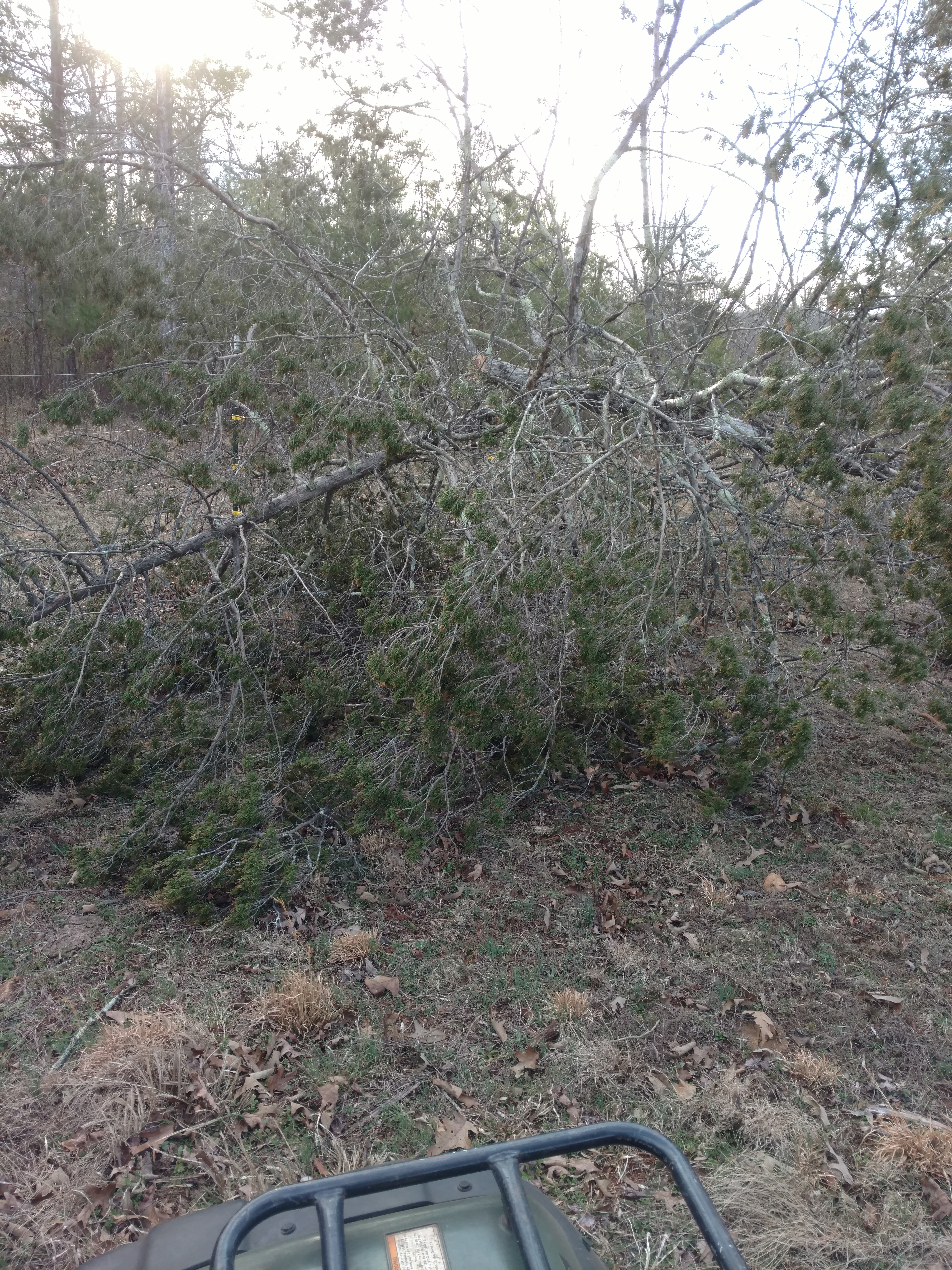

Reeltree Posted March 5, 2018 Share Posted March 5, 2018 Speaking of cedars , just finished checking fence lines for down trees from high winds..and more cedar to be had. Quote Link to comment Share on other sites More sharing options...
Lefse Posted May 22, 2018 Share Posted May 22, 2018 It's not set in sand fite me Quote Link to comment Share on other sites More sharing options...
ThomasPowers Posted May 23, 2018 Share Posted May 23, 2018 If the frapping is needed I would suggest tying it off every time it goes behind the wooden piece. Otherwise the first time hot steel hits the twine you may have a unstable weight on your toes... Quote Link to comment Share on other sites More sharing options...
Lefse Posted May 23, 2018 Share Posted May 23, 2018 There's 5 or so knots in there not too worried about catastrophic failure. In such an event I have my steel toe boots to thank... hopefully... Quote Link to comment Share on other sites More sharing options...
JHCC Posted May 23, 2018 Share Posted May 23, 2018 The downside is you can only use that one alignment, and there’s no way to use any of the other surfaces without untying the frapping. Quote Link to comment Share on other sites More sharing options...
Irondragon Forge ClayWorks Posted May 23, 2018 Share Posted May 23, 2018 A better hold down would be a small cable with a turn buckle to replace the frapping. Quote Link to comment Share on other sites More sharing options...
JHCC Posted May 23, 2018 Share Posted May 23, 2018 Or a welded or riveted strap that would loop over both anvil and stand and get wedged in place. Easy to knock out the wedge for repositioning, if you want to access a different face. Quote Link to comment Share on other sites More sharing options...
