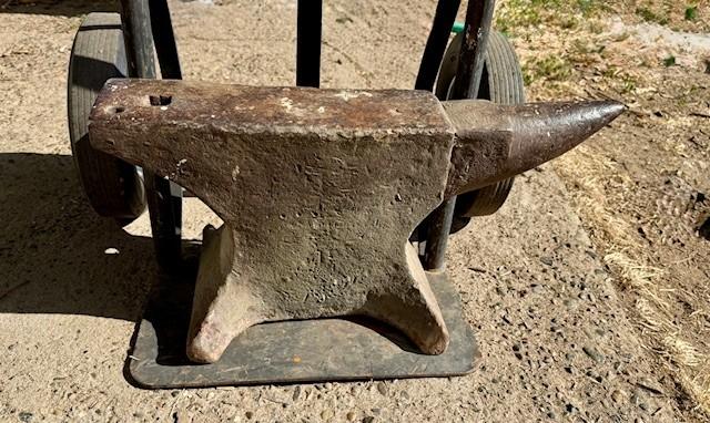

jep Posted April 28, 2011 Share Posted April 28, 2011 I picked up a Hay Budden anvil about a month ago and wanted to build a stand for it. Thanks to all the stands pictured on this forum I was able to get some design help and combine that with some metal from the metal pile and here is what I came up with. Link to comment Share on other sites More sharing options...

John McPherson Posted July 1, 2011 Share Posted July 1, 2011 I have only used stumps, and a light weight box on a tripod in the past as anvil stands, and mostly with under 200 pound London pattern anvils. Inquiring minds want to know, especially before they butcher a one inch thick drop and lose half the mass that they paid for. So.... Dragging this one back up to ask some questions about the wide boat shape versus narrow profile base plates, for those who have used or own the Hofi/Euroanvil/Tom Clark/Rathole type anvil and specialized stands. (1) How often do you actually use the pass-thru holes in the base plate under the hardy and pritchel for upsetting long bars, etc? Would a plate on the ground beside the anvil and holding the stock against the base not do just as well as passing it thru? (2)The Avadon type stand with the longitudinal square tube looks like it would be in the way of the pass thru, unless you beefed it up as an intermediate height upsetting block. But that style seems to lack the holes in the base plate. (3) Do you really need to cut out the crescent between the feet on the near side to get *that* close to the anvil for some things? Or is that small shelf space more useful to hold your punch lube/chisel rack/spit can? (4) Is a triangular expanded metal catch tray under the baseplate really in the way unless you are crowding the anvil to work on the shelf on the far side? Link to comment Share on other sites More sharing options...
Sask Mark Posted July 1, 2011 Share Posted July 1, 2011 I have only used stumps, and a light weight box on a tripod in the past as anvil stands, and mostly with under 200 pound London pattern anvils. Inquiring minds want to know, especially before they butcher a one inch thick drop and lose half the mass that they paid for. So.... (3) Do you really need to cut out the crescent between the feet on the near side to get *that* close to the anvil for some things? Or is that small shelf space more useful to hold your punch lube/chisel rack/spit can? My stands with the crescents cut out are used on my larger anvils (280, 450 pounders). I did this for a couple of reasons: 1) Since they are larger anvils, I sometimes have to reach farther to work the stock over the horn. In this situation, I like to get very close to the anvil. The crescents cut out allow that. 2) The steel was cut and given to me for free. My smaller anvils are siliconed onto stands with square plates. Link to comment Share on other sites More sharing options...
