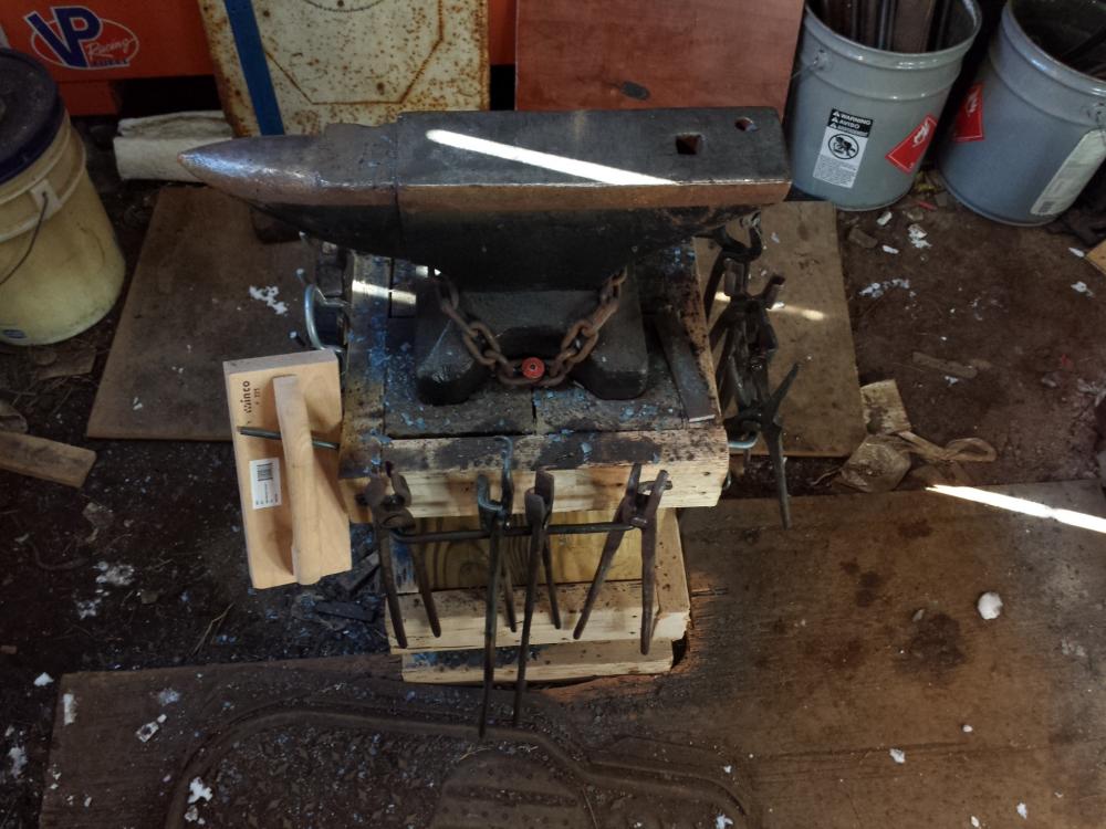

Rojo Pedro Posted February 24, 2018 Share Posted February 24, 2018 I made 4 of theese.... And 3 4x12s equals....... Works real well and was my first real "tool" Link to comment Share on other sites More sharing options...
