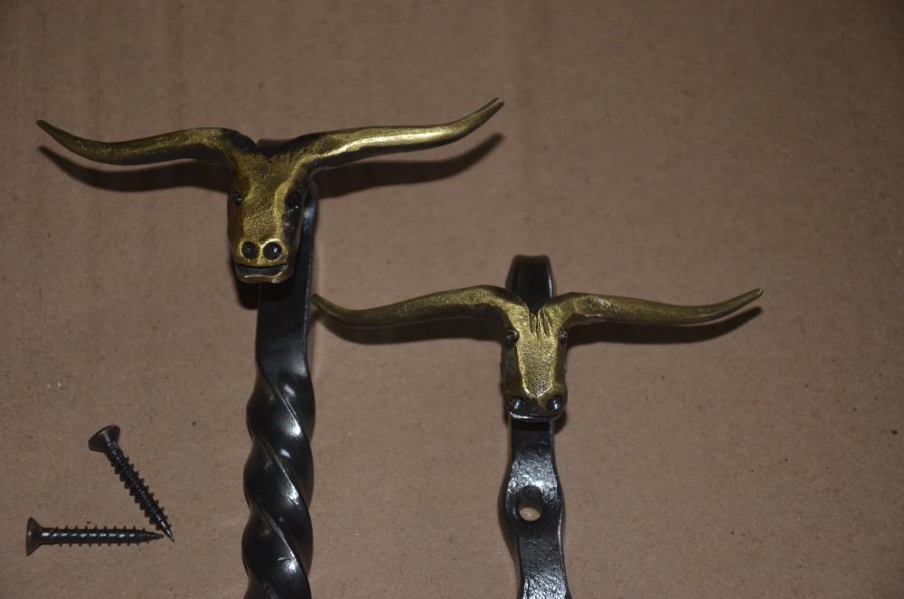

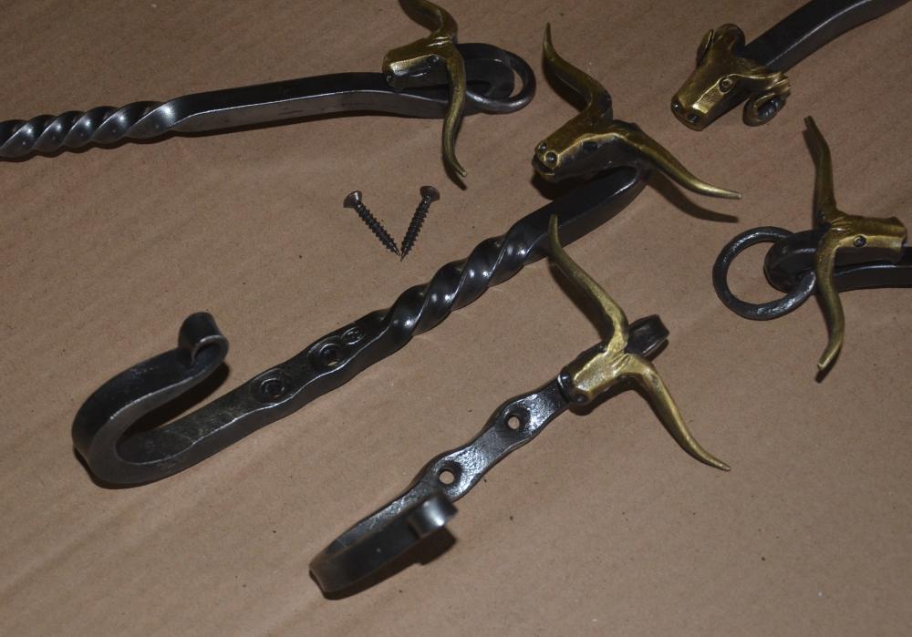

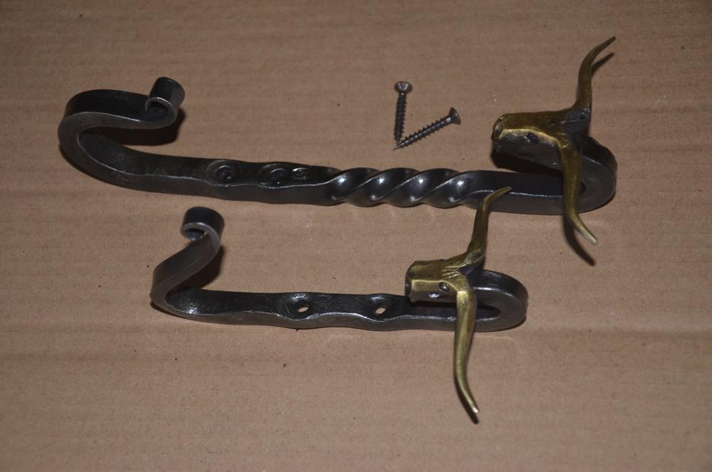

These hat hooks with the long horn bull are popular amongst station people. (Ranchers in the U.S.) The bull looks over the brim of the hat.
Started with 10mm square bar. The hook has a good curl on the end to avoid sharp points -  Mr Cattlemen wouldn't like holes in his town akubra. ;)
You do such nice long horns Aus. A living example of what practice will earn you.
I'd call those coat hooks, a hat hook would have a wide curved fish tail finial on the hook to support a wider section of the band.

Yes, I think the next ones will have the wider finial. I hope you do have a go at a moose head Frosty. How about we set ourselves a challenge? You do a moose head and I'll have a go at a kangaroo head!

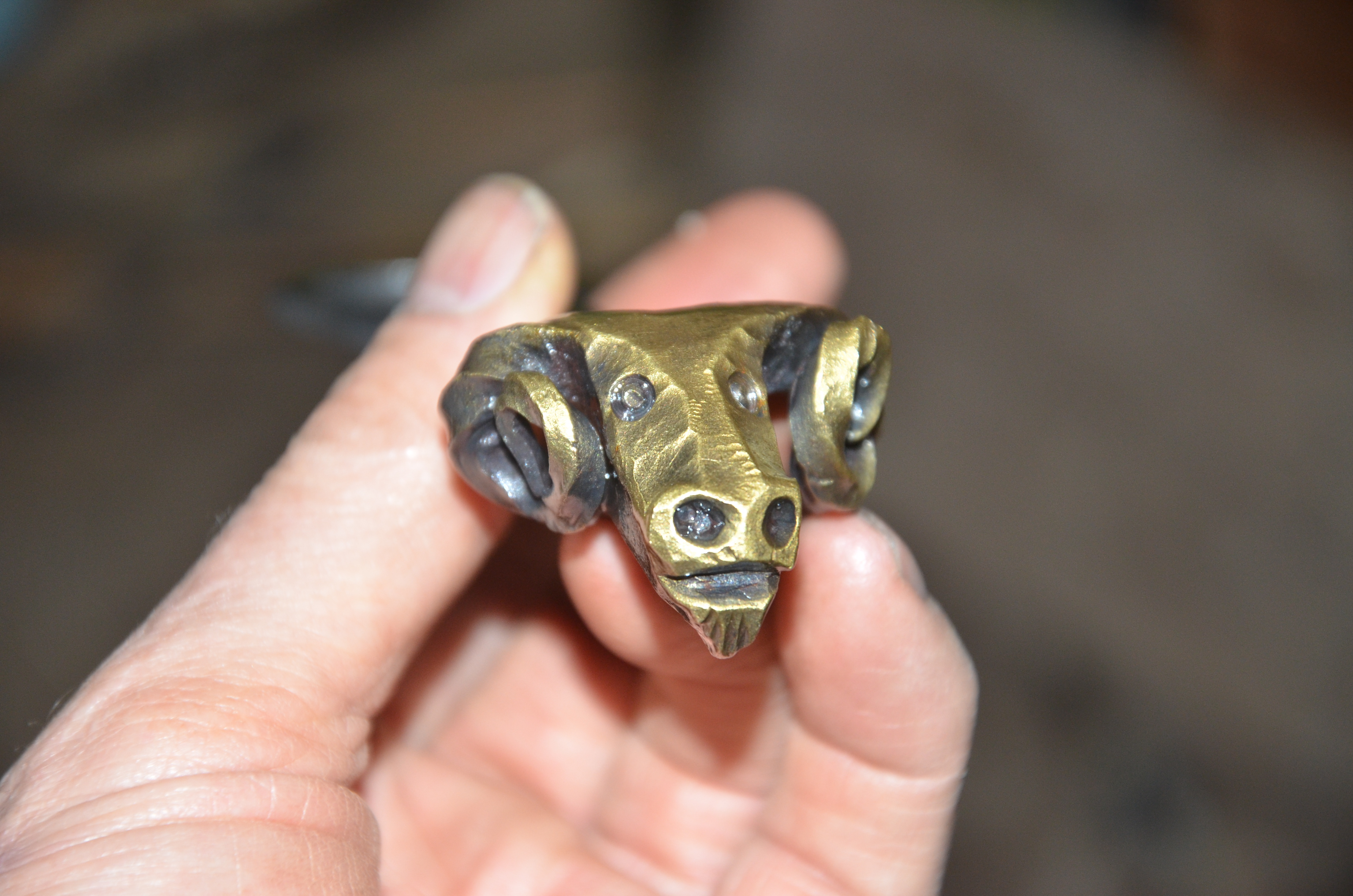

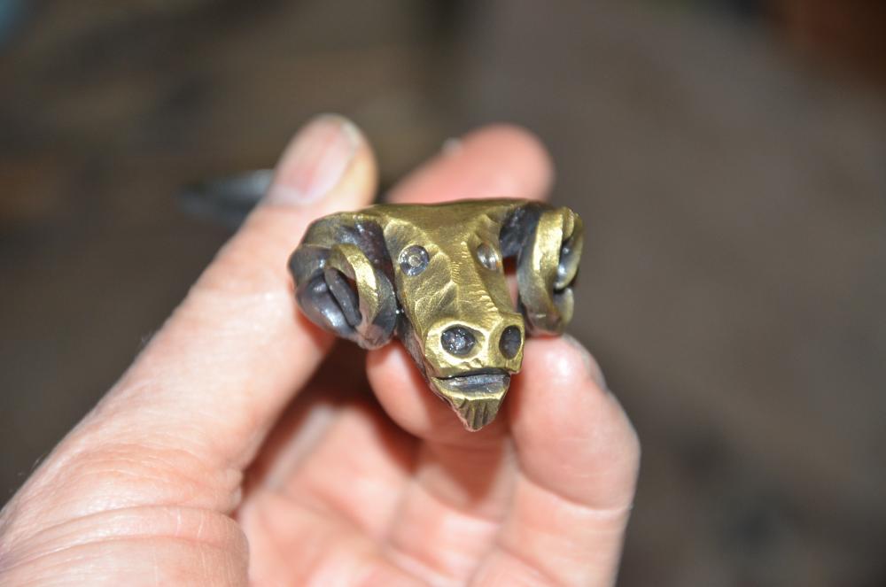

Hi CrazyGoatLady. Thank you for your kind comments. I do like forging animal heads and they make interesting demo pieces. The ram heads make really good bottle openers, as they fit in the hand nicely. Long horn bulls are good for lifting for obvious reasons.
Perhaps you could post a picture of a goat with horns as you would like to forge them, and I will happily have a try. I did make a beard on a ram once, as in the picture below, but it was a bit trickier than I thought and didn't work out too well. I think it gave him the look of a lion.
