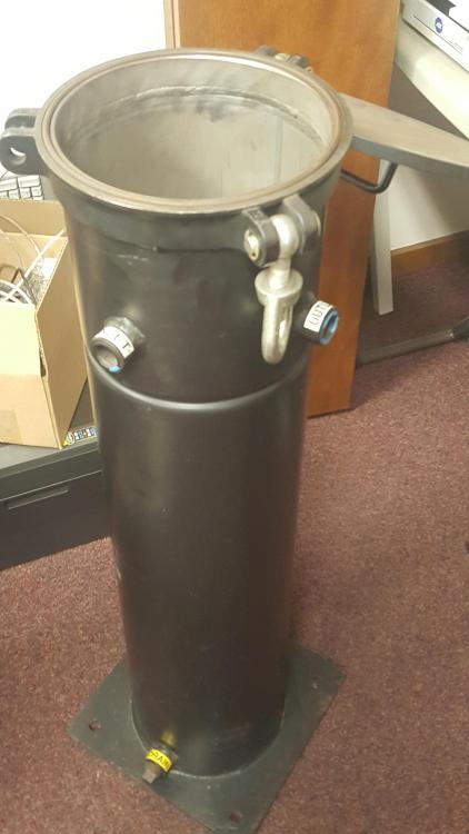

gosak Posted June 27, 2017 Author Share Posted June 27, 2017 I'm in New England area, it's a filter. I think is mass production. Here is picture of hole unit. the forged part is top part (ring with ears) I hope is not from china... There is number 8-6494 probably the part number, WCB - material(steel) ? and 12-08 -->date I guess Greg Link to comment Share on other sites More sharing options...

ianinsa Posted June 27, 2017 Share Posted June 27, 2017 that ring looks cast. however it would be a doddle for a machine shop to make up! are you looking for a repair or copies of sorts? sadly I can't help with the work but advice no problem! Link to comment Share on other sites More sharing options...
gosak Posted June 27, 2017 Author Share Posted June 27, 2017 I'm working on reverse engineering for this filter. and maybe start production soon. but there is not enough money in this project to make it form solid steel. Link to comment Share on other sites More sharing options...
ianinsa Posted June 27, 2017 Share Posted June 27, 2017 if its for pool water It could be made from 304 tube with "" ears welded on for guys ïn the know"" not really difficult nor that spendy. if its for low pressure and potable water a galvanised top ring and pvc parts could do the job. however none of this work requires a forge! Link to comment Share on other sites More sharing options...
gosak Posted June 27, 2017 Author Share Posted June 27, 2017 is actual for high pressure oil. but you probably right. it maybe cast. Link to comment Share on other sites More sharing options...
ianinsa Posted June 27, 2017 Share Posted June 27, 2017 that said it would be easy to whip up something suitable with schedule pipe, tools req. lathe welding machine and a couple of plasma/laser/flame cut "ears" depending on location bolts like that/or similar cam be "off the shelf "or made up none the less not really difficult stuff, Link to comment Share on other sites More sharing options...
John McPherson Posted June 28, 2017 Share Posted June 28, 2017 With that grainy texture and raised trademark, it is definitely cast, but from what? Something weldable and machinable. Castings became hard to make in the US due to OSHA and clean air laws, most production moved overseas years ago. If you have to have it made in the US, welding it up and machining it down is the way to go. It is a simple fabrication job, but you may not like the price for just a few. Link to comment Share on other sites More sharing options...

JNewman Posted June 29, 2017 Share Posted June 29, 2017 WCB is cast steel I think it is basically a mild steel. While the cast metals industry has taken a beating over the last several decades there are still lots of foundries around in North America, Canada US and Mexico. I can easily think of 5 or 6 foundries within an hour of me that could and would cast those in quantities of 4-5 to hundreds. The number that would only cast one is smaller but there are another couple that typically cast larger castings but would cast them in higher volumes. While you would have up front Pattern costs, I suspect they could be cast for less than they could be fabricated if you are talking any volume. As well you would not be restricted to stock sized pipe for the diameter. You guys need to calm down about the patent infringement issue. This is a filter body hundreds perhaps thousands of companies make something similar. It is a ring for a dogged door a feature that has been used on hundreds of applications for centuries. This is significantly different from copying a piece of art or a new invention. Link to comment Share on other sites More sharing options...
Judson Yaggy Posted June 29, 2017 Share Posted June 29, 2017 I agree with John N. Not a particularly complicated or proprietary product. Manufacturing back in the USA? Great. That said it looks like a fab job with a cast ring on the top. Good luck to the OP, my first job out of college was as a draftsman/part number chaser who was tasked with reproducing badly documented products designed by someone who had left the company x years ago. So I feel your pain. On 6/28/2017 at 6:43 PM, Frosty said: You need a better translation program at least, even your syntax is pitifully wrong. Frosty, as a New Englander I find nothing wrong with his syntax aside from typos and that xxxx autocorrect. After all we have a BIG WIDE language. Also, I have noticed in the last few weeks the automatic spell chech here on IFI has stopped workingdr. Problematics for those of us whoo've aleays struggled with spelling even in outs fiorst langueage. Link to comment Share on other sites More sharing options...
