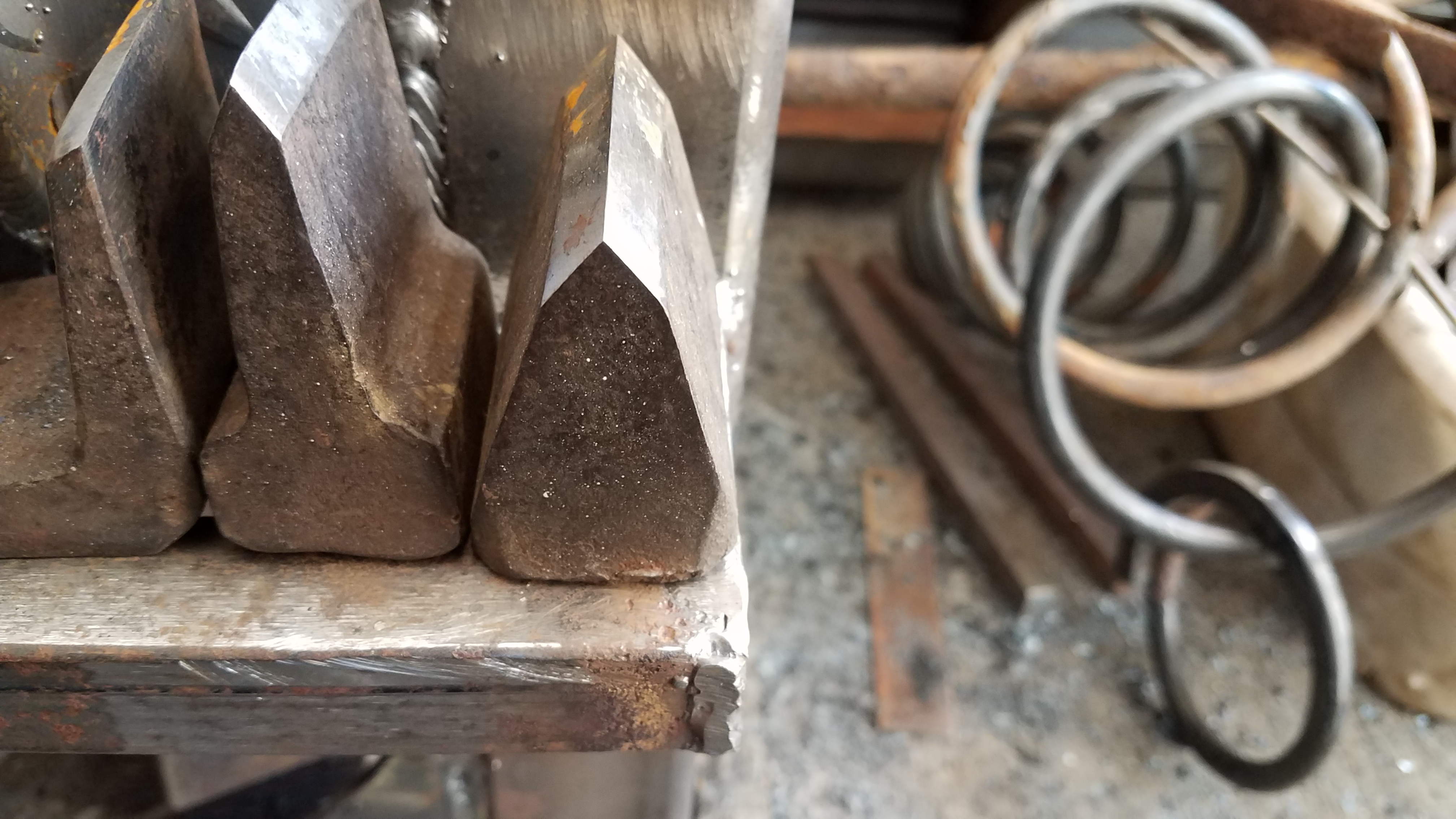

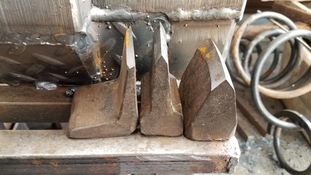

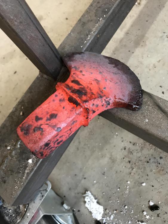

jlpservicesinc Posted June 21, 2017 Share Posted June 21, 2017 Show your hardies.. doesn't matter, shape, size.. You make, they make, MFG make.. Here are the ones I use on a regular basis and a combination hardie I made for a friend Link to comment Share on other sites More sharing options...

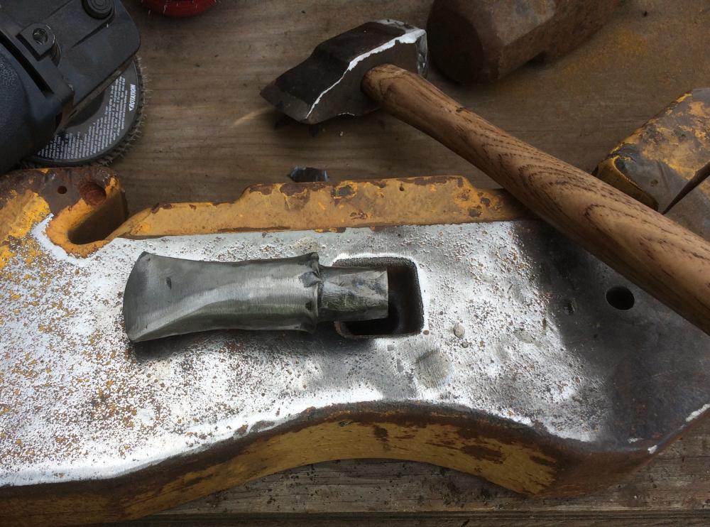

HP500 Posted June 22, 2017 Share Posted June 22, 2017 Here is my first attempt at making a hot cut that I just finished tonight. I made it from a broken jack hammer bit. It ain't pretty but I think it will work. Link to comment Share on other sites More sharing options...

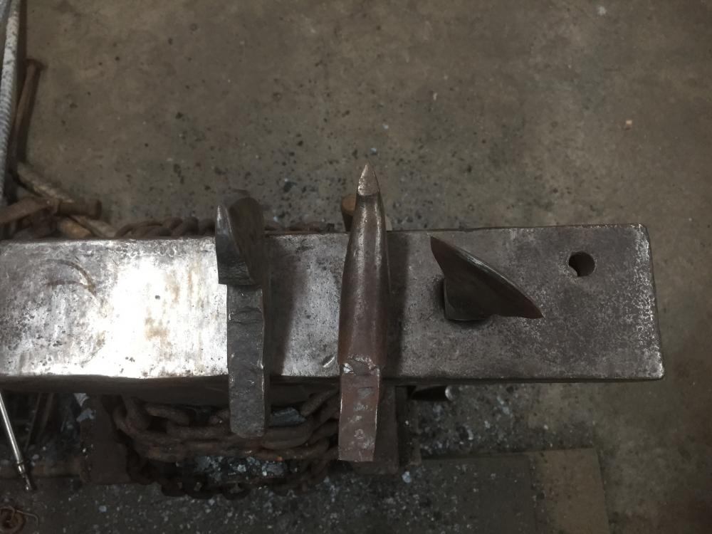

Daswulf Posted June 22, 2017 Share Posted June 22, 2017 Here are my 3 hot cut hardies. Pete ( Crazy Ivan) and I made the diagonal hot cut that is in the hardy hole. ( his idea, lol I can't take any credit other then striking) I love the diagonal hot cut. The other two I do use sometimes. Link to comment Share on other sites More sharing options...

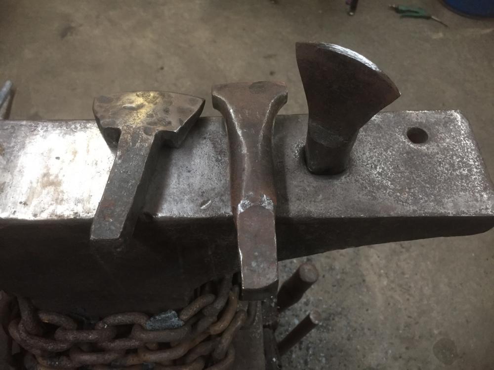

ThomasPowers Posted June 24, 2017 Share Posted June 24, 2017 Link to comment Share on other sites More sharing options...
Mark Ling Posted June 24, 2017 Share Posted June 24, 2017 That bottom left one is a hot cut right? hahaha! its massive! Littleblacksmith Link to comment Share on other sites More sharing options...
ThomasPowers Posted June 24, 2017 Share Posted June 24, 2017 I think it came off a log splitter, but next time I run my arc welder I'm going to put a 1.5" stem on it and use it with my BIG Anvil as a hardy. (and tool for spreading fork tines after cutting them with a slitter---heat and push down on that one!) Link to comment Share on other sites More sharing options...

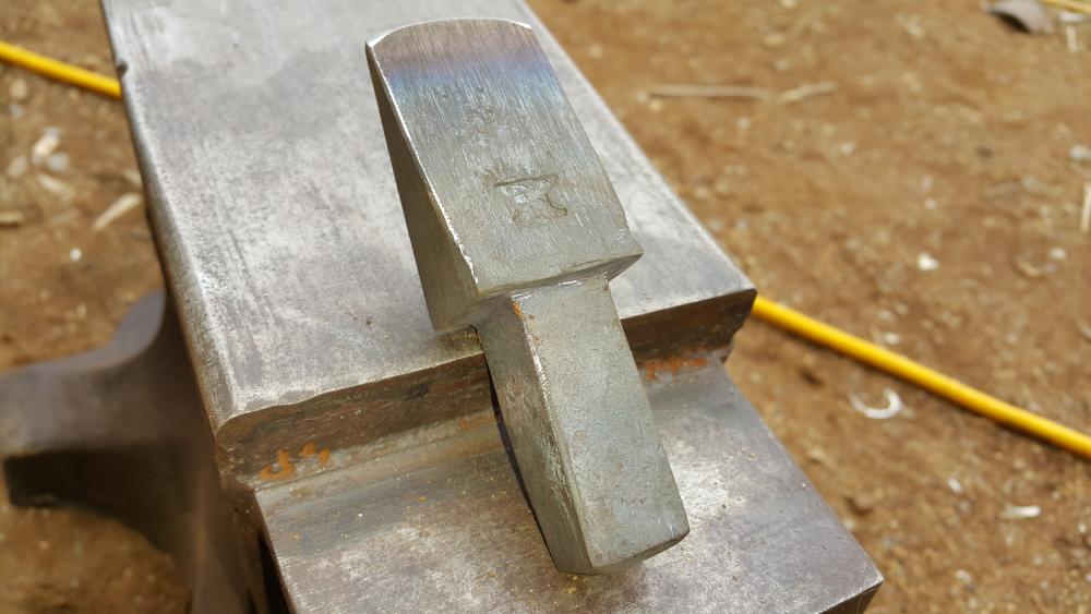

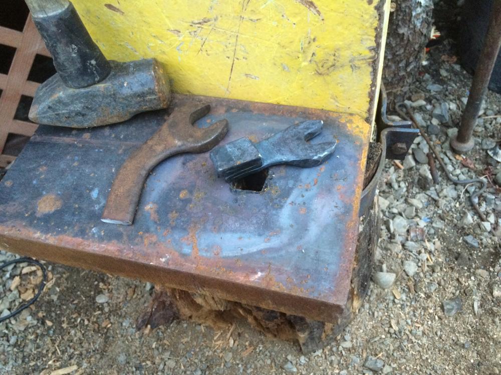

Happy Fish Forge Posted September 3, 2017 Share Posted September 3, 2017 I found an old masonry chisel at the scrap yard. Hammered the beat up double bevel into a single for no other reason other than I like the reasonably clean cut the flat side makes. Didn't have any 1" square so I used 4 pieces of 1/2" for the shank. A little time on the belt grinder and it works fine with no heat treatment. Link to comment Share on other sites More sharing options...
jlpservicesinc Posted September 3, 2017 Author Share Posted September 3, 2017 I like it.. Link to comment Share on other sites More sharing options...

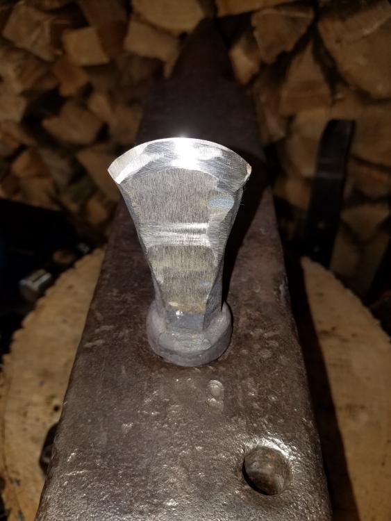

LaPetiteForge Posted October 16, 2017 Share Posted October 16, 2017 My first hardy hole tool, forged this last Sunday with a good mate....pretty proud of the outcome. Forged 1040(en8) steel. Link to comment Share on other sites More sharing options...

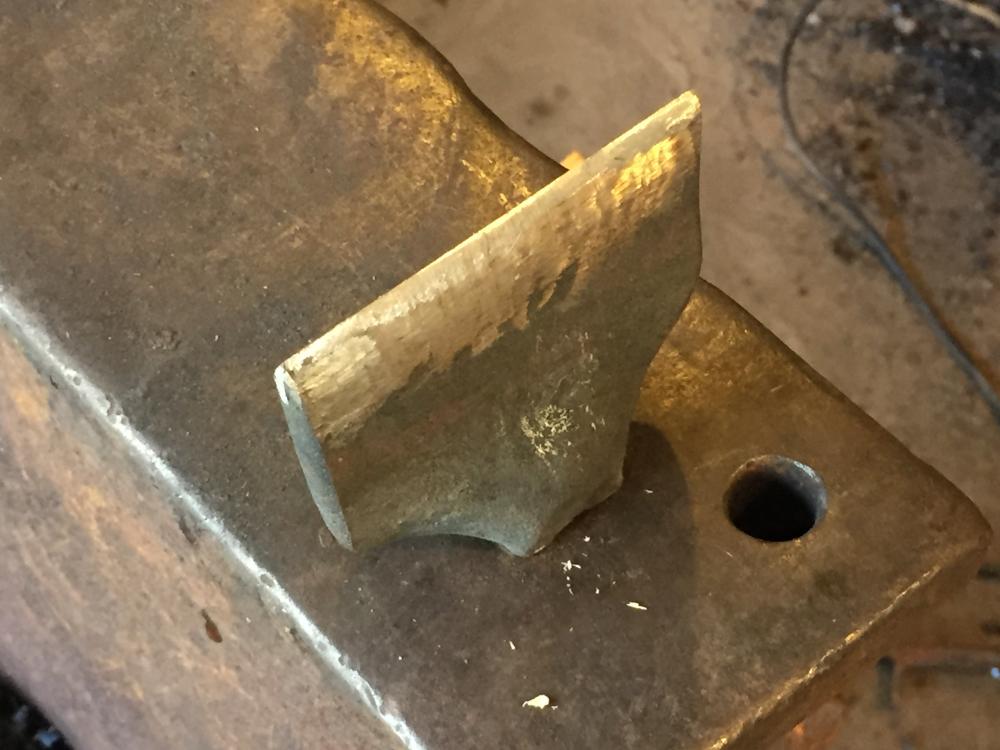

JHCC Posted October 17, 2017 Share Posted October 17, 2017 Here's my most recent one, made from a rolled-up piece of truck leaf spring. Note the small fuller on one end of the edge, for cutting part way through a workpiece. I got the idea from one of basher's videos; you make the cut and then round out its bottom to prevent a cold shut. Link to comment Share on other sites More sharing options...

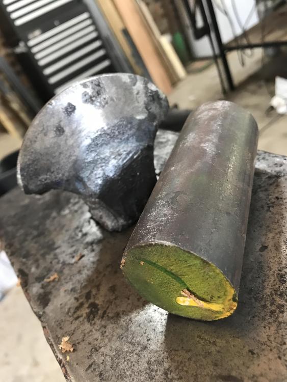

Lonny75 Posted October 3, 2019 Share Posted October 3, 2019 This is my very first attempt at forging anything. My intent was to make a hot cut . Frosty kindly pointed out what I made was actually a cold cut. Will be trying to make a hot cut again soon, this time with a little more knowledge than last time. Anyway here it is . 4140 pin used in heavy equipment. Link to comment Share on other sites More sharing options...
