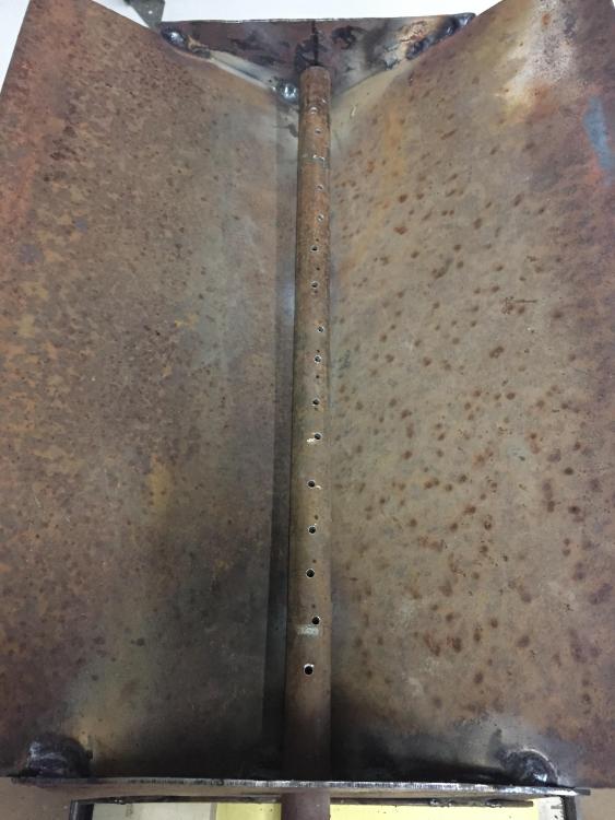

I've made this little one last week end.  I've just mocked it up... I have to finish the welds, clean and grind a little and... enjoy it !  100% from scrap sheet metal (former trailer fenders)
Kaleb: Plan 1. bzzzzzzzzzzzzzzz. It's a stinker. See Goater's V trench forge. You can forget the brick if you mix aproxx 1 pt.clay and 2pts.  sand. Dampen just enough it'll ram hard with a mallet, end of a board, etc. and ram it into a V trench. You can place the air supply like Goater's with a series of holes along it's length or use it like a more traditional side blast. Place the end of the air pipe a couple inches off the bottom of the trench at one end. It's a forge.
