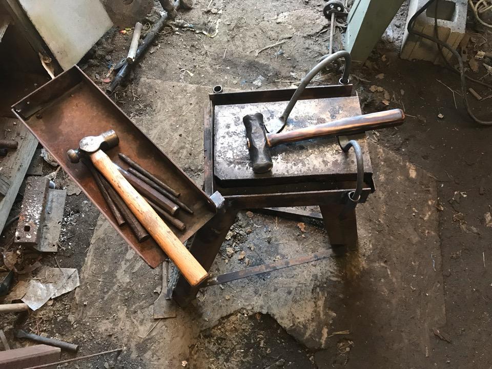

Jasent Posted February 2, 2020 Author Share Posted February 2, 2020 Got my 2 1/4 lb rounding hammer handled and dressed, made the bottle openers with it, couple hold downs for the striking anvil and welded up a quick tool tray. Can be mounted on all 4 corners and I may add some pipe to the legs so I can mount it down and out of the way Link to comment Share on other sites More sharing options...

Jasent Posted February 9, 2020 Author Share Posted February 9, 2020 Well it was going great until this happened. Hoping I can grind it out Link to comment Share on other sites More sharing options...

Goods Posted February 9, 2020 Share Posted February 9, 2020 Jasent, what steel is that hammer head forged from? Was it a repurposed steel that could have gotten a cold shunt while forging, or new steel that had a defect? It looks like you will loose a lot of material trying to grind that out. David Link to comment Share on other sites More sharing options...
Jasent Posted February 10, 2020 Author Share Posted February 10, 2020 The bottle opener finish is burnt BLO it is recycled steel and could have had the crack but I didn’t see it I’ll clean up the rest of the stock and look it over i May have just hit it too cold. Had just sheared the plug and hit the face to release my punch. Then noticed the crack pulling out the forge to start drifting Link to comment Share on other sites More sharing options...
jlpservicesinc Posted February 10, 2020 Share Posted February 10, 2020 Bummer on the crack.. What was the parent stock for the hammer? Link to comment Share on other sites More sharing options...
Jasent Posted February 10, 2020 Author Share Posted February 10, 2020 I assume it was key stock as it’s precision ground with sharp corners. 2”x2” and sparks like 1050 though oil quench gave grain structure like glass. Recycled stock So not 100%. Link to comment Share on other sites More sharing options...
Jasent Posted February 11, 2020 Author Share Posted February 11, 2020 Parent stock has no cracks. I think I need to do a bit more testing with this steel. Seems more like tool steel than key stock. Kinda reminds me of O1 though sparks are not the same. Very close to coil spring in spark. 2/3’s done with my bbq set. Not happy with the twist on the fork but it is one of my better forks Link to comment Share on other sites More sharing options...
