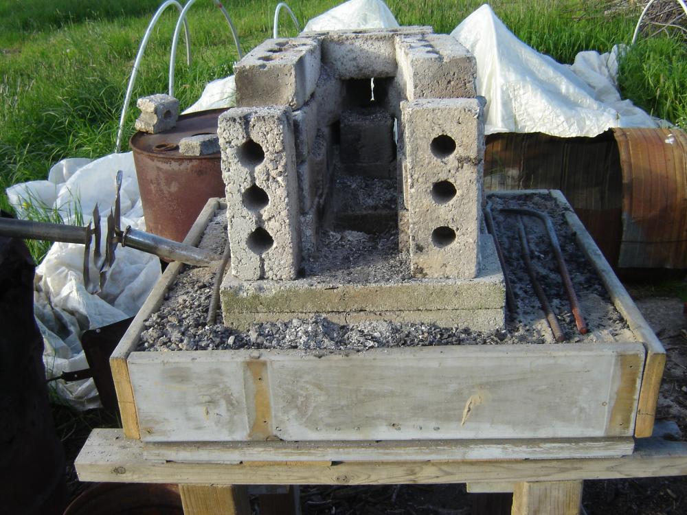

I have been blacksmithing for a few months using a simple wooden table filled with clay.
I had a lot more success with my newest forge compared to the old ones I made before.
However, while I can fairly easily heat steel to an orange heat, I can difficultly reach a white heat or a welding heat.
I have observed that my charcoal can glow from time to time to a bright white heat and heat my stock quickly, but it is not consistent.

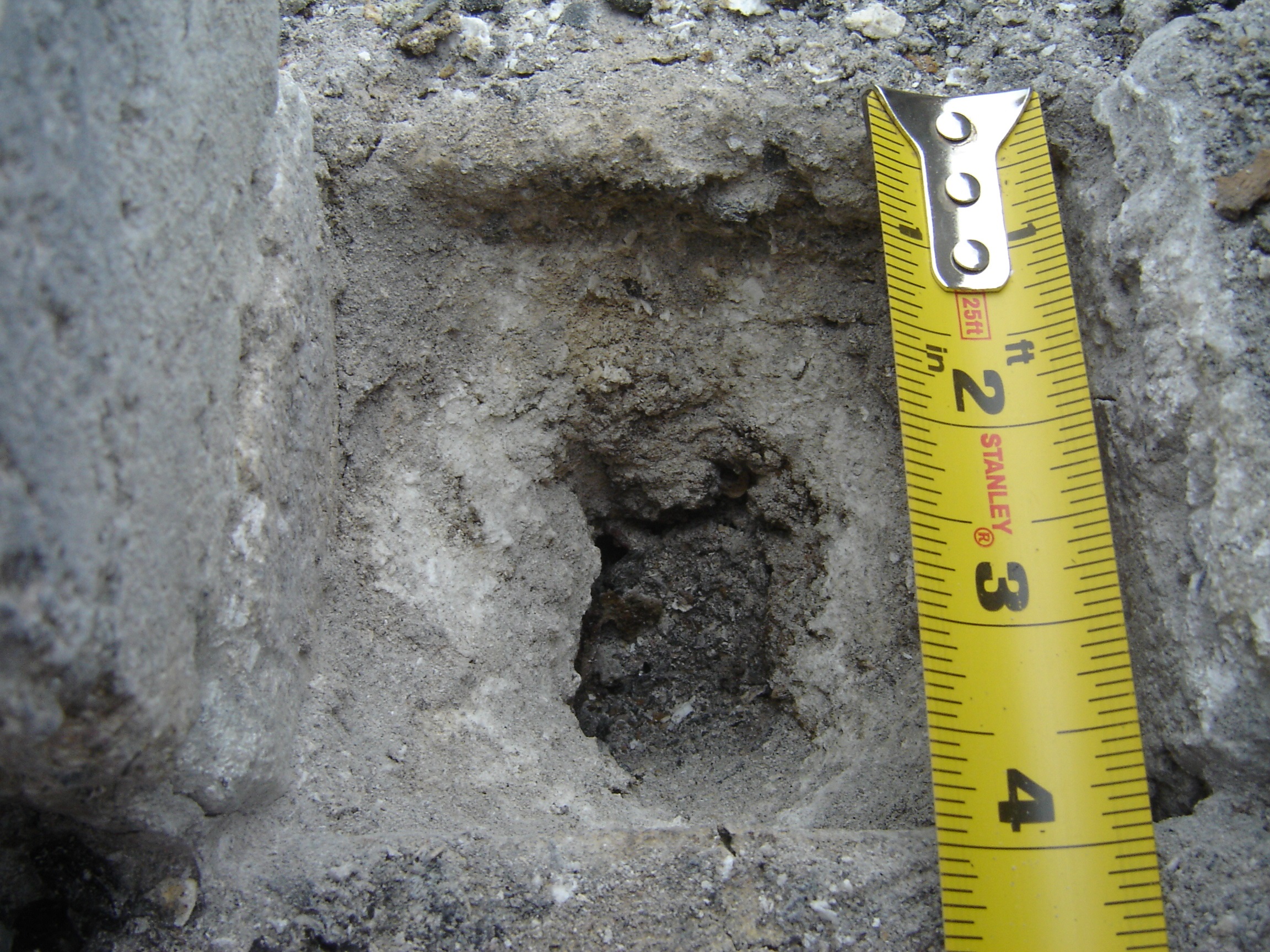

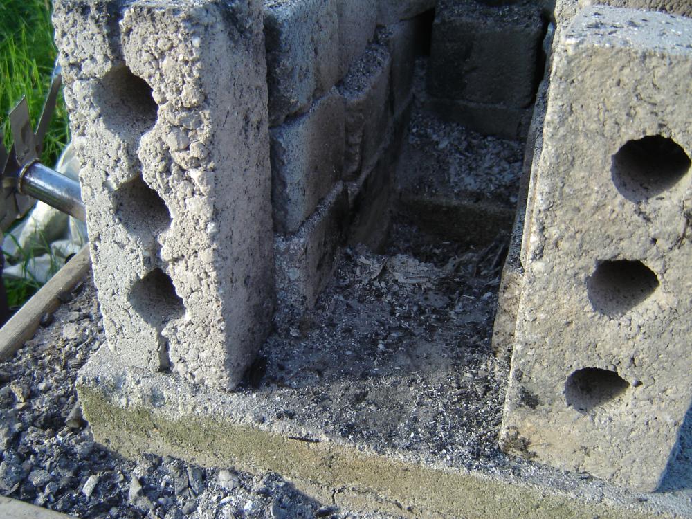

I believe my problem is that the charcoal don't fall easily into the fire pot and a lot of void is created.

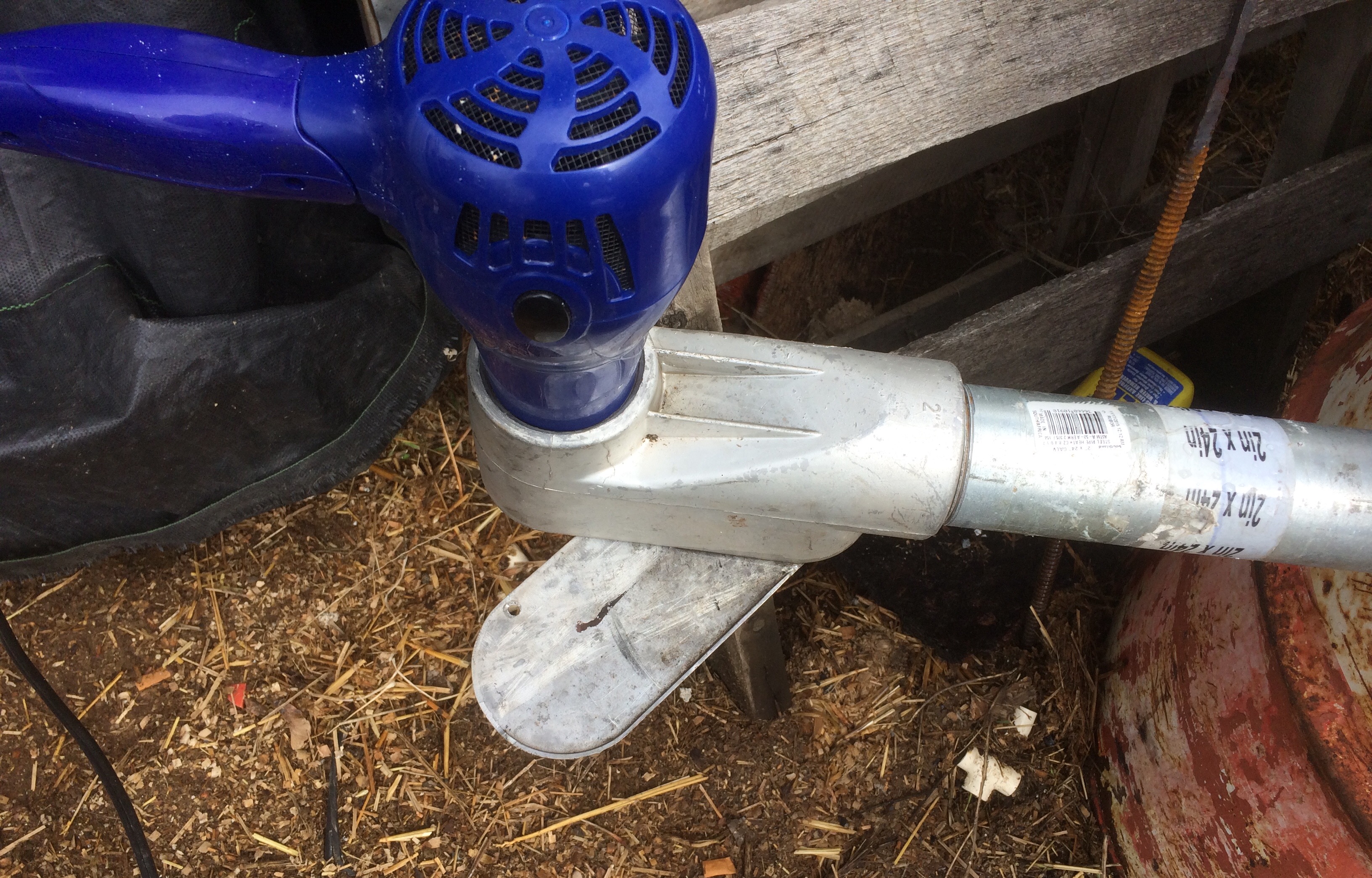

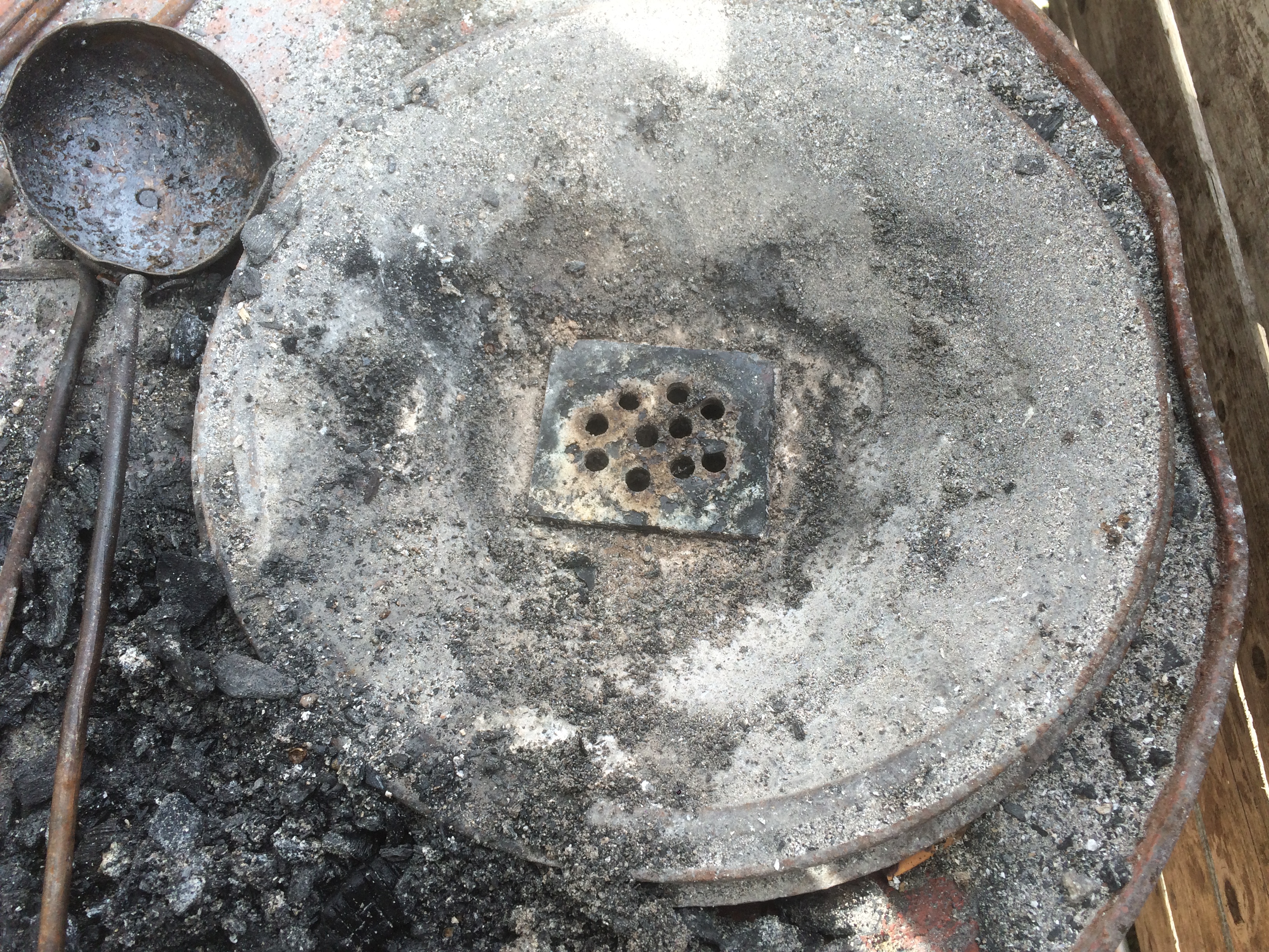

To bring air to the forge, i use a shop vac and control the airflow by increasing or decreasing the distance between the tuyere and the shop vac's pipe.
Maybe I should enlarge the fire pot?
We can't see it clearly, but my forge is surrounded by bricks for wind protection and insulation.

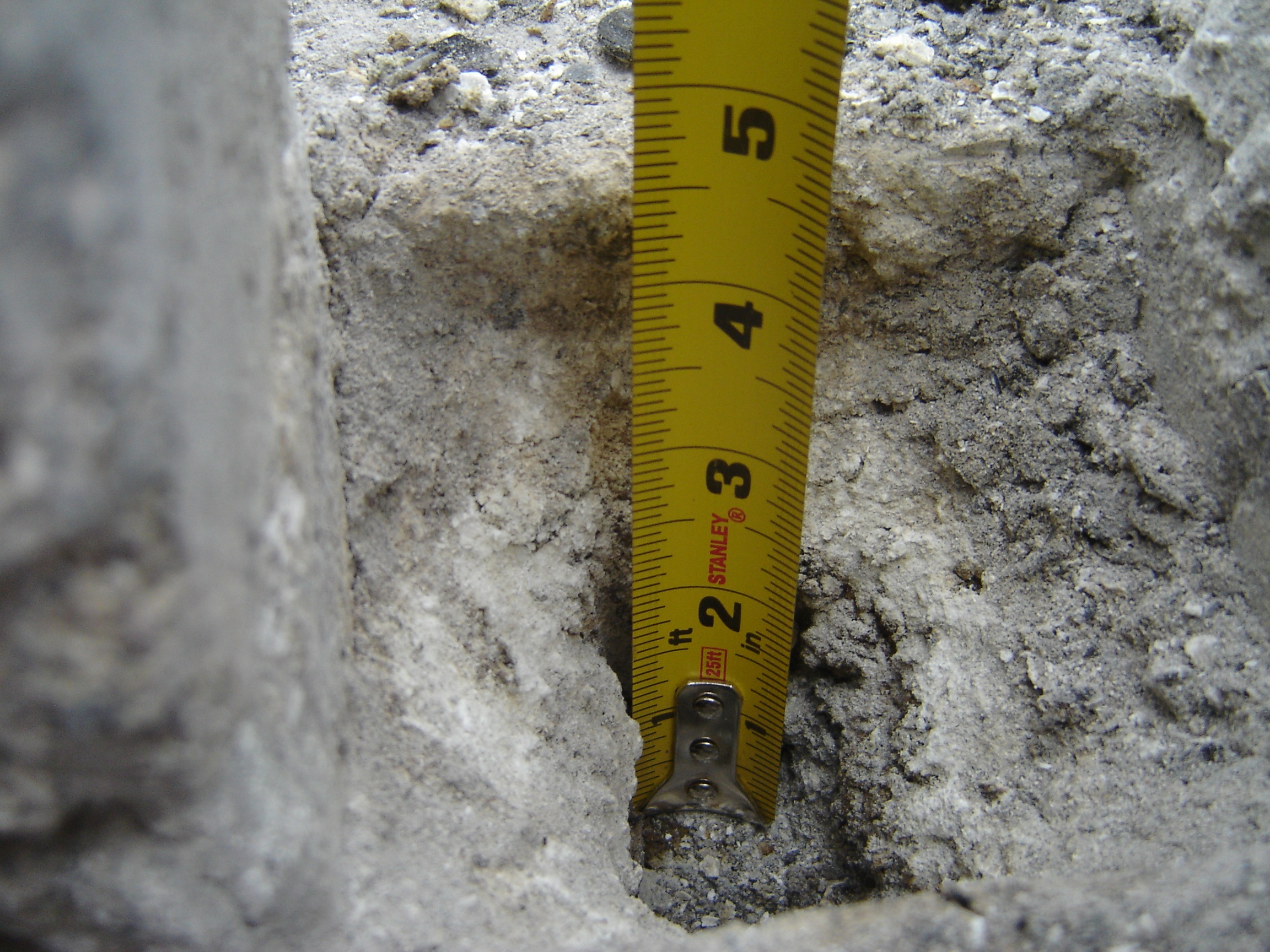

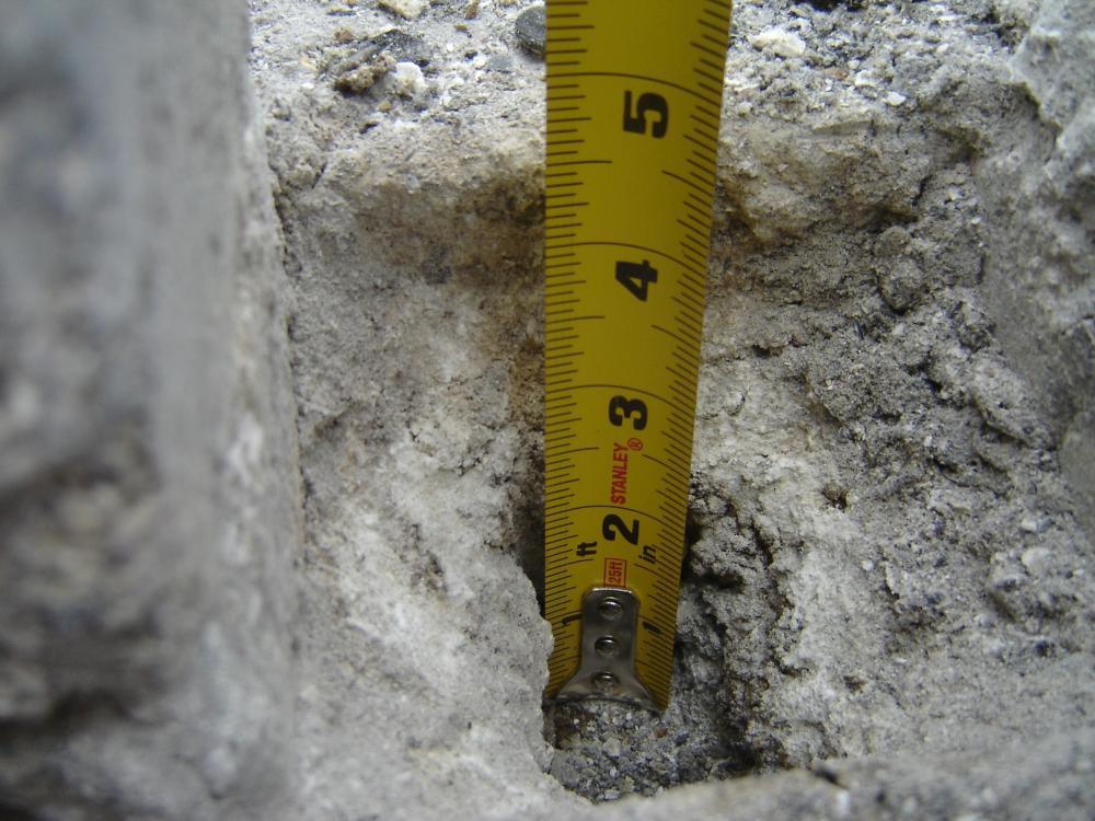

The fire pot depth is slightly more than 4 inches.

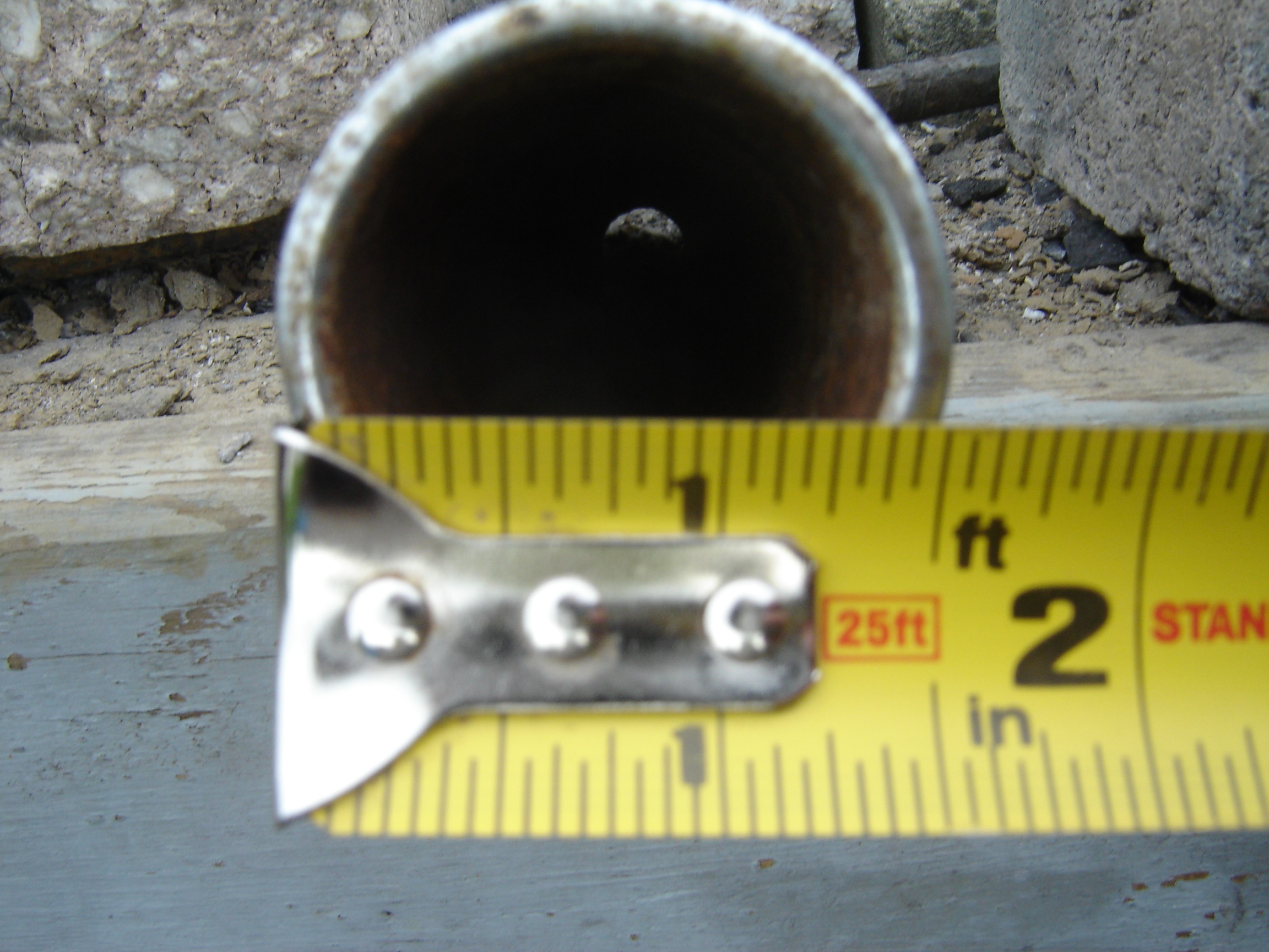

The tuyere diameter in the inside is around 1 and 1/4 inches.

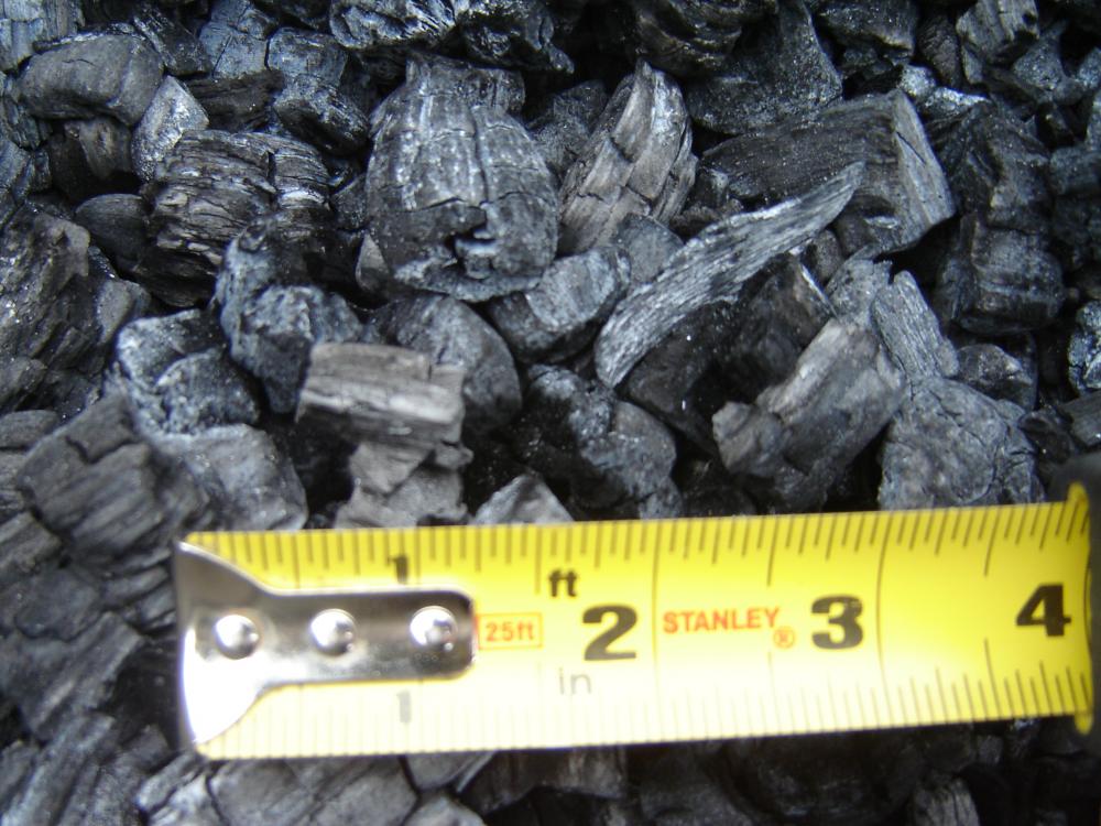

Here is a look of the charcoal I make.

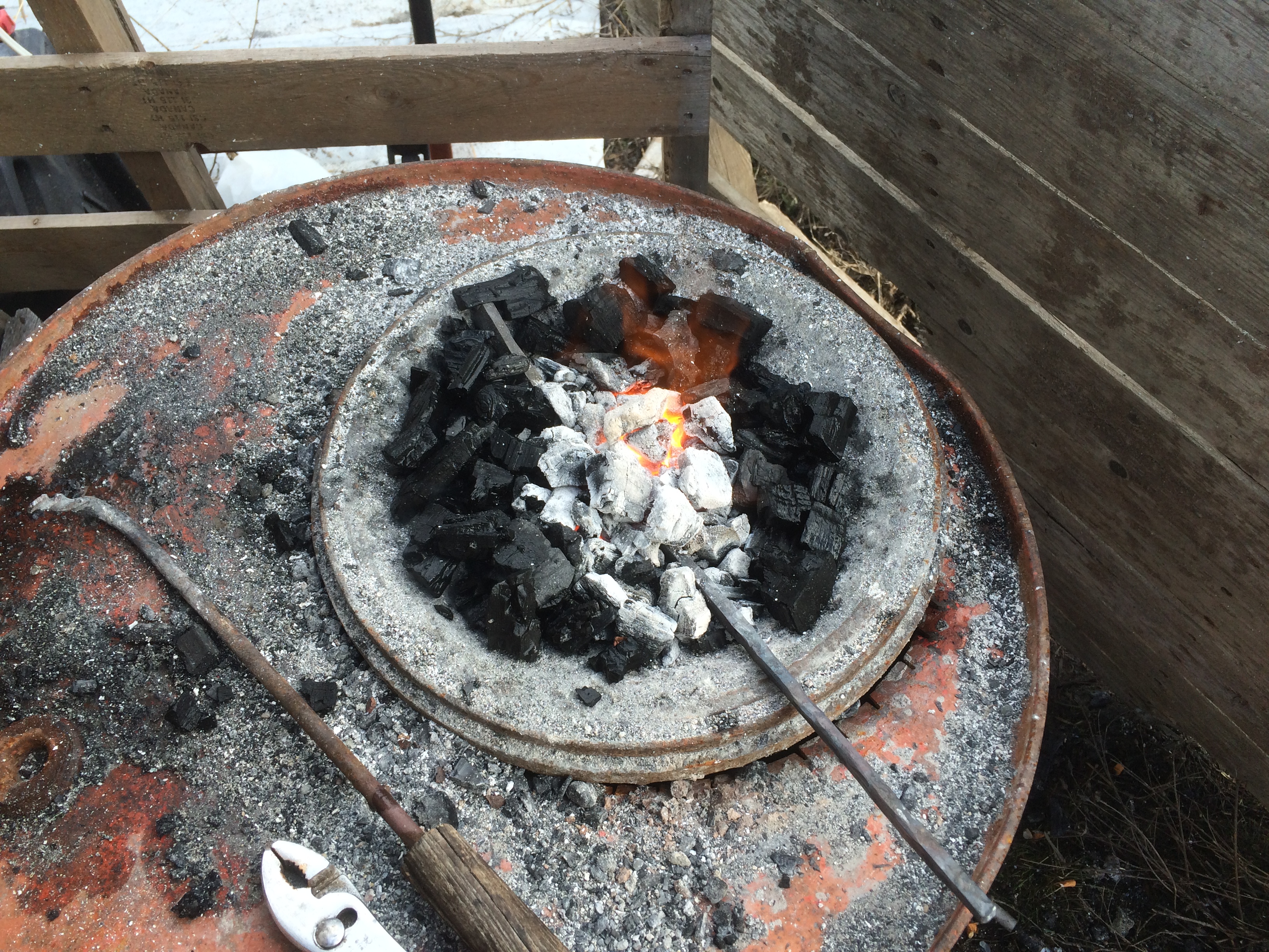

This is my set up. I use 2" pipe. You need high flow/ low pressure for air. I like my charcoal acorn size. Smaller peaces seam to burn fast but put off way more heat.
Hope this helps. Been forging since February

Xavier, have you tried making your firepot taller by placing firebricks around the rim?  Also real slow air will help. You generally want up to 6 inches of charcoal under your piece and several inches over it.  More pictures of your forge would help instead of just close ups.

Your pot is not wide enough at only 4 inches.
Keep the bottom the same size, and widen the top out to say 6 or 7 inches.
Do you have a fire rake or poker? Keep working the pile of charcoal with it, as yes if left as it is, it will burn hollow from the inside, meaning you end up with cooler air blowing on your piece cooling it as much as feeding the fuel around it. Idea is to keep poking the fuel down with the fire rake or poker.
Given you don't have a fine air control - turn your air supply off when not actually heating steel, or you will go through an unbelievable amount of fuel with a charcoal forge.

I agree entirely with that my fire pot should be much wider and I should make a new one.

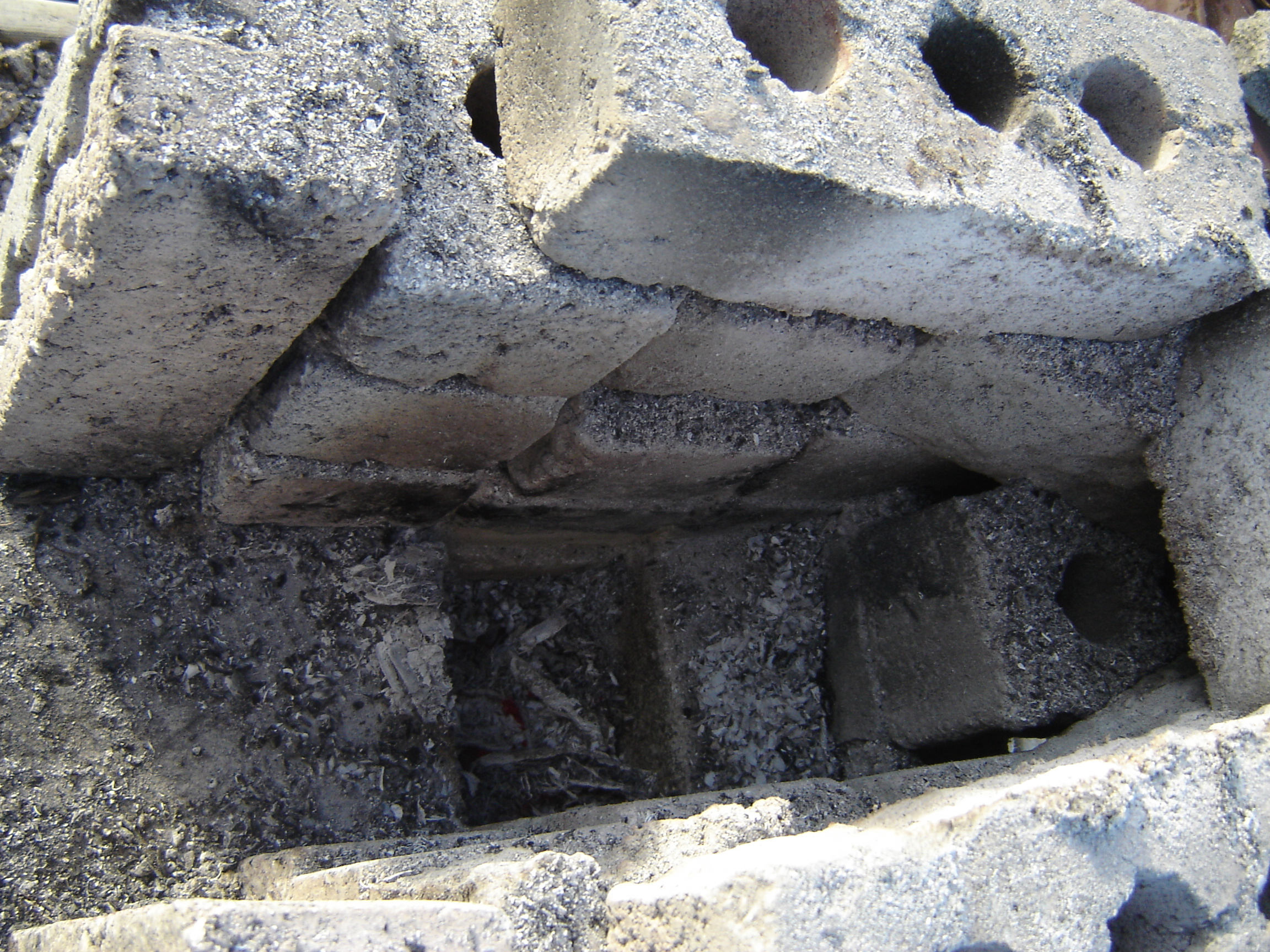

This afternoon, I added one brick slab to increase the height and it did help a little bit.

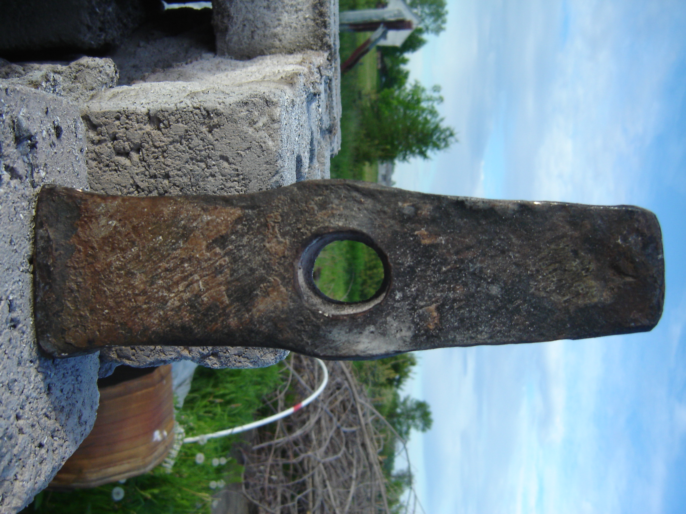

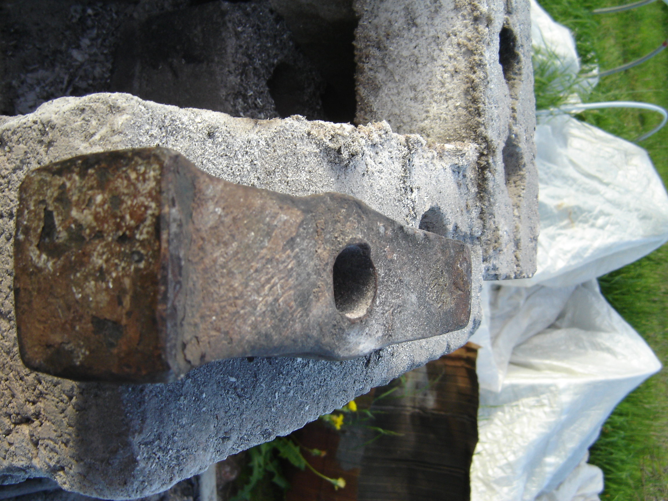

Here are some pictures of the forge after I forged a straight pein hammer.
Between the two pipes, there is a connector I made of sheet metal and rivets to control the airflow by translating it.

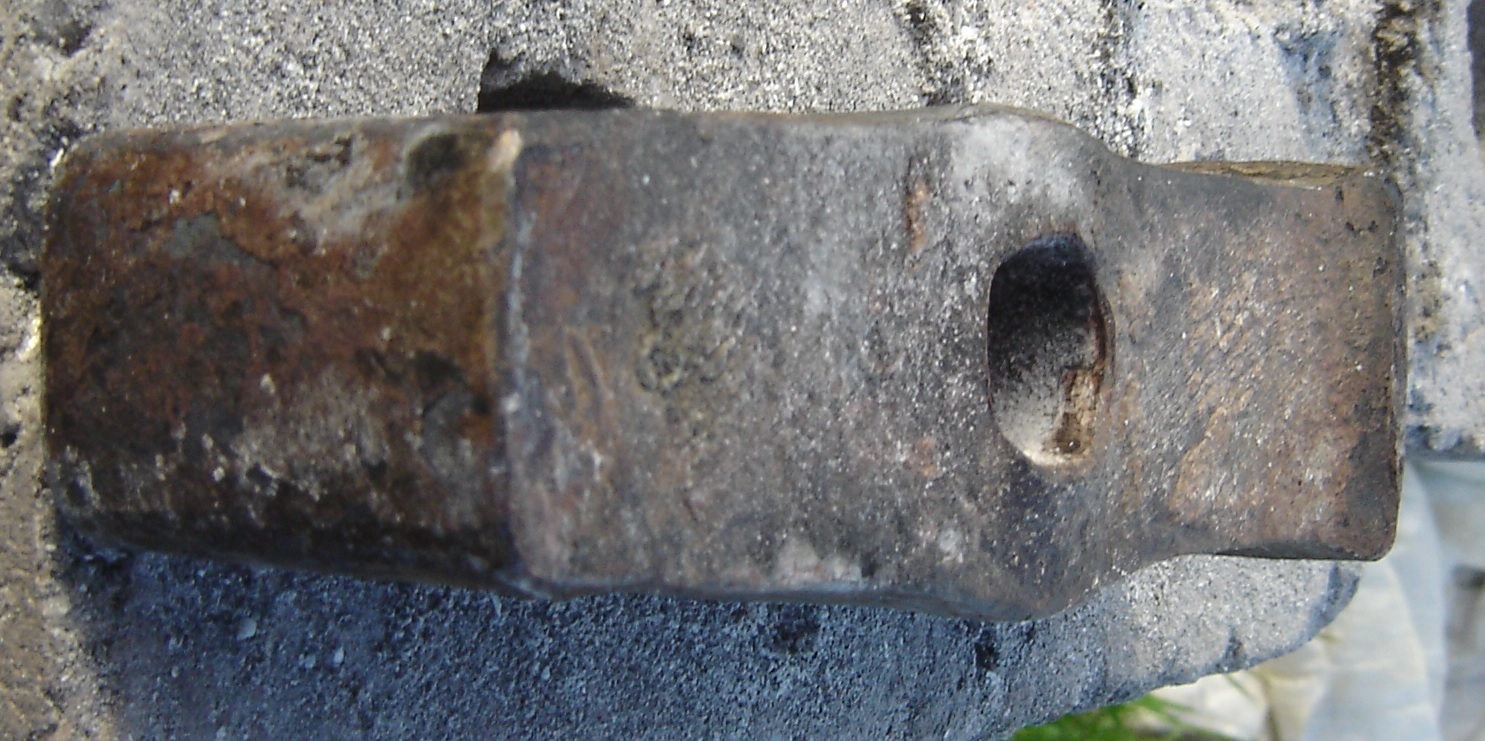

The hammer was made from 32 mm X 140 mm square stock.
Looks  like a crosspeen hammer, in a straight peen hammer the peen is oriented the same way as the hammer eye and in a cross peen hammer the peen is oriented crossways to the hammer eye.

To give you an idea of much charcoal I used the day I forged the straight peen, I burned approximately 100 L of charcoal for 10-11 hours (not consecutive).
The hammer I designed is a straight peen around 2,4 lbs with a very blunt peen to allow me to draw stock more easily. ( It was not clear in the other photos.)
