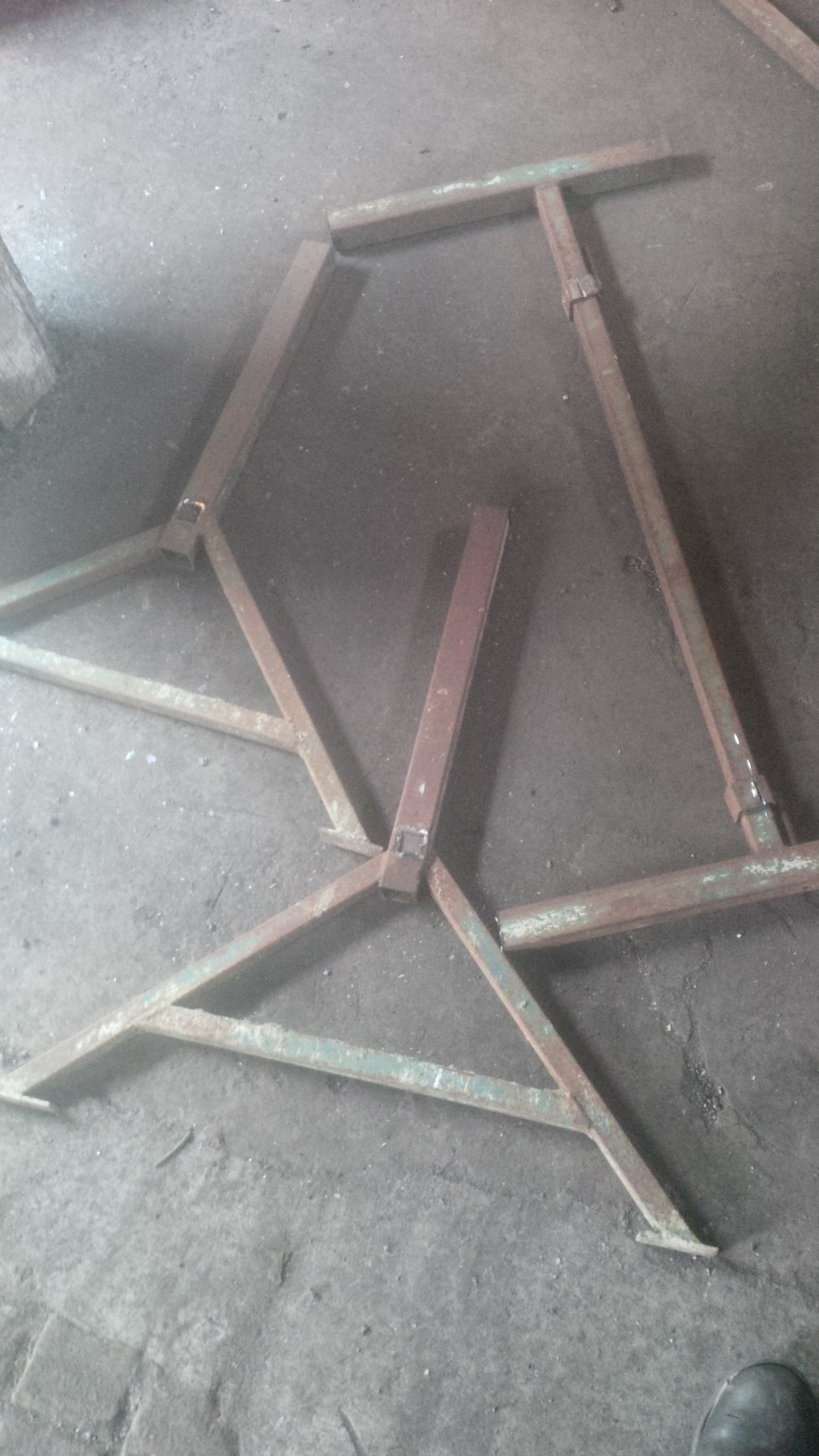

Hephaestus Smith Posted May 14, 2017 Share Posted May 14, 2017 Hi here is a very easy and quick forge table, made from an old builders trestle, step 1 slide out the top bar and put this to the side, this will be the table top. step 2 , cut the upright at the hight you want, i went for 32" now we have the upright and a H piece, Step 3, cut the bar joining the uprights and disregard (this is the only waste also this is often 1" square tube and might fit your hardie) , this will leave you with 2 uprights and a H Step 4, take the piece we slid out on step 1. and cut to required depth of table. i went for about 28" step 5, take the H piece and cut of the longer side of the H, (Keep these safe as they are very important for the final step.) then insert the " not a H any more" piece over and square it up of the front bar. you can weld it or tech screw it. Link to comment Share on other sites More sharing options...
Hephaestus Smith Posted May 14, 2017 Author Share Posted May 14, 2017 Step 6, take the 2 pieces you cut of in step 4 and weld half way along, place on your sheet, and cut around. i used 3mm mild steel but i have used 2mm before. step 7, insert the 2 uprights, stand up, and cut out for your fire pot. Step 8. weld on some edging to suit( and pieces of 100x 5mm around the hole i accidentally cut too big) throw in your fire pot ready for the final step. Link to comment Share on other sites More sharing options...
Hephaestus Smith Posted May 14, 2017 Author Share Posted May 14, 2017 Step 9 . remember the 2 tubes left from step 5? take them and dance around the forge 3 times banging them together singing " whos the man.. im the man"(or woman) i hope this helps some one all the welds can be replaced with tech screws if you dont have welder, and these old builders band stands are 10 a penny (here in Ireland any way) i gave up the construction game nearly a year ago to do this full time. i have a mountain of scaffolding left over and have built my whole shop from it, shelving, bench, cam helve hammer. if any one is in the Tipperary/Kilkenny area and needs any just let me know. Link to comment Share on other sites More sharing options...
JHCC Posted May 15, 2017 Share Posted May 15, 2017 Full marks for creative use of materials! Link to comment Share on other sites More sharing options...
Frosty Posted May 15, 2017 Share Posted May 15, 2017 Looks good. Scrounging material and putting it to use for something else is the blacksmith's way. Well done. Frosty The Lucky. Link to comment Share on other sites More sharing options...
