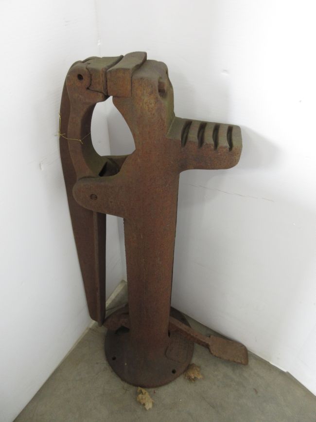

whats the purpose of this type vise ?

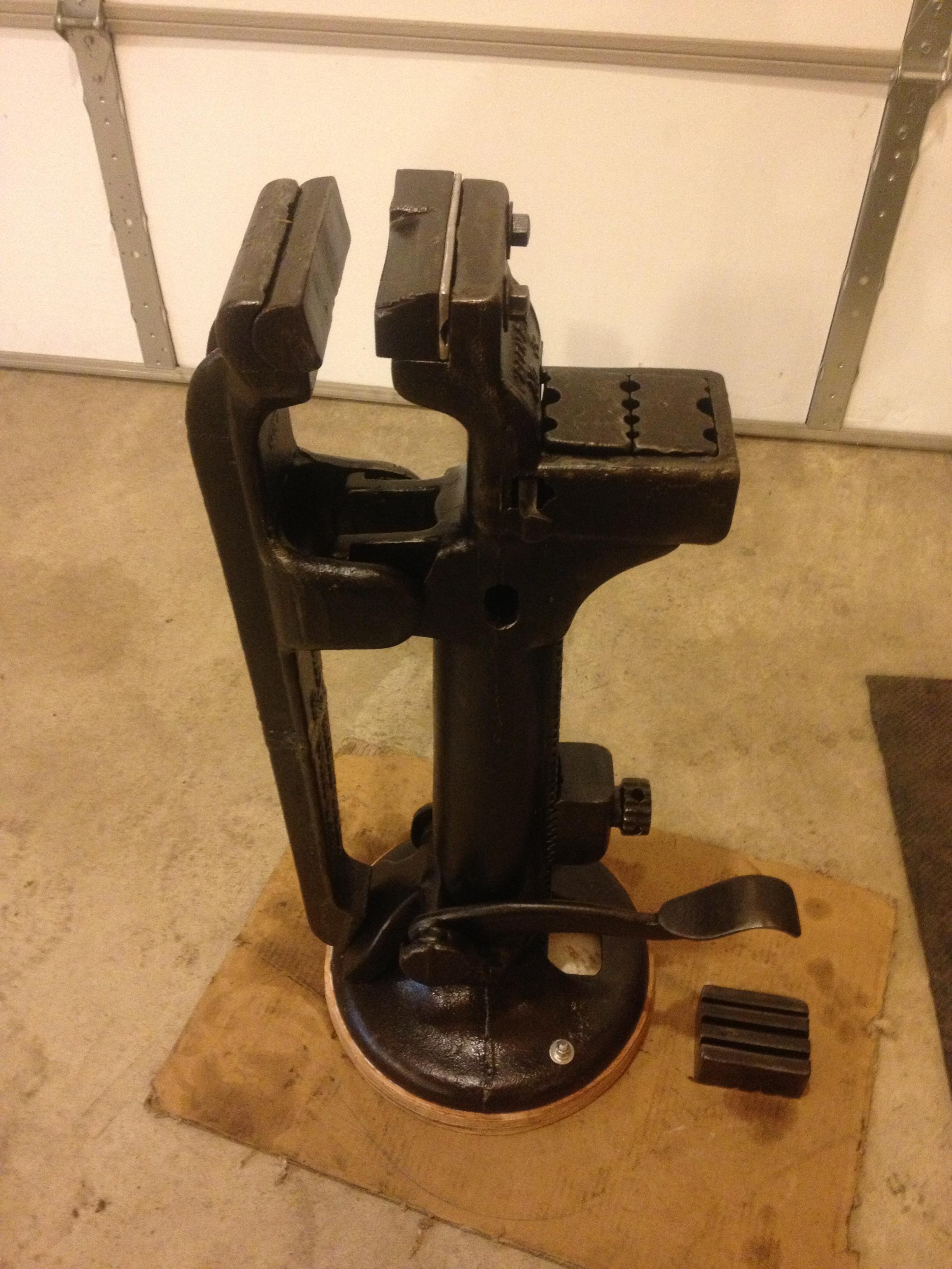

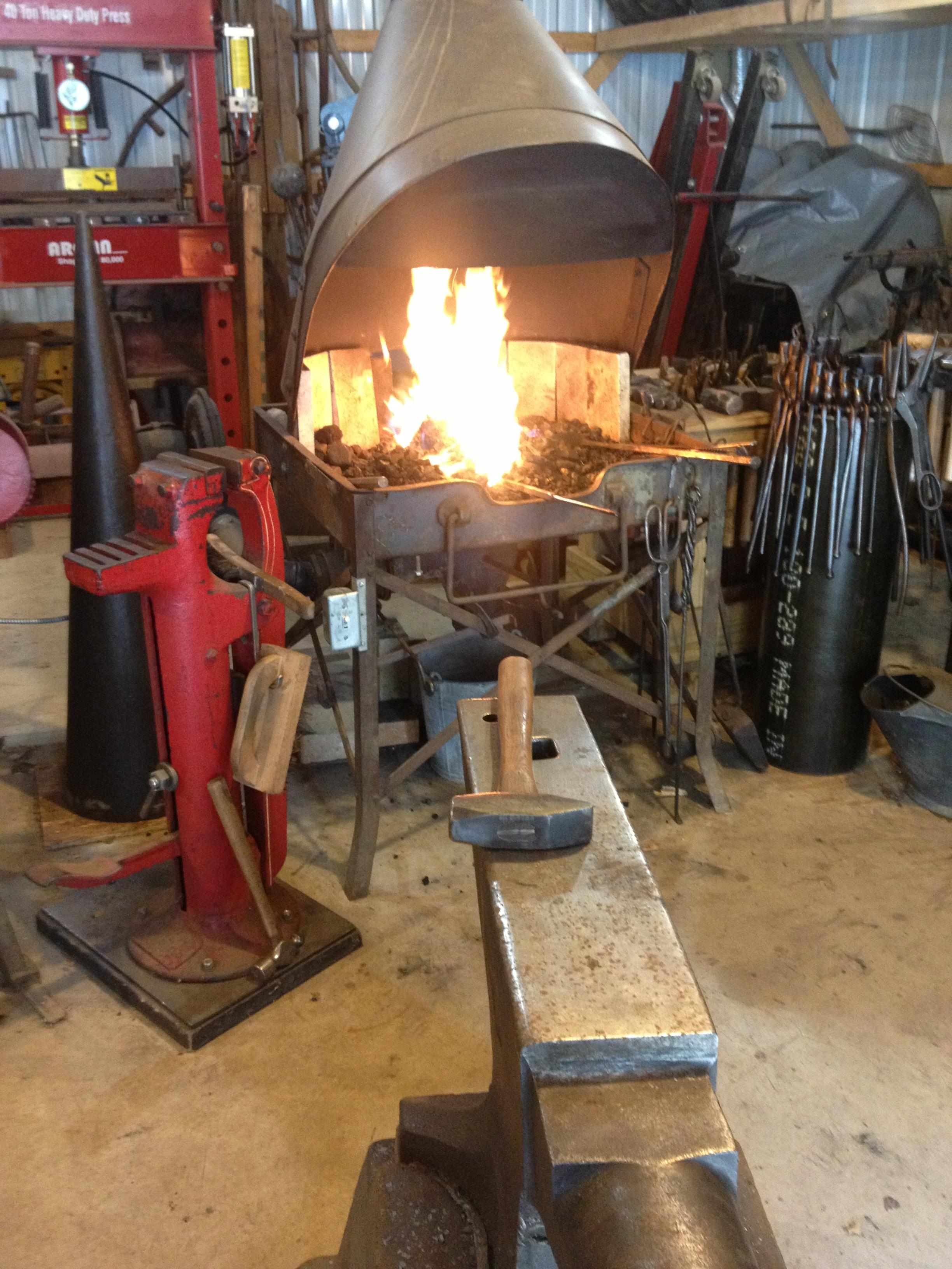

I have *two* of that exact same model..... but I also have a wooden box with pairs of replaceable jaws.... and both vises have adjustable-height upsetting blocks.  Very nice and very useful for repetitive bending and heading/upsetting.  One could also make jigs to fit on the jaws to allow for other quick clamping and bending.  The upsetting block(s) are moved up and down the teeth on the inside of vise, so that if you are bending or upsetting a round or flat bar you use the appropriate jaws, set the distance between the top of the jaws and the upsetting block, heat the irons, sit the bar against the top of the upsetting block, step down on the lever to close the jaws, then bend the bar.... repeat as often as you have bars for the same bend or upset.

       I have a few and use them for various operations at the forge. They are real handy when you want to hold stock for a hard brushing or a quick tweak.  The movable jaw is very usefull for holding tapers and odd shapes. I think a reproduction upsetting block is still available from a firm that makes small swage blocks..
