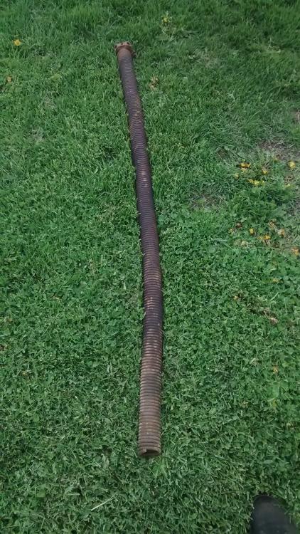

straightened a spring
What I started with and ended up with.
Used some advice I got here and used a fire brick to block off part of my forge opening.
The spring got hot and I was able to pull it straight. The curls at the end are where the flats are. I will cut them off for small tools.
thanks for looking!

Ayup. Did you heat put it over a spindle and pull it straight? You aught to see how long an overhead garage door spring is straightened out.
You can cut leaf & coil spring spring with a hack saw a LOT faster and more easily than heating and straightening.
Frosty the Lucky.

amen to that! after wrestling with several springs to straighten out 8 - 10ft length now i just a cut a curl or two and straighten that. much easier and safer

Yep wanted to try the pull it straight method. Next time will use a band saw or cut off saw.

On the other hand, straightening out a glowing hot garage door spring -- grabbing one end with the tongs and walking away -- is an awful lot of fun.
Doesn't stay hot long enough to walk and I don't run unless chased by something I can't whip. We hooked to the back of a pickup and punched it for about 75'. Only straightened part of it though, too much friction on the rd. steel. bar I used to hold it and it bunched up and rat's nested.
If I do the heat and pull to uncoil method on one of the other roll up door springs I have I'm doing to put a pipe over the rod to act as a bearing. There's  so much length in one of those springs it might need someone holding a rosebud and fork while it's being pulled.

That must have taken awhile! Out of curiosity, what diameter is the stock? Looks like a fairly small, handy size. The smallest coil springs I come across are 5/8", I'd like to run across some 1/2" or 3/8".
2 hours ago, Stephen Jones said:
what kind of length and diameter is a door spring when uncoiled?
The longest piece I've managed to uncoil in a single heat was about twenty-five feet long, and that wasn't even an entire spring. Diameter varies slightly by manufacturer, but generally around 1/4" round.

Full garage door spring. 3/8" material diameter. 2 inch ID. 2xπ= 6.28" per coil. 185 coils. 6.28x185= 1162" (rounded up.) 1162/12= ~97 feet. I also have a smaller one with 115 coils, same ID and stock diameter. Another 60 feet. Collectively almost 160 feet of 3/8" spring steel. And this was just from one garage door being changed.
