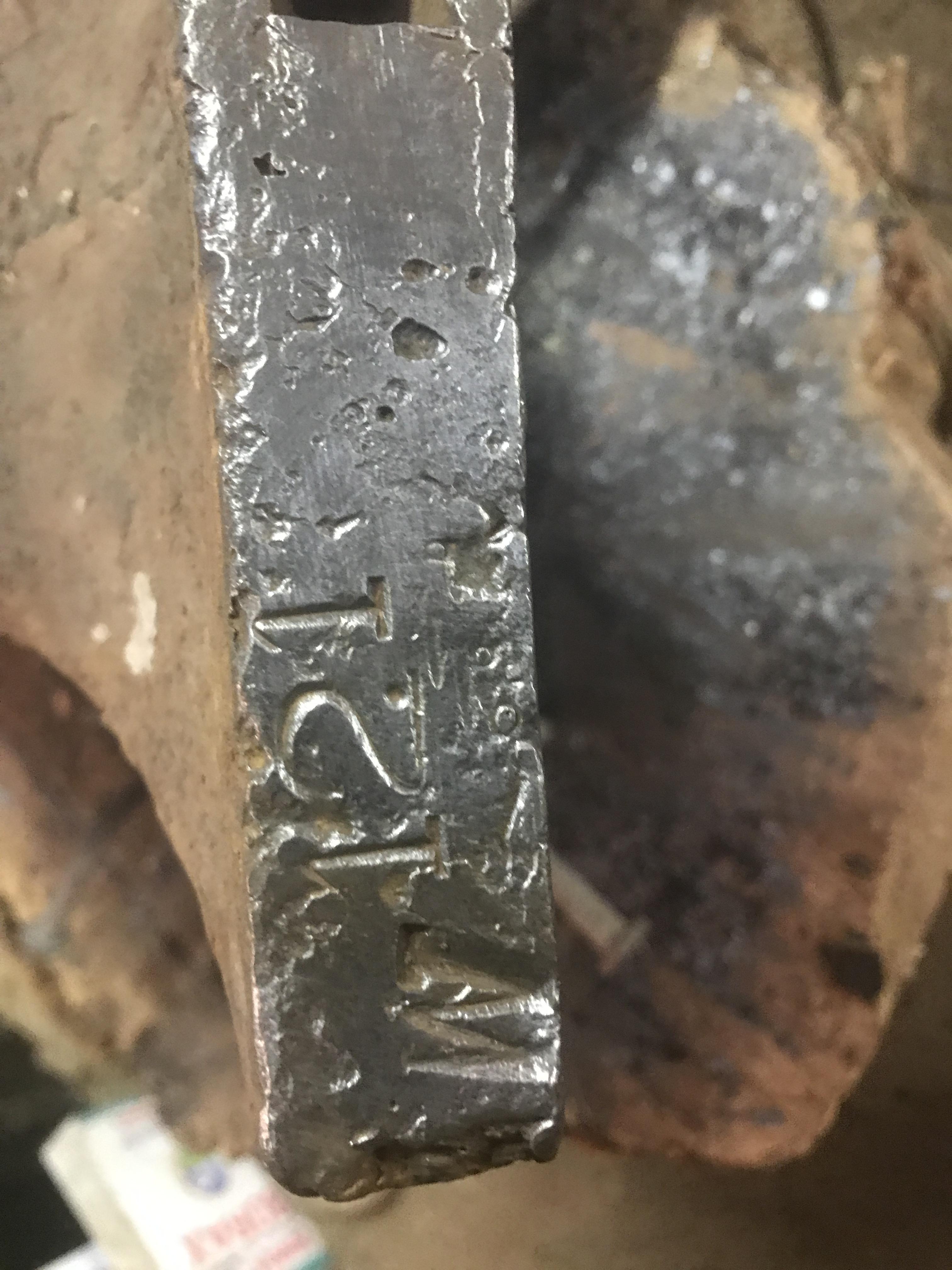

James Schaefer Posted April 29, 2017 Share Posted April 29, 2017 I have a Trenton anvil with the following markings: W121 ?36998 (see pics) can anyone help men with the history and specifics of this anvil. Quote Link to comment Share on other sites More sharing options...
Black Frog Posted April 29, 2017 Share Posted April 29, 2017 A36998 is 1903 per AIA. That is the first style of U.S.-based production stamps. Quote Link to comment Share on other sites More sharing options...
James Schaefer Posted April 29, 2017 Author Share Posted April 29, 2017 Thanks! Quote Link to comment Share on other sites More sharing options...
njanvilman Posted April 29, 2017 Share Posted April 29, 2017 121 indicates the weight in lbs. Quote Link to comment Share on other sites More sharing options...
