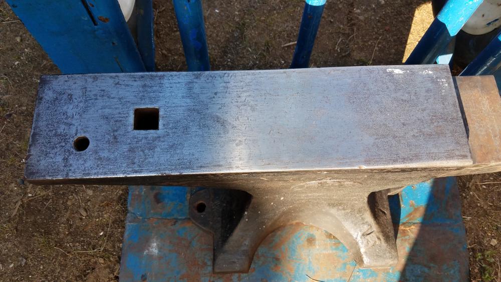

Judson Yaggy Posted May 22, 2017 Share Posted May 22, 2017 Fontanini! More rebound than any forged anvil (or any other type of anvil) I've ever worked on. For the record I've worked professionally on Hay Buddens (several), Fisher, Peddinghaus, Peter Wrights (several), Hill, and Mousehole. Played around on a dozen more types (including JHMs) at hammer ins and at friends shops. The JHMs were good but not great. Full disclosure I've never hammered on any of the Swedish brands or a Refflinghaus which are also considered top shelf brands. Fontanini are cast H-13 tool steel. Beats the pants off a "ductile iron" alloy. Do some careful forging on your family anvil, you probably won't hurt it in any way, and do a bunch more research. Some practical experience as well as some book learning (NOT all on the internet) and hopefully you will make well informed decisions. Quote Link to comment Share on other sites More sharing options...
jlpservicesinc Posted May 22, 2017 Share Posted May 22, 2017 12 hours ago, Judson Yaggy said: Fontanini! More rebound than any forged anvil (or any other type of anvil) I've ever worked on. For the record I've worked professionally on Hay Buddens (several), Fisher, Peddinghaus, Peter Wrights (several), Hill, and Mousehole. Played around on a dozen more types (including JHMs) at hammer ins and at friends shops. The JHMs were good but not great. Full disclosure I've never hammered on any of the Swedish brands or a Refflinghaus which are also considered top shelf brands. Fontanini are cast H-13 tool steel. Beats the pants off a "ductile iron" alloy. Do some careful forging on your family anvil, you probably won't hurt it in any way, and do a bunch more research. Some practical experience as well as some book learning (NOT all on the internet) and hopefully you will make well informed decisions. Judson, It might only be a hair or photo illusion but just to be sure.. That's not a crack is it? Quote Link to comment Share on other sites More sharing options...
Judson Yaggy Posted May 22, 2017 Share Posted May 22, 2017 No, that's where the carbide burr in a die grinder jumped out of the hardy hole and walked across the face. The hole came sharper than I wanted and the face is too hard to cut with even a brand new quality file so I had to die grind a radius into the holes. Operator error, it got away from me for a moment. Quote Link to comment Share on other sites More sharing options...
jlpservicesinc Posted May 22, 2017 Share Posted May 22, 2017 Phew. What a relief.. I've seen a few anvil with hardie hole cracks but never on one with a double horn and hardie on the horn end... Very robust design.. Quote Link to comment Share on other sites More sharing options...
