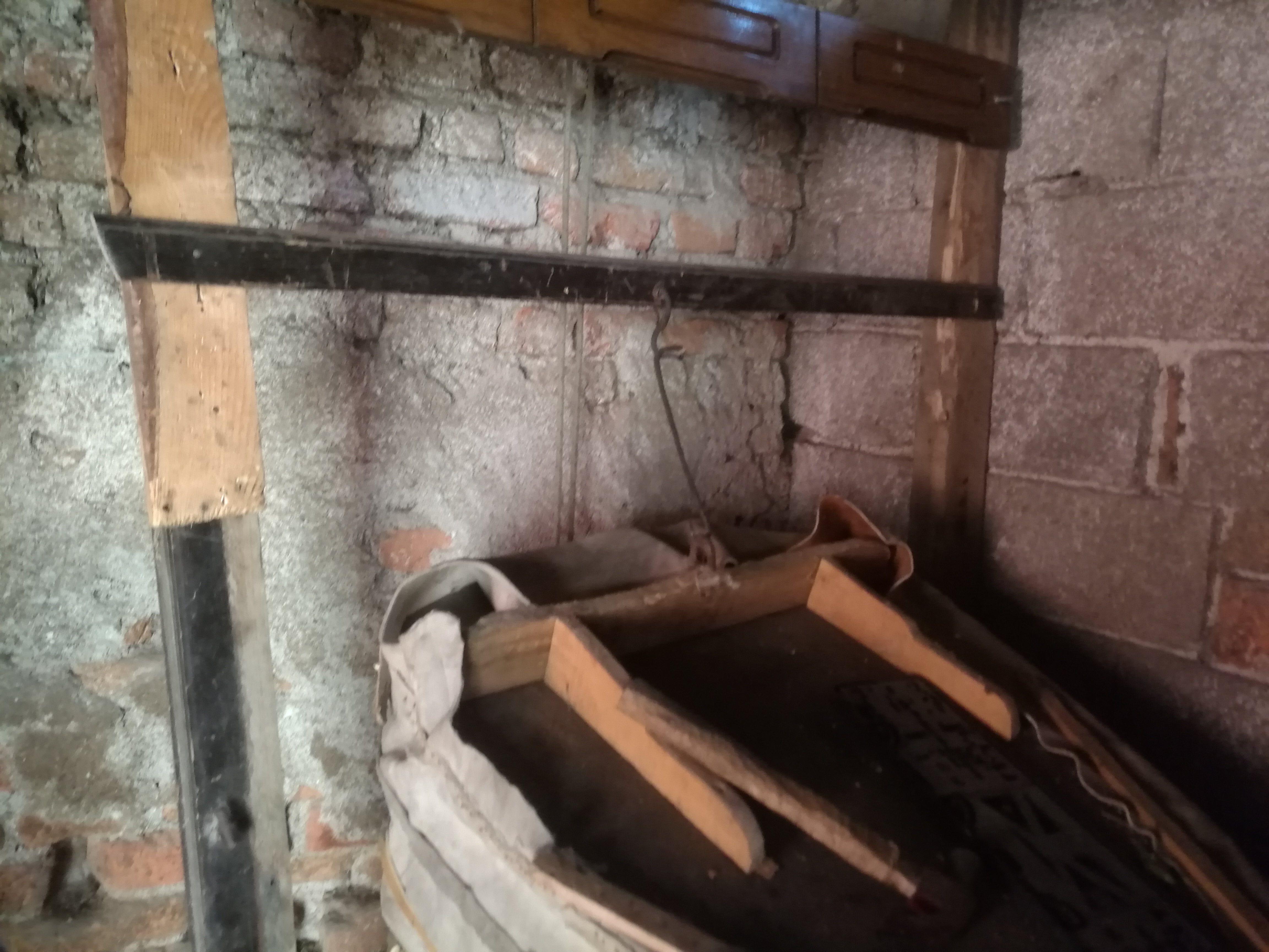

As I saw new thread I will post question here

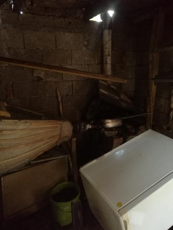

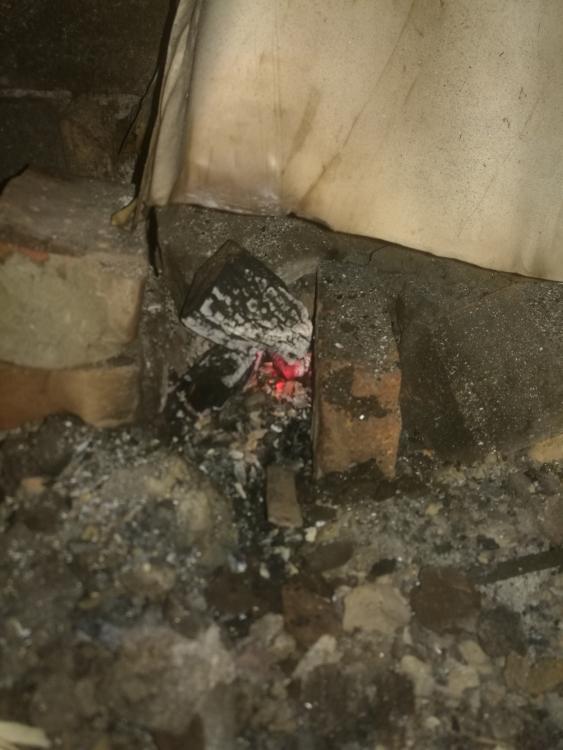

I have same problem here, higher velocity air blow out the fuel.
With smaller bellows and longer pipe I didnt had that problem.
I was thinking will longer pipe minimise air preassure. I thing I will raise mh bellows and put longer pipe
What do you mean exactly ?
Well they will blow blast at upper stroke.
I was thinking if I made pipe 3 foot long bend and make two knees that I will minimise that preassure by creating bigger distance between bellows and forge.
Edit: I get it now that could work tying some weight and making fulcrum at top frame that will lift top board. I need to give it a try
Make the weight adjustable and you can get different speeds from the system---the inverse of tossing a hammer on the top board to make it blow harder.

Well diametar is about two inches and it is narrowed to one inhes at end where tuyere meet fuel.
I cant put valve because I dont have weldor to weld it  I should drill pipe make weld some metal on rod and than where is hole to put that rod .
But I dont have material for that even if I did that there is realy small room.
Bellows are apart from forge like 10 inches or less.
Thomas has the right idea.
You prolly know this so consider it for others. You want volume not velocity.
Assuming yout top leaf falls and you lift for the return stroke, you need to control the speed of drop.
A rope attached to the top leaf going thru a pully attached to the ceiling gives you an adjustable way of controling drop. That should be all you need.
If you still have too much volume than Thomas still has the correct solution.
To add to the above, then use a the gate to vent air to the outside.
Example/ make your slide say half inch wide and cut the end on a diagional. Then the farther out you pull the slide, the larger the vent opening to the outside. The thickness i gave is just an example.

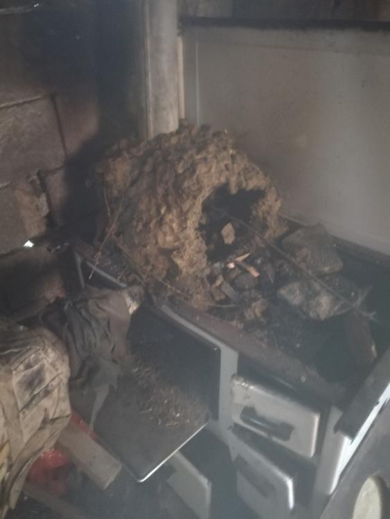

Iam using charcoal for fuel and.this thing tend to.escape I mix it a litle bit with lignite so.it is packed.
Generaly I wont need bigger forge for swords etc, narrow hearth is what I saw in practical blacksmithing book too.
I think this should work fine. Just you have to use poker a litle bit so you can pack.your fuel.
I've noticed loose fuel can sometimes be a problem. I made a flat tool that fits in my trench to pack the charcoal down a bit. I've sat a brick on top of the fuel before too. I prefer packing it though.
Let us know how it works after a few fires.

I for now on made two hooks for.bellows.
I will see if I will need to heat and bend pipe so.I can raise bellows and make one knee and than another kne so they will be like this.
But that is huge step and risky to do.
Something like this, this way if pipe is longer I guess preassure is lower but I wont consider it now.
