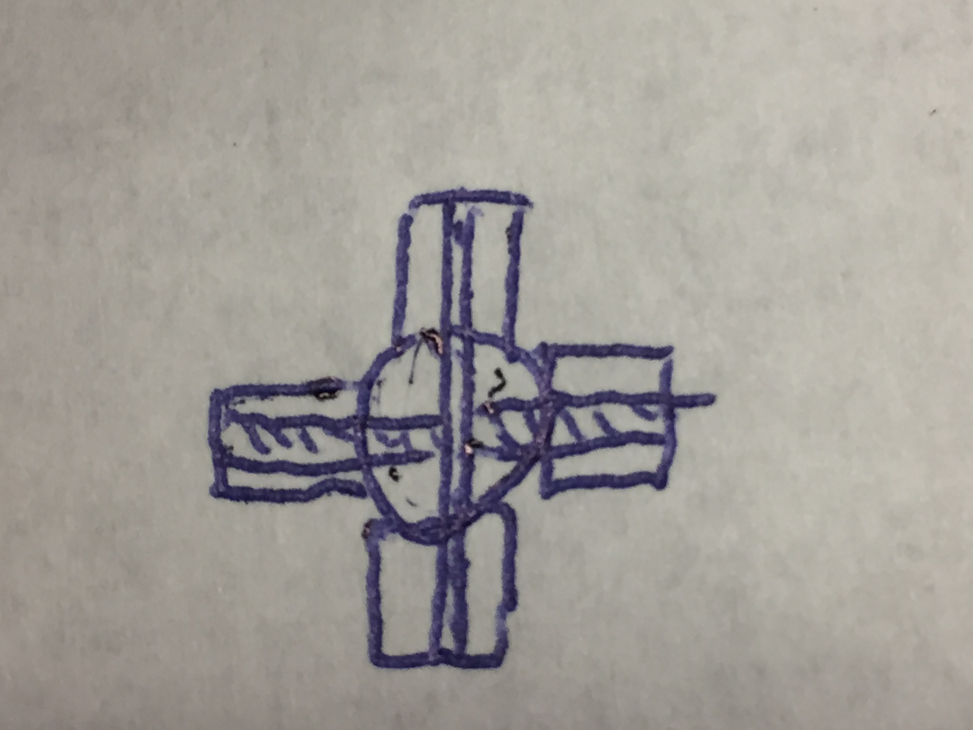

Here's what I would do if this were mine: Make a stand that integrates a platform to stand on with vertical pieces of 4x4 to hold the steel upright. You can use those holes to bolt the 4x4s to the steel, like this:

Here's what I would do if this were mine: Make a stand that integrates a platform to stand on with vertical pieces of 4x4 to hold the steel upright. You can use those holes to bolt the 4x4s to the steel, like this:If you keep that upper hole, you can use it to mount additional tooling.

If you're using a chunk of round steel on its side with a round hole pointing up and down, you have three options:
1. Live with it.
2. File the hole square.
3. Have a round shank, but hammer a concave shoulder on the underside of your tool, thus:
