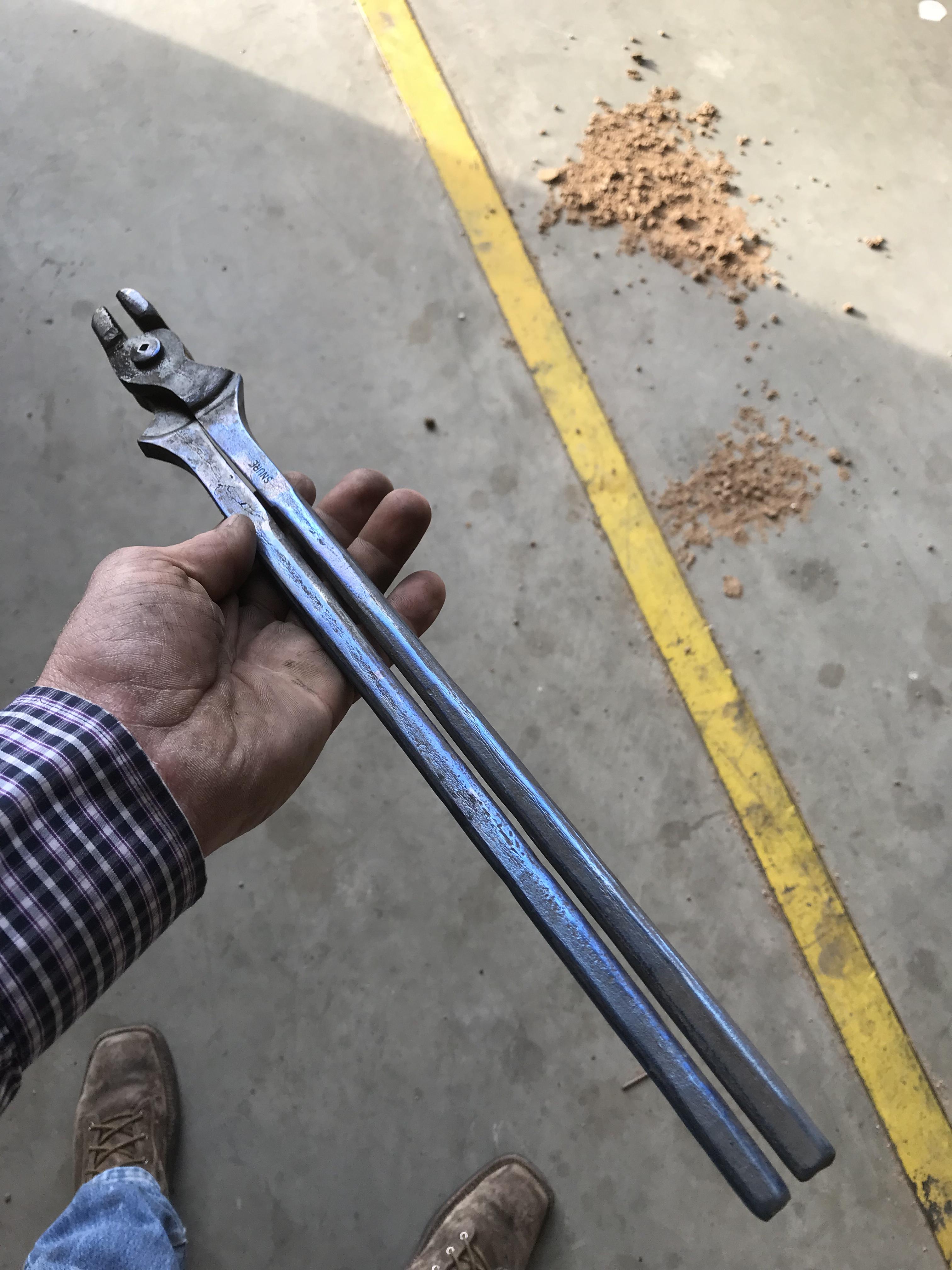

Ranchmanben Posted December 23, 2018 Author Share Posted December 23, 2018 That’s what I figured but wasn’t sure. I’m not positive what alloy it is but I suspect it’s 6Al-4V. Quote Link to comment Share on other sites More sharing options...
jlpservicesinc Posted December 23, 2018 Share Posted December 23, 2018 Thanks.. scrap had hanging around or ordered it special? Quote Link to comment Share on other sites More sharing options...
Ranchmanben Posted December 23, 2018 Author Share Posted December 23, 2018 I was given a 4’ bar by a friend. He said it had been passed around to a few different shops but no one knew what to do with it. Other than tongs, I’m not really sure what would be a good use for it. Quote Link to comment Share on other sites More sharing options...
Ranchmanben Posted December 23, 2018 Author Share Posted December 23, 2018 2 hours ago, jlpservicesinc said: Thanks.. scrap had hanging around or ordered it special? Here’s a picture of them before I was done forging them to show the scale color. Quote Link to comment Share on other sites More sharing options...
jlpservicesinc Posted December 24, 2018 Share Posted December 24, 2018 HUh, interesting.. I have a bar that I am or planned to make a pry bar out of.. I'll have to check it out.. The last Ti I forged turned black and it looked more like anodizing on alum then orange.. Interesting indeed.. Thanks Ben.. Quote Link to comment Share on other sites More sharing options...
Ranchmanben Posted December 24, 2018 Author Share Posted December 24, 2018 On 12/23/2018 at 7:18 PM, jlpservicesinc said: The ti I forged before this definitely was 6al-4v and it had the same color scale. That’s why I think it’s the same grade. Quote Link to comment Share on other sites More sharing options...
ThomasPowers Posted December 27, 2018 Share Posted December 27, 2018 Polish the reins up a bit and then anodize them to the wild Ti colours! Quote Link to comment Share on other sites More sharing options...
Ranchmanben Posted December 27, 2018 Author Share Posted December 27, 2018 On 12/27/2018 at 12:35 AM, ThomasPowers said: I actually did do it but I didn’t like how splotchy it looked where the ti wasn’t really clean. I tried it again after using the wire wheel and it looked even worse. Did the wire wheel again and called it quits. Here’s what they looked like blue/purple. Quote Link to comment Share on other sites More sharing options...
jlpservicesinc Posted December 27, 2018 Share Posted December 27, 2018 What kind of wire wheel are you using? From what I understand only a stainless steel brush should be used.. Quote Link to comment Share on other sites More sharing options...
Ranchmanben Posted December 28, 2018 Author Share Posted December 28, 2018 Hmmm. I used a plain twisted wire wheel. That must have been the problem. Quote Link to comment Share on other sites More sharing options...
