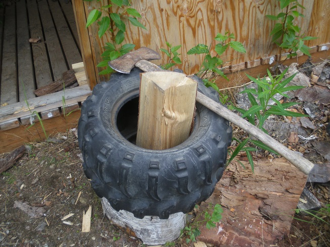

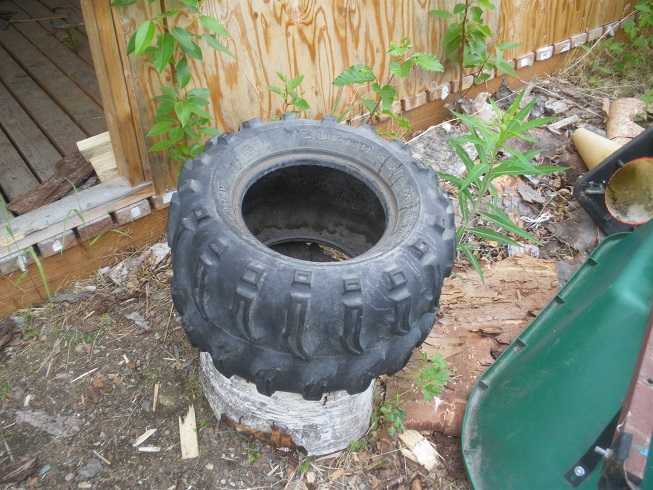

Frosty Posted June 7, 2017 Share Posted June 7, 2017 About splitting kindling. Any of you who have will know what it's like holding a piece that won't stand on it's own while you hit it with a hatchet or axe. And then when you get it split you get to go pick up the pieces some go quite a ways and hide under the snow or thorn bushes. Black eyes, picking thorns, hopefully NEVER having to ask the better half to help stop the bleeding. With me so far? A couple winters ago a friend on another forum posted a link to a guy who had a decent idea. He'd driven three stakes in his copping block and would hold the piece being split with a bungee. It worked a treat, it holds the wood so you don't need to get near it and keeps the splits contained. I like the idea but a lot of hassle. This spring I remembered to ask the guys at the tire shop for a junk ATV tire. They're happy to find someone to take the things, they have to pay to dispose of them. So, one fat wheeler tire, a couple long wood screws and no more holding, chasing or worrying about missing and sticking an axe in my foot, leg, etc. 7 whacks with the double bit shown, knot and all. Please note the black skid marks on the sidewall, those were misses from earlier. The tire just stops the axe without damaging it. You literally have to TRY to make the axe glance, the rubber grabs the edge. Frosty The Lucky. Quote Link to comment Share on other sites More sharing options...

Frosty Posted June 7, 2017 Share Posted June 7, 2017 1 hour ago, Tubalcain2 said: i have a big hot cut that i use in my shop to split kindling. i put the end grain of the log on it and hit the top of the log with a hammer. works wonders on small stuff. Heh, heh, heh. You aren't the first smith to bring a hardy in by the stove, yes it works a treat and is a lot safer than using a hatchet or axe. My only concern was keeping it out of the way so nobody could fall on it, laid it on it's side and under the stove. Well, it isn't really a hardy, more of a tall anvil devil. Frosty The Lucky. Quote Link to comment Share on other sites More sharing options...
