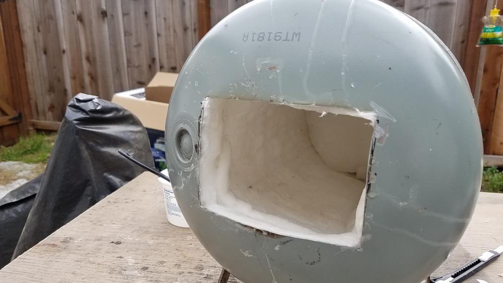

Melw45 Posted March 23, 2017 Share Posted March 23, 2017 I want to build a forge. I do have some parts to start with. The attached photo is of where I am starting. Some years ago I made the burner for a aluminum foundry. It is a Reil's EZ-Burner. Found here, http://ronreil.abana.org/ezburner.shtml It worked well for me then. My first thought was to use the DIY cast-able refractory that I used for the aluminum foundry. It was from a recipe from John Wasser. I found from reading here and elsewhere that the Perlite will brake down at forging temperature. So after making some measurements and looking for local suppliers I have decided to use, Inswool Ceramic Fiber Blanket, faced with rigidizer, and for the floor, split hard brick I would also like a gauge for the regulator but have not found one yet. So any pointers for that would help. Fell free to point out any problems. Thanks! Mel Edited Link to comment Share on other sites More sharing options...

Melw45 Posted March 30, 2017 Author Share Posted March 30, 2017 I have made some progress over the last few days. I went to the local ceramic suppler and bought the inswool, rigidizer and split firebrick. No refractory cement out of stock. Now for the pics. Here you can see the forge body set on the legs I bent up. They will be bolted to the body. I don't have a welder here. I still need to come up with a work shelf of some type. I also built a anvil stand I will show in the appropriate sub forum. Thanks for looking. Mel Link to comment Share on other sites More sharing options...

Melw45 Posted April 5, 2017 Author Share Posted April 5, 2017 Made some progress on this today. Mounted the feet and burner holder. Firs I had to make the burner holder. Made it from a conduit coupler. Had to drill and tap it for the bolts. The burner hole was cut with a hole saw. The problem I had was of all the saws I had none were the correct size. Used the closest that was not too big and Dremeld the rest of the way. See the photos. Thanks for looking! Mel Link to comment Share on other sites More sharing options...
Melw45 Posted April 6, 2017 Author Share Posted April 6, 2017 Dang getting the Inswool in there was kind of a pain. Waiting for the Rigidizer to dry. Tomorrow will be completing the burner. Thanks for looking. Mel Link to comment Share on other sites More sharing options...
