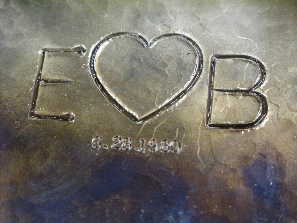

VaughnT Posted March 24, 2018 Author Share Posted March 24, 2018 On 3/16/2018 at 12:02 AM, Howling dog forge said: I am wondering if you could do the chisel work and then do the scroll. John's spot on the money. You can get away with reversing the order of operations if the work is large enough and the carved lines are deep enough into the field, but that's a rare combo to find. Generally speaking, the piece doesn't look right if you reverse things because the carved lines are never a consistent distance from the edge. Or, you spend a gob of time filing the perimeter to try and get things spaced right so they look right. Reminds me, I need to make up a new set of chisels. The 1070 alloy was pretty easy to work with, but this 1095 I'm using now is really wearing things down quickly! Quote Link to comment Share on other sites More sharing options...

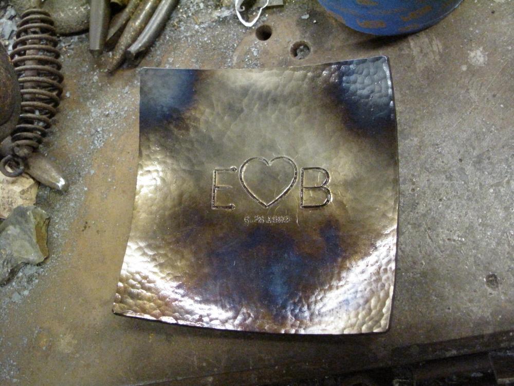

VaughnT Posted June 25, 2018 Author Share Posted June 25, 2018 My nephew wanted to make something for his girlfriend, so I offered to show him how to do the chasing. I already had the dish mostly formed, so all he needed to do was give it the texture, draw up the design, cut it into the steel and put on the finish. He did amazing, in my opinion, and really concentrated on the tasks once I showed him how to do things. Just goes to prove that guys haven't changed in millions of years -- if there's a chic needing impressed, we can hunker down and get things done! Quote Link to comment Share on other sites More sharing options...
Frosty Posted June 25, 2018 Share Posted June 25, 2018 If the girl isn't impressed with that work he needs to find a more worthy girl. That's a fine job. Tell him Frosty says well done! Frosty The Lucky. Quote Link to comment Share on other sites More sharing options...

VaughnT Posted June 27, 2018 Author Share Posted June 27, 2018 Thank you, gents. He might never decide to work with his hands, but at least he has a story to tell. I thought the best part was when I asked him if he wanted me to go over it and clean up the lines to smooth it all out. "No thank you. I'd like to do it all myself so I can honestly tell her I did it myself." The only time he asked me to step in was on the date, and only because he'd screwed up the initials. He couldn't get squared away because the surface was uneven, so he asked me to take the helm just so he wouldn't double-stamp again and make things worse. As the wise Mr. Eastwood said, "A man's gotta know his limitations!" Quote Link to comment Share on other sites More sharing options...

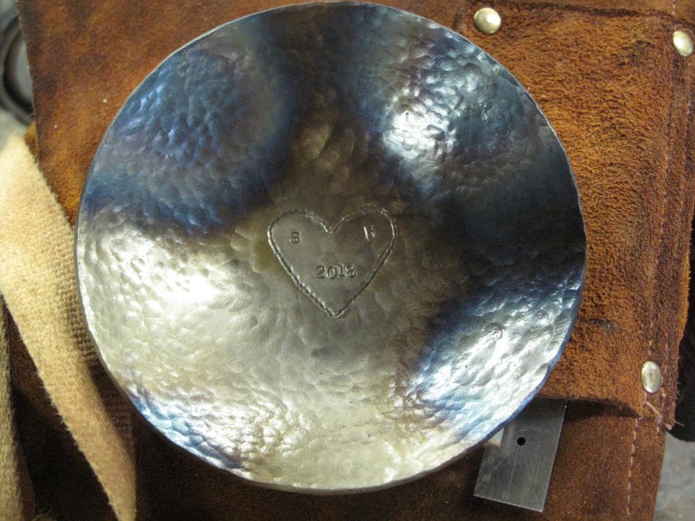

VaughnT Posted December 12, 2018 Author Share Posted December 12, 2018 Thanks Duck. Got to do some chasing on a dish the other day. Sadly, when I was stamping in the date, the #1 stamp flew off to parts unknown. Now I have to hunt down either a single stamp... or buy another set. I was thinking about going up to 3/16" numbers rather than the 1/8" that I currently use. Not sure if that'd be a good idea or not, but... Quote Link to comment Share on other sites More sharing options...
