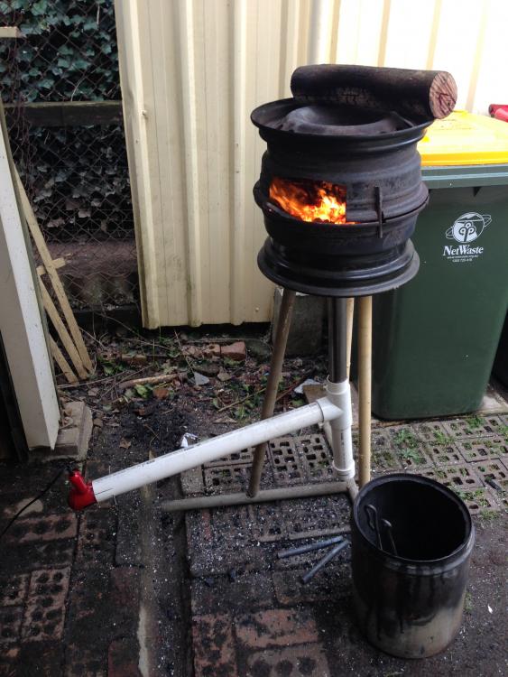

PapaDooks Posted March 15, 2017 Author Share Posted March 15, 2017 yeah this was last years start up forge. like i said i'm looking at making something a bit more permanent for in the shed and can get the iron hotter and more consistant but this bad boy got me started up and most expensive part was the hair dryer Quote Link to comment Share on other sites More sharing options...

PapaDooks Posted March 16, 2017 Author Share Posted March 16, 2017 yeah this worked well to learn about bashing iron a bit and make some really dodgey looking tongs up but i want something a bit more advanced now. am going to order the steel for it next week Quote Link to comment Share on other sites More sharing options...
