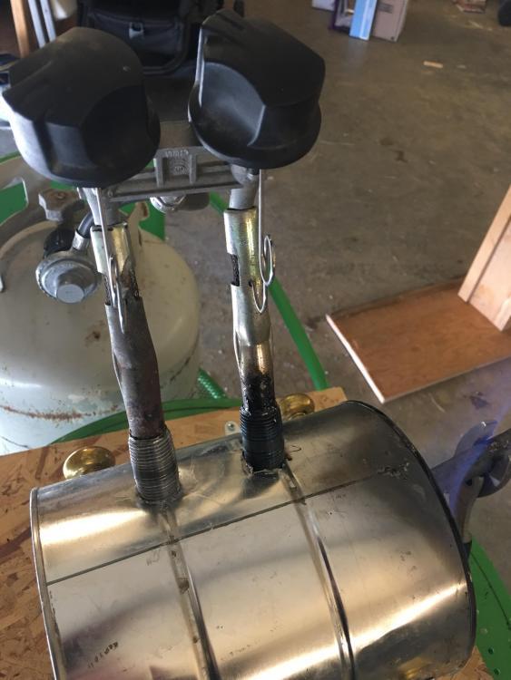

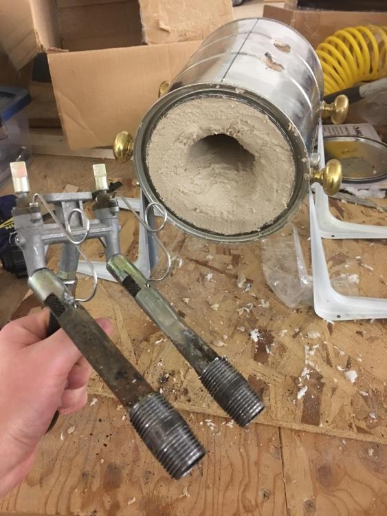

I have just finished laying the refractory cement in my paint can forge, and it is now sitting out to dry for the night. So far I am only $51 in to this forge: $27 24"X12"X1" Ceramic wool from Amazon, $21 Refractory Cement from Amazon, $4 1/2" black steel nipples, and $1 for BBQ burner.
Originally I was going to use a Benzomatic burner which would have cost me around $20, plus those little camp BBQ propane tanks which in town are about $3.50. That was the plan till I went scrapping with my buddy who is teaching me how to blacksmith and we came across a BBQ that was still in good condition. So I grabbed the hose and burner from it as well as some spring steel all for $1. We figured "hey, it's a burner, I can get two jets out of it, and it has all the necessary requirements (propane nozzle, a place for air to be induced, and a tube that can withstand heat)... Why not?!"
As you can see from the video below it actually works pretty darn well! We shall see how it works tomorrow!

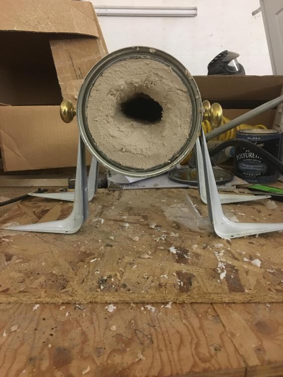

I think you need to need to tie the legs together crossways. The single attachment point at the top of the angle brackets is thin right there and easily bent and you don't want it to fold over while in use and go rolling off the bench, table, stand, whatever. I can guarantee with some degree of certainty it'll find the one pocket of flammable materials to roll into. It doesn't need to be anything fancy, screw it down to a piece of plywood would be excellent overkill but just something to tie them together will make a big difference.

Thanks Frosty! I just had them loose so I could get the wool and cement in. When everything is finished it will be mounted on a portable fire proof base.
Haha the door knobs were from spare cupboards and I didn't have a set of 4 nuts and bolts, but the knobs ended up working perfectly!

So I have a few concerns with this build. The first is the amount of flame that is flaring out of the opening (I only have an opening at the front). It comes out enough that it licks the air holes on the front tube. So because of that I don't use the front burner since that sends up a red flag for me. I will make note that the hole where the front burner goes in is not as snug as I would like as I had some metal jump on me when I drilled it.
I am also not getting the heat that I need in order to move metal, and that is with both burners on full (had a makeshift shield on the front for a bit but it kept falling off). Would anyone have any suggestions?
I have noticed too that my mortar has bulged after having the forge on, so my original semicircle design has become a grotesque oval, almost tight butt hole like.
Third picture has both burners on full.
The other thing I am thinking I may have to do is remove the BBQ regulator on the hose and replace it with just a hose extension and bottle hook up.
Yeah, that's about what I'd expect from a BBQ burner. They're not designed to make a really HOT flame, they're designed to supply a good air fuel mix to a ribbon burner under lava rock gravel. The gravel heats to the point it will grill food and the dripping grease and juices make it taste good.
