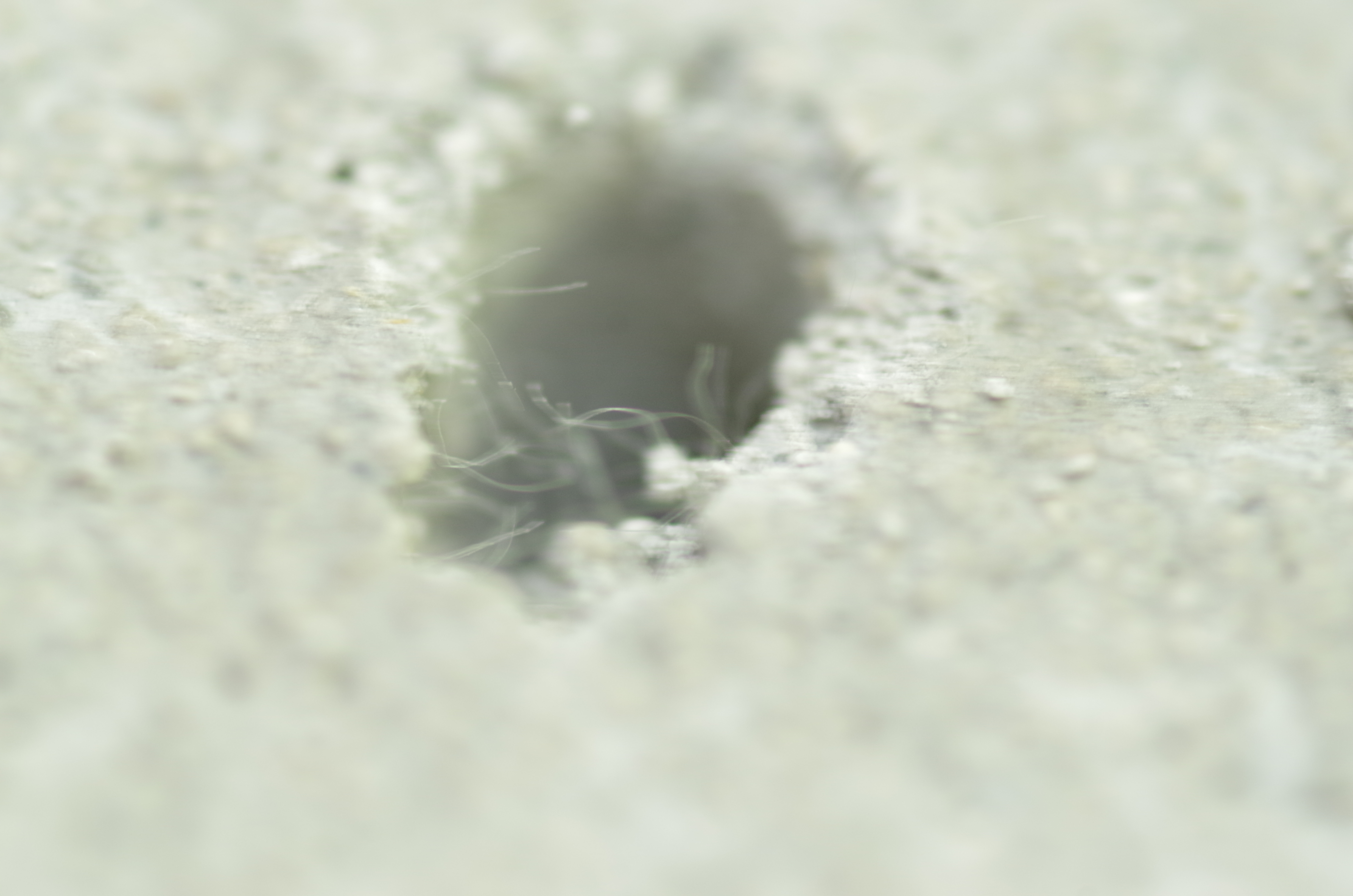

stockmaker Posted February 26, 2017 Author Share Posted February 26, 2017 OK the screw idea is not going to work out, but no exactly what we thought. The bolts came out of the test refractory block fine and a 1/4" twist drill bit in a drill cleaned up the remains of the treads in the holes quickly, although the risk of breaking the block is high doing this. But the big reason I am not going forward with this idea is because the refractory has ceramic fiber in it, when the refractory is disturbed the fibers stick out, so the two holes I drilled are now filed with a fine fuzz from top to bottom. I Used kast o lite 3000. I too like the straw idea for casting the refractory burners, thank you Neil. I still think I will use screws to position and hold the straws vertical. I assume the straws just burn out? I will cross that bridge when I get there. In regards to the flame jumping off the burner block. Frosty I did another test of the mock up burner, the one with a wooden block. I drilled out the 1/4" holes to 5/16", still keep the count at 17, and o boy was that better. See picture, pressure at 3lb. I could not experiment with pressures as the block was starting to burn. Thank you for those eagle eyes of yours. Quote Link to comment Share on other sites More sharing options...
swedefiddle Posted February 26, 2017 Share Posted February 26, 2017 Good Morning, Drill holes in the lower wood block (the part that is the pattern) they won't move. You can also use a wood block to stabilize the upper ends of the straws. The plastic straws will either come out by twisting or they will magically disappear when the Forge is fired. K.I.S.S. Don't look for the Hard Weigh!! Neil Quote Link to comment Share on other sites More sharing options...
