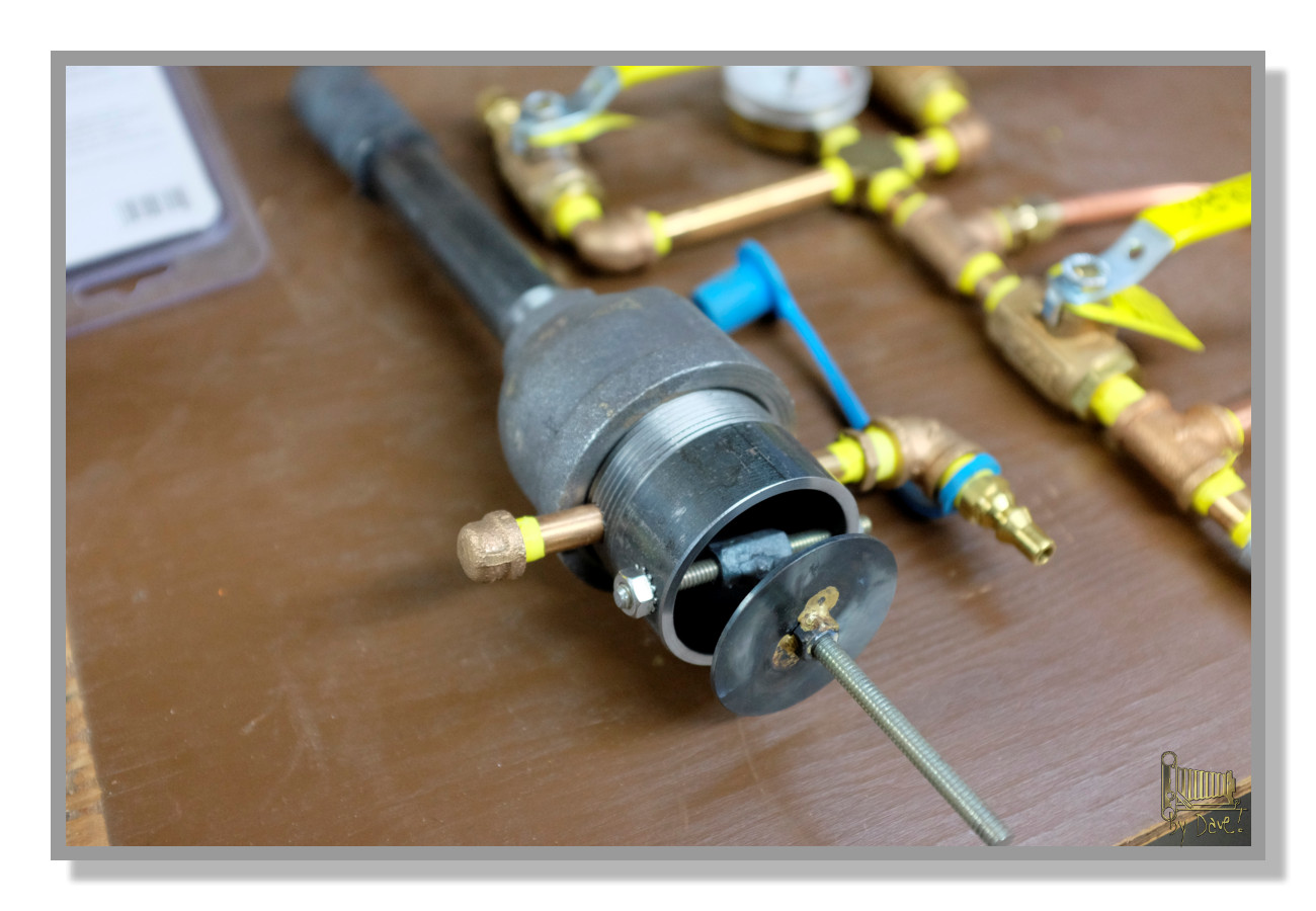

WoodnMetalGuy Posted February 17, 2017 Share Posted February 17, 2017 I'm just in the midst of a propane forge build and here are a couple photos from mine. Burner design is from book "Make: Fire" "The Art and Science of Working with Propane" by Tim Deagan. It starts out with the very basics and progresses from there, and I've learned a lot, and feel comfortable with my setup. Recommended. The shell I'm using is 14" diameter and will have 3" of ceramic fiber insulation. The kiln shelf bottom sits on kiln shelf risers, which are hollow and fit over studs I welded to the shell. Plumbing has an idler circuit, all gas rated valves, and took multiple trips to Menards before I rounded up all the right bits! -- Dave Quote Link to comment Share on other sites More sharing options...
Northland73 Posted February 17, 2017 Author Share Posted February 17, 2017 Great input. Thank you woodnmetal Quote Link to comment Share on other sites More sharing options...
