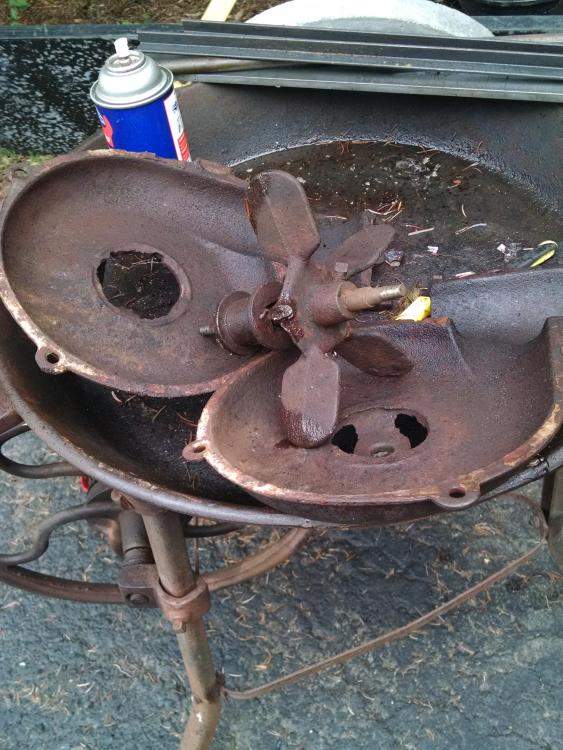

Zeke Zabo Posted July 18, 2018 Share Posted July 18, 2018 Hello all, new member here. I have the same forge and have it running. However, the fan seemed unbalanced and after taking it apart found that one of the fan blade "ears" is broken (and missing). Any ideas on "replacing" the whole blower blade or just the one ear? Haven't hit metal for years, and then found this whole outfit including stump, anvil, tools, forge, etc for a couple hundred bucks. Can't wait to start making noise and smoke. Thanks to all Zeke Quote Link to comment Share on other sites More sharing options...
JHCC Posted July 18, 2018 Share Posted July 18, 2018 Hi, Zeke, and welcome to IFI! If you haven’t yet, please READ THIS FIRST!!! Regarding your problem, it’s hard to make specific recommendations without photos. That said, however, I would generally recommend making a new blade out of sheet metal and riveting it in place. As long as it balances reasonably well, you should be fine. Quote Link to comment Share on other sites More sharing options...
Farmall Posted July 18, 2018 Share Posted July 18, 2018 Ive used the link belt that snaps together in whatever length you need. Quote Link to comment Share on other sites More sharing options...
Zeke Zabo Posted July 18, 2018 Share Posted July 18, 2018 Thanks JHCC. I have read the "read this first".... of course after my first post. I welcome any etiquette or content suggestions. Your suggestion is what I was thinking, sheet metal with a little extra weight to make everything balanced. Attaching it is the issue as the hub is cast iron and I am not sure how to drill it. Do you think that grinding a fresh surface and an epoxy will work? Quote Link to comment Share on other sites More sharing options...
JHCC Posted July 19, 2018 Share Posted July 19, 2018 Not for long; the epoxy will eventually degrade from the heat and fail. Cast iron can usually be drilled and tapped fairly easily, so screwing directly to the hub might be an option. Brazing the new blade in place might also be worth considering. Quote Link to comment Share on other sites More sharing options...
Al Stephens Posted July 19, 2018 Author Share Posted July 19, 2018 I would use JHCC suggestion and drill and tap the hub. Good Luck. Mine is still in storage, but I have time to work on it now. Al Quote Link to comment Share on other sites More sharing options...
BIGGUNDOCTOR Posted July 19, 2018 Share Posted July 19, 2018 Post a picture of what you have, so we can give better advice. Quote Link to comment Share on other sites More sharing options...
Zeke Zabo Posted July 20, 2018 Share Posted July 20, 2018 Here are some pics. I'll be measuring the hub of the fan and leaves. I think some sheet metal "origami" will let me bend it so flaps can be bent parallel to the hub with the leaves in the right orientation and then self-drilling sheet metal screws can be used. Any thoughts on lubing the tapered bearing ends in the casing. Thinking high-temp grease should be okay. Thanks again, Zeke Quote Link to comment Share on other sites More sharing options...
clgill57 Posted July 28, 2019 Share Posted July 28, 2019 The fan bearings are tapered and are poured Babbitt so its going to be tough to replace them unless you know how to pour babbitt bearings I have to do its to my lever forge too I think the ratchet drive bearings could be brass bushed since I dont believe those tapered Quote Link to comment Share on other sites More sharing options...
