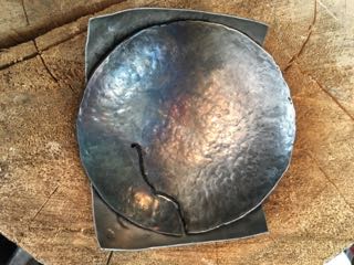

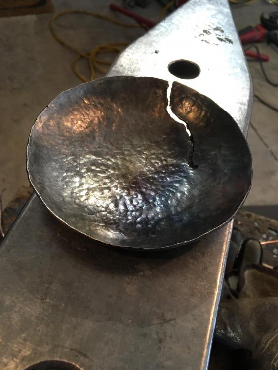

RogueRugger Posted January 23, 2017 Share Posted January 23, 2017 Attached are two pictures of the same small bowl. 5 in diameter, 0.75" deep, 14g mild steel. I have intentionally put a 'crack' in the side of the bowl and would like to fill the opening with copper (or brass). My first attempt at annealing a piece of copper wire and beating it to submission into the crack was unsuccessful. The next steps will be to fire up the ox-ace torch and simply melt/solder the copper wire into the opening. Probably assisted by some flux. Obviously there will be considerable cleanup afterward. (FWIW - I kinda like the way it looks now and I'll likely make a new one to experiment on.) Any suggestions about how to tackle this would be greatly appreciated! Dave Robinson Quote Link to comment Share on other sites More sharing options...
Smoggy Posted January 24, 2017 Share Posted January 24, 2017 Before I saw the pictures I thought this was to be an inlay problem, it is most definately a fill! Brazing would be the obvious solution, as you have a gas torch. Copper is also possible, gun smiths use copper as a solder to fix the sights to gun barrels using pine resin as flux. I see the biggest problem will be stopping the fill falling out before you finish, maybe wedge copper in and then braze it, should make an interesting feature after cleaning up. Best of Luck and we want to see the pics of the finished item. Quote Link to comment Share on other sites More sharing options...

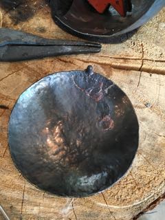

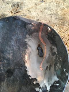

RogueRugger Posted January 24, 2017 Author Share Posted January 24, 2017 Thanks Smoggy, here's a quick look at the initial results. Figures 1 and 2 are the bowl and the backing plate I made. I put both in a hollow of a stump I used for making bowls. Lesson learned: wet the stump down before. Stupid... Figure 3 and 4 are the initial results of just melting some copper wire and letting it be drawn into crack. Pretty ugly, but as I expected. Figures 5 and 6 are after tackling the area with an old flap disk. Lesson: too much copper and had to be more aggressive than I liked to get the excess off. I thought the flap disk was at the end of its useful life, but it still had some bite to it. I was reasonably happy and thought it looked pretty good. Not real happy with the voids in the copper. Tried a few times to get the copper to re-flow and smooth out; also tried some flux. Finally gave up and thought that the voids would blend in after retexturing the area. Unfortunately, during retexturing, the copper pulled away from the sides of the crack. Figure 7 is what happens when I tried to re-flow the copper again. Burned. Through. #@$!*$@$@#$%@ etc. The retexturing had thinned out the metal around the crack. Sigh.... Any thoughts on what I might do different would be greatly appreciated! Meanwhile, I'm gonna go make something that I can beat up on the anvil ... Dave Quote Link to comment Share on other sites More sharing options...
Jim Coke Posted January 24, 2017 Share Posted January 24, 2017 Greetings Dave, TIG is the optimum but if that is not available . You might try a super clean surface using some silver solder flux and adjust your torch ( small tip or mini set up like a jeweler) with a oxygen lean mix. I would also pre- heat the surrounding area. Stainless works well for a backup or a graphite block. I wish you success. Forge on and make beautiful things Jim Also after the copper sets keep the area warm so that it cools at a slow rate. A propane torch would work well. Quote Link to comment Share on other sites More sharing options...
RogueRugger Posted January 24, 2017 Author Share Posted January 24, 2017 Jim, thanks, didn't think of the stainless; vaguely remember that from class. My micro torch didn't get hot enough, but will try again. Thanks again, Dave Quote Link to comment Share on other sites More sharing options...

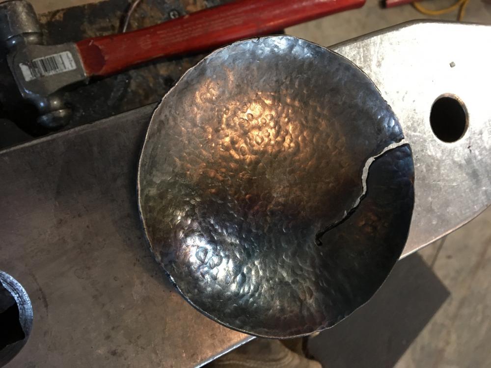

RogueRugger Posted January 27, 2017 Author Share Posted January 27, 2017 okay, made a little bit more progress today. gote: 'mu shin' - from my perspective, this is a bit of a pun since i'm working with 'no brain' on this ... I'm sure you meant it in the more positive sense I tried a couple of things today: -Tried the same size crack as yesterday and just smush the copper into the crack. Was hoping that if this worked I could justify getting a flypress . No joy. Tried brazing (for the first time). I had a package of flux coated bronze brazing rods (unopened). Seemed like it was working, but I had a hard time controlling the flow of the bronze. However, the dang stuff stuck all over the place so whatever the flux is, it worked great. I even ran some copper as filler over a few of the bronze voids. Real interesting color scheme that will be explored later - when I get better at brazing. Result was something along the lines of what GOTE was suggesting with the copper/solder. Then decided to start with a smaller crack (shorter and skinnier) and work my way up to something more serious. I crumbled the flux off the brazing rods and laid a short strip of copper wire on top of that. Worked fine, but clean up was tedious. The flux glass and copper stuck in a few places outside the crack. If the bowl were destined for a smooth finish, it would have been fine. I think I will get better at controlling the flow of the copper with a bit more practice. Unfortunately, the dimples on the surface make clean up difficult and then the retexturing brings a lot of stress to the copper. I annealed the copper inlay a few times while I was retexturing and I think that helped avoid some copper/steel separation. The figure below is the result. The right 1" of the crack is through the plate, while the remaining crack on the left is really more of a gouge. The copper wouldn't stick in the gouge. The flux from the brazing rod seemed to make a big difference. Thanks again for all the suggestions ... Dave Q: Can anyone suggest a stand-alone flux that would be similar to what is on the brazing rods? Quote Link to comment Share on other sites More sharing options...
Smoggy Posted January 27, 2017 Share Posted January 27, 2017 Looks Like you are making good progress, it may not be perfect but you have achieved what you set out to do. From here it looks like practice, practice, practice..... ok maybe a little process refining......but lots of practice too! Quote Link to comment Share on other sites More sharing options...
