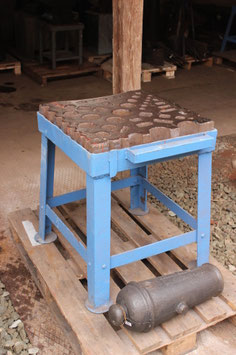

angiolino Posted January 31, 2017 Author Share Posted January 31, 2017 guys sorry if I insist this metallic block as it is called technically and how to use thank you, excuse me if I'm pedantic with my requests thanks for your cooperation Swage Block e Stand Quote Link to comment Share on other sites More sharing options...
Ridgewayforge Posted January 31, 2017 Share Posted January 31, 2017 A Swage Block is a cast iron block with many shapes, depressions or holes in it, used to form hot metal. Its not used for forging, but for things like punching holes, setting shoulders on hardy tools, bending stock, dishing sheet metal to make ladles and spoons. If you don't have an anvil yet, don't bother getting a swage block. It is cast iron, so shouldn't be used for general forging. What do you have in your shop already? Quote Link to comment Share on other sites More sharing options...
angiolino Posted January 31, 2017 Author Share Posted January 31, 2017 the workshop was the origin of his grandfather, he inherited all glia gear my cousin, who gave them away for a plate of beans, a pittance, I use an iron plate cutout big heavy a plate resting on two sawhorses in iron, but it is not heat-treated steel, with a hammer I can beat with heavy mace is not effective and efficiene, so I try anvil or similar tool, thanks for clarification would have other suggestions? Quote Link to comment Share on other sites More sharing options...
Charles R. Stevens Posted January 31, 2017 Share Posted January 31, 2017 Go looking for a round or square section drop, 3-6" across and a foot to a foot and a half long. A 3-4" plate a foot or more on a side would work well to. As mentioned, heavy equipment/tractor axle, forklift tine, rail section, rail car axle, rail car cuppler (a broken one is still massive) heck a peice of an old Sherman or panzer tank front slope, lol. Quote Link to comment Share on other sites More sharing options...
