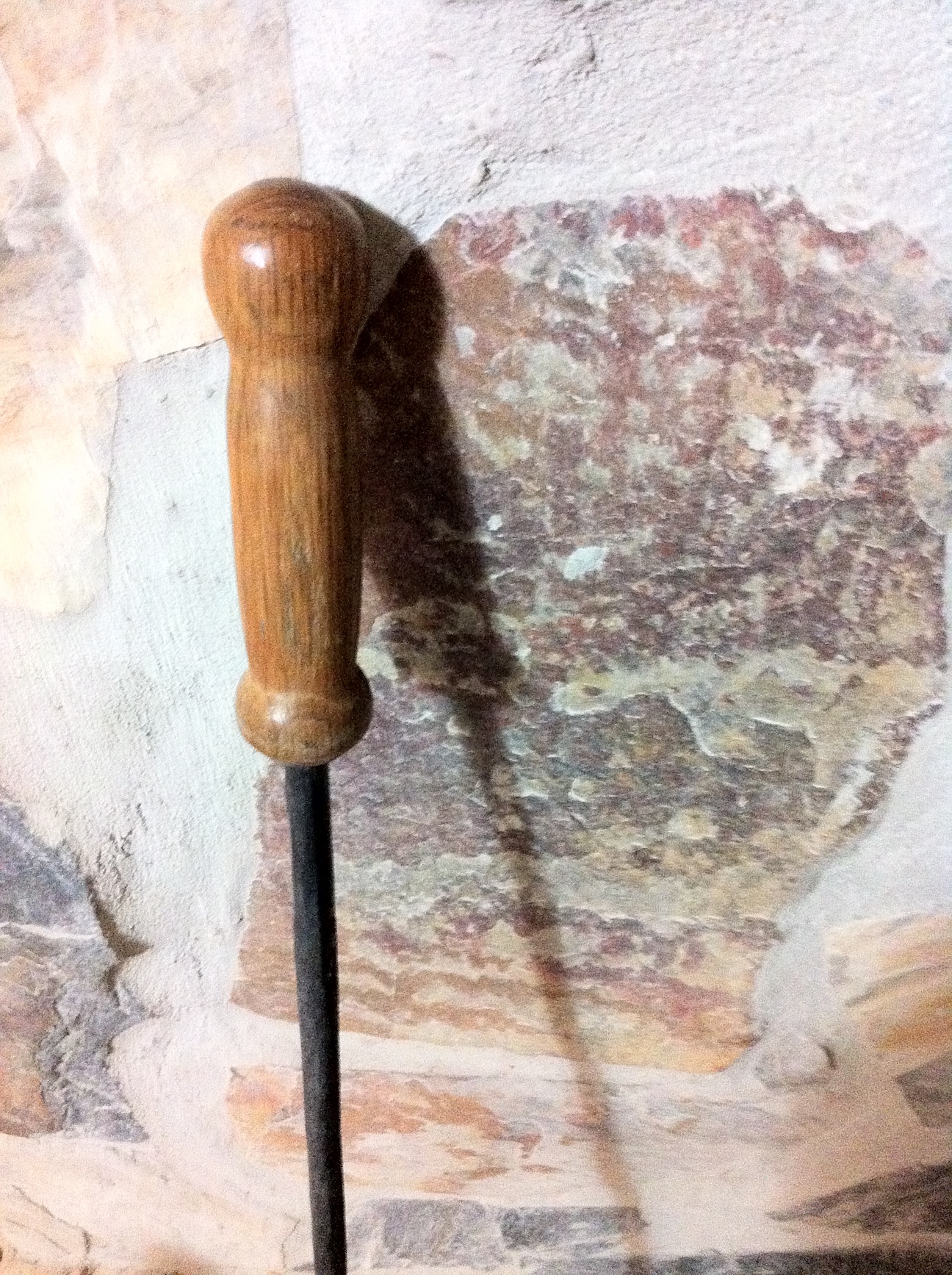

Nothing fancy, one I did several years ago for my wood heater.  Just a turned red oak handle. drilled a 3/8 hole most of the way through, tapered the end of the poker and squared it, ground off the scale and epoxied it in place.  I set it up so the epoxy would have a little room, and the start of the square taper is just inside the drilled hole of the handle for a tight fit.  Been working good for 7-8 years now.  Wish I'd done an oil finish on the handle, but so far the poly is doing OK.  If I was to do a fancy version I'd likely make ferrules and use something other than red oak.
