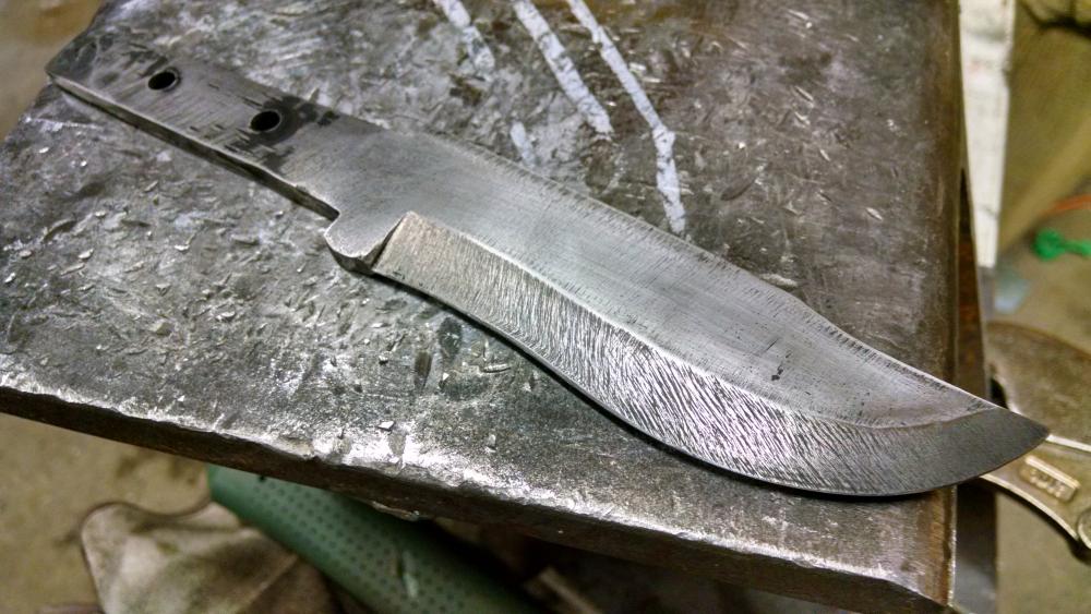

duckrunner Posted February 1, 2017 Author Share Posted February 1, 2017 I've played around a bit more since the last posts, made a couple more blades and finished my second one completely. Working on a handle for my third knife I'm giving to my dad for his birthday tomorrow, and I think it's turning out very nice. I cast the brass myself for the guard, boy what a learning experience that was lol. Since this picture I've finished the brass guard, stamped it and buffed it. Just don't have pictures of that yet. I also made a small blade for a friend from a 12mm ratchet wrench and a file*. ***Removing the chrome from the wrench and forging outside since it was so nice here on Sunday*** Frosty, I do like jokes I'm just not very funny lol Link to comment Share on other sites More sharing options...

duckrunner Posted February 1, 2017 Author Share Posted February 1, 2017 Thanks JHCC! The hidden tang knife started it's life as a leaf spring from a 76 dodge pickup. Curious to see how it holds up! Link to comment Share on other sites More sharing options...

duckrunner Posted February 1, 2017 Author Share Posted February 1, 2017 21 minutes ago, ThomasPowers said: Doubt the pickup held up very well in that location; now down here if you see a vehicle with *any* rust you know it's an out of state car... Haha actually the truck was in very good shape until someone backed a skid loader into it. I don't think it had more than 10k miles on it. Was just used to haul hay bails it's whole life. Doubt it even spent any time on a paved road. There was obviously some surface rust on the springs, but 30 seconds with a sander and it was good and clean. No cracks in the portion of the spring I have cut up that I can see yet anyways. Link to comment Share on other sites More sharing options...

duckrunner Posted February 1, 2017 Author Share Posted February 1, 2017 2 minutes ago, C-1ToolSteel said: Nice progress! Looks like your hammer control is improving tremendously. I shaped the head of my hammer and it helped immensely! Took all the hard edges off one side and left it mostly flat, pretty much rounded off the other side. It's amazing how much easier those little changes made in the work. Can't wait to get my hands on an actual anvil and see how much that helps! Link to comment Share on other sites More sharing options...

Frosty Posted February 3, 2017 Share Posted February 3, 2017 Not funny? Oh don't worry you'll do or say something every now and then and we'll laugh along with you. You really are coming along nicely, dressing the hammer makes a huge difference. Epoxy, especially the fast set kind doesn't like getting hot. About 300f will soften it enough to get things apart and not screw up the heat treat on your blade. Once you have it how you like use slow set epoxy for strength, you'll be amazed how much stronger 24hr. is than 1hr. You can even short the catalyst and get a stronger bond. Frosty The Lucky. Link to comment Share on other sites More sharing options...
