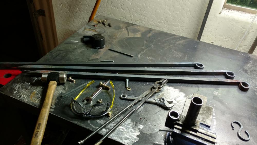

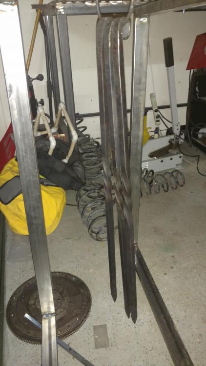

AZGUY Posted January 16, 2017 Share Posted January 16, 2017 Made my first camping tripod for my brother in law's family. I learned a lot making this and have some ideas on how to improve next time. Quote Link to comment Share on other sites More sharing options...
ausfire Posted January 16, 2017 Share Posted January 16, 2017 Nicely done. Pretty heavy metal! You would swing a hearty stew off of that. Quote Link to comment Share on other sites More sharing options...
AZGUY Posted January 16, 2017 Author Share Posted January 16, 2017 Yeah it's 5/8 thick. That was one thing I learned. Go smaller lol I wouldn't add those set to my backpacking gear but it's fine for them. They have a camper. Quote Link to comment Share on other sites More sharing options...
Adun Clebr Posted January 17, 2017 Share Posted January 17, 2017 They look nice; Ditto on the meaty metal. What height will the apex be in cooking position & what length are your tripod legs(?)? I got a Chinesium set as a gift (from Lodge...), and have this on my list to make. Thank you for your time. Quote Link to comment Share on other sites More sharing options...
ThomasPowers Posted January 17, 2017 Share Posted January 17, 2017 I make the two U and one O style without needing the ring. If you are making one for yourself size it for your style of cooking! (The two U and one O can also be used as two uprights and a crossbar for using more pots over a fire cowboy cooking style.) My largest was sized for a 10 gallon cauldron, about 6' in use with feet variations to deal with all that weight, my smallest was 3/8" sq stock and about 3' long finished. Quote Link to comment Share on other sites More sharing options...

AZGUY Posted January 19, 2017 Author Share Posted January 19, 2017 The legs were about 3' long each. I am not sure where everything sits in the cooking position as I did not measure it. I did not think to date it. It never even occurred to me someone would try to pass it as an antique. Looks like I have some research to do to find out a little more about these before I make my next one. I just kind of did what looked right from pictures I saw. Quote Link to comment Share on other sites More sharing options...

ThomasPowers Posted January 19, 2017 Share Posted January 19, 2017 Now as mentioned folks in the 1% way back when may have travelled with *tons* of stuff. I have a copy of Scappi's "Opera" from 1570, he was cook to 5 popes (hopefully his cooking was not associated with fast turnover!), and published a book with engravings of his tools as well as his recipes/philosophies Anyway his "camp cooking" set up took at least one wagon and probably 5 people to run. He had a folding metal spit racks, spiders with hooks on the legs for lark spits, etc and so on. OK, my take on large pot tripods---ones that can't be used for a cross bar set up but can take 100# of pot and stew: First large sq stock, because the square has a bit more metal than the round in the same "size". Then I do the two Us and one O on the top end as normal---I don't like using rings as individual pieces pack flat and can be distributed. (rings do make sure you show up with all 3 pieces though!---I've been asked to make a replacement piece on the fly before...) Adjust the other ends for equal length and point the ends. about 4" above the pointed end make a bend and about 4-6" above that bend make another and flatten the area between the two bends. Now adjust the bends so that when the tripod is properly set up, the flattened section is flat on the surface of the ground and won't sink under the weight of your pot and the pointed end is at right angles going down in the dirt to keep the leg from skidding out---the flat makes it easy to set up as you stand on it driving the point into the dirt. I like to demo this tripod to the customer by putting on a bunch of heavy s hooks and then standing on the end one to show it's stable with *my* weight on it much less a paltry 20 gallon cauldron.... Wish I had a picture of one but I do them up when requested and the old pics are on a hard drive that bit the dust. Quote Link to comment Share on other sites More sharing options...
