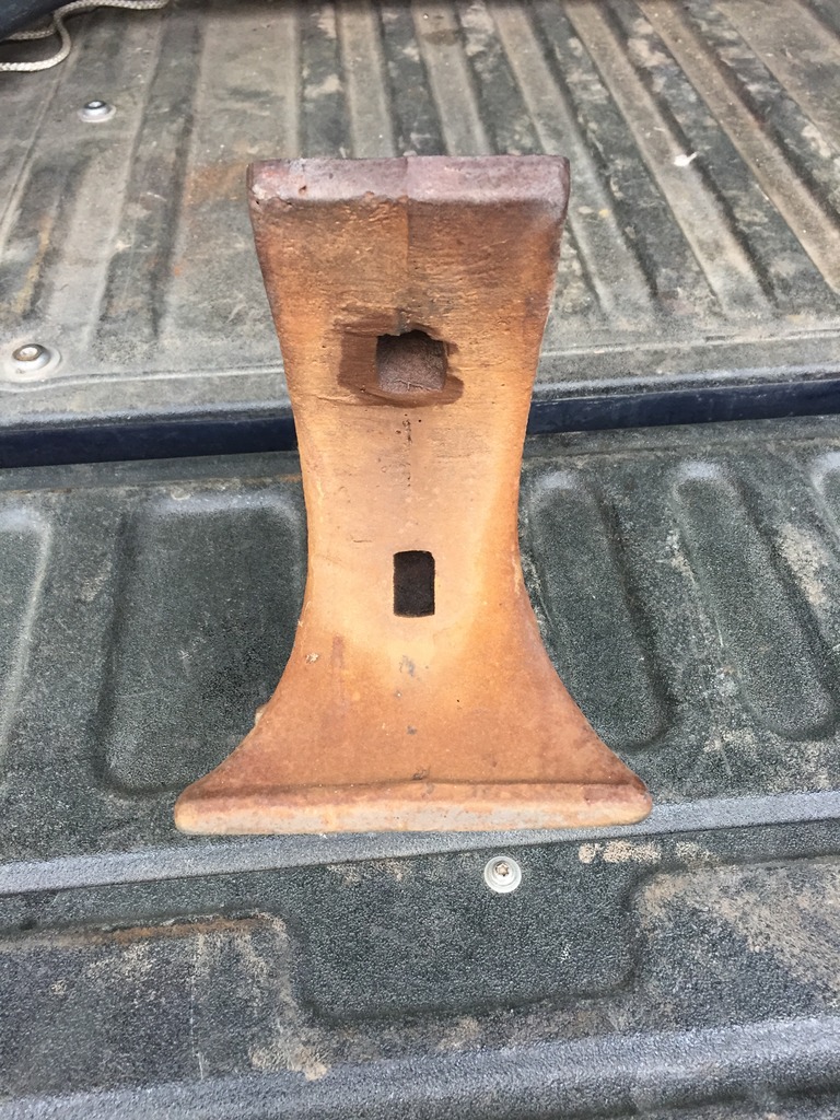

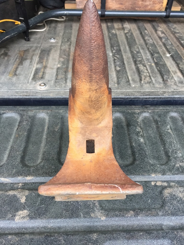

G-ManBart Posted March 27, 2017 Author Share Posted March 27, 2017 On 3/17/2017 at 9:59 PM, Scrambler82 said: I waited to post just to see if someone else made a comment. I looked at the under horn and the under heel pictures in post 1 when they were first posted and again a second time a while later and a third time just now and I really need to ask... " Are the Handling Holes real" ? Something looks off, almost like a black marker ! If I am wrong and someone gets offended I apologize but it still looks funny. The one does look a little funky, but they were real enough to put my finger in. I sold it, so I can't post better pics....sorry. I still have the originals on my phone, and there I can zoom in enough so see the dirt/oil/grit in the hole, and the irregular edge to it as well. On 3/13/2017 at 8:31 PM, arkie said: Post a picture when you get the horn dressed, so folks can see that you can do a little detail work WITHOUT using a grinder... While I like a good challenge, and have been slowly teaching myself to do hand-cut file checkering for gunsmith work, and would like to try my filing skills on the anvil, it may be going to a new home before I get to that. I was waiting for the weather to break to get my setup in order...still need a forge and a bunch of other stuff. Tonight I put a deposit on a brand new 330lb Refflinghouse #57 that a friend has locally. He imported a #57 and #58 and is only keeping one so I'm planning to sell the HB to help pay for that. It's overkill, I'm sure, but I was able to do a partial trade for a very cool vintage Wilton vise as part of the deal, so it was too good to pass up. Quote Link to comment Share on other sites More sharing options...
