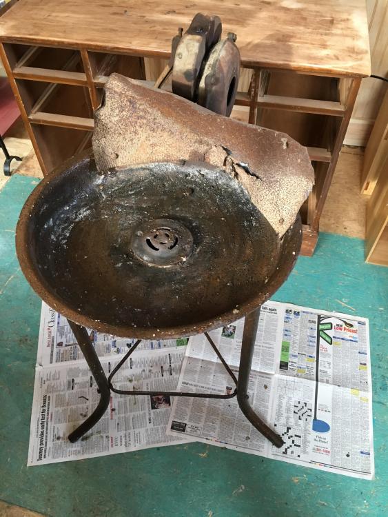

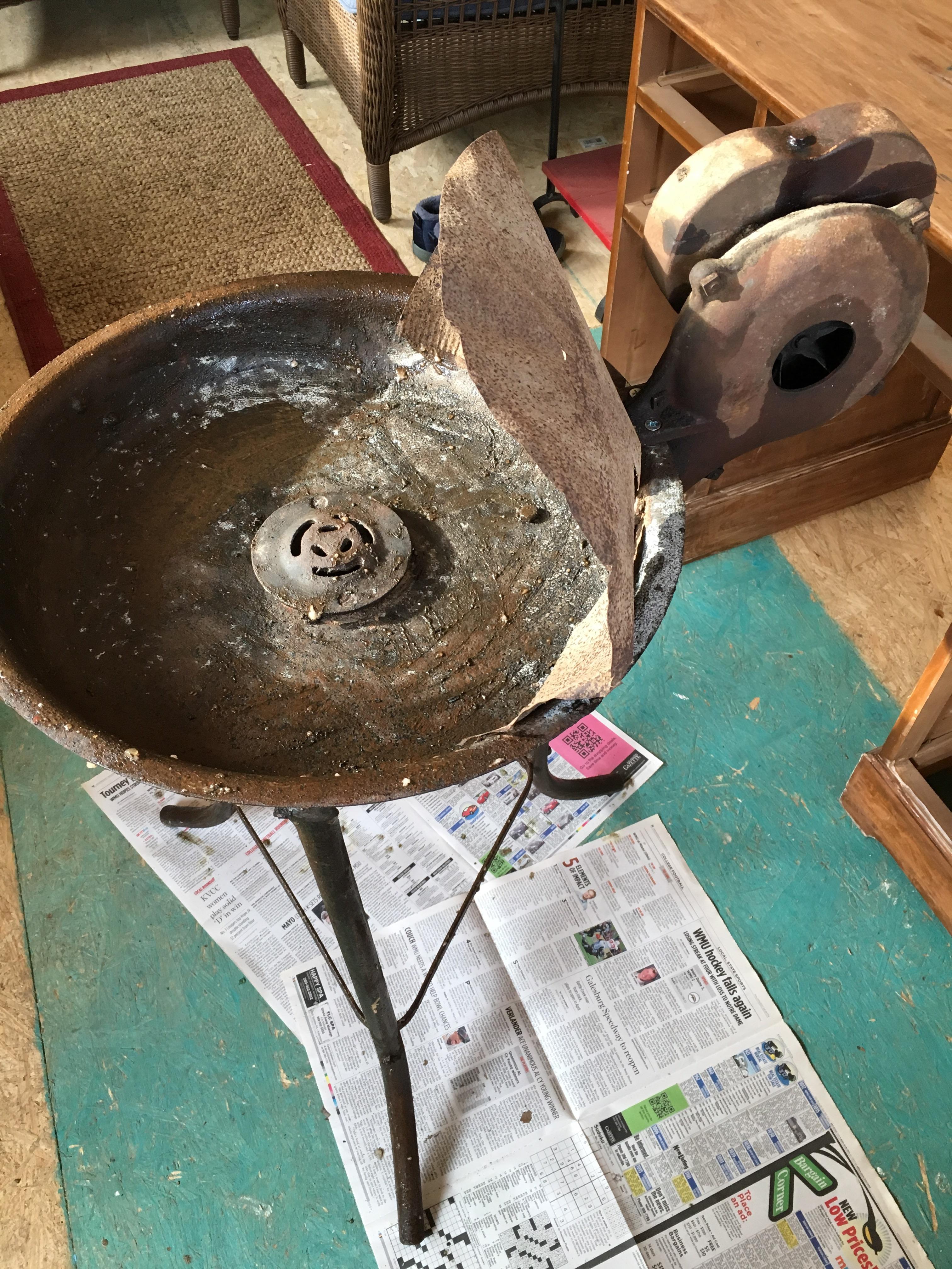

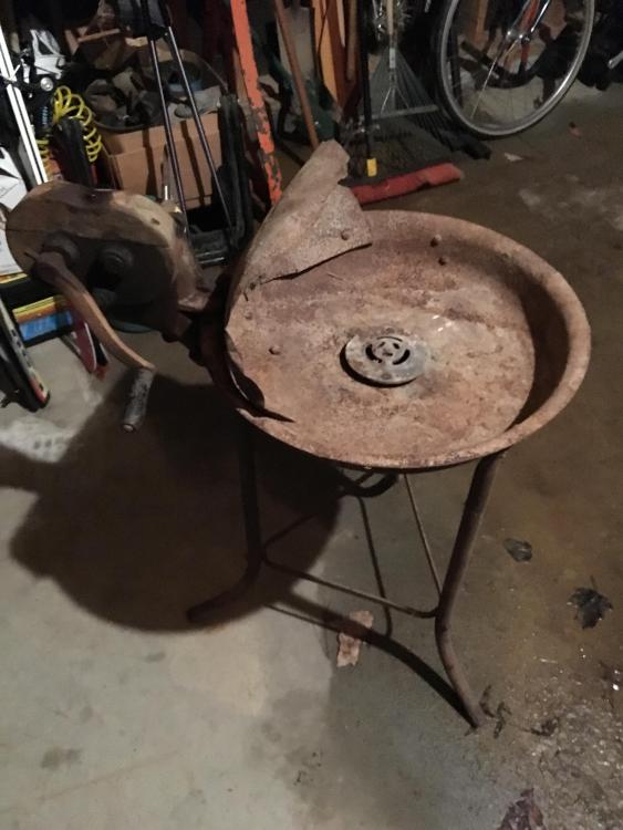

SandHuf Posted January 14, 2017 Share Posted January 14, 2017 So I found this old coal forge. It had no name on it, just the numbers 145-18. I looked into it and I think it's a champion forge. It's pretty rusted up, so I put some rust dissolver on it. My questions are; what type of metal is it made of? It is safe to use? Should I try claying the dish if it is cast iron? The blower works and I would really like to use it. Quote Link to comment Share on other sites More sharing options...
Millhand Posted January 14, 2017 Share Posted January 14, 2017 Great find!! I wouldn't hesitate to heat iron in that forge. Appears to be mostly cast. Very cool old forge! Quote Link to comment Share on other sites More sharing options...
Stash Posted January 14, 2017 Share Posted January 14, 2017 I have a similar looking Champion setup, the pan is stamped steel. CI would be thicker, and usually has the instruction cast in to 'clay before using'. Either way, claying would be a good idea. Steve Quote Link to comment Share on other sites More sharing options...
SandHuf Posted January 14, 2017 Author Share Posted January 14, 2017 1 hour ago, Stash said: I have a similar looking Champion setup, the pan is stamped steel. CI would be thicker, and usually has the instruction cast in to 'clay before using'. Either way, claying would be a good idea. Steve What are the steps to claying the pan? Would I use fire clay? Are there certain ingredients to mix with the clay? Quote Link to comment Share on other sites More sharing options...
Frosty Posted January 14, 2017 Share Posted January 14, 2017 Welcome aboard Sander, glad to have you. If you'll put your general location in the header you might be surprised how many Iforge folk live within visiting distance. Looks to be a cast iron rivet forge. Claying won't hurt if you don't use a lot of water managing your fire. The danger to a clayed forge is water can work between the clay and the pan accelerating rusting. Can't say who made it but it's a really common pattern from the era, I have a Buffalo that looks almost exactly like it except for the crack that makes mine sort of iffy to use. Mine has, "Clay before use" cast proud in the pan. Mine's also set up for a Champion 400 blower. I wouldn't mess with the phosphoric acid derusting agents or paints. It is what it is and has a couple few generations of life in her with a little care. Naw, no special clay need apply it's only purpose is to spread the heat out, cast iron does NOT like spot heating like you'd see around the air grate. Mix aprox 2-3 pts. sand to 1 pt. clay, river bank, garden, ditch, etc. is just fine. Only add enough water it'll clump hard when squeezed in your fist. Then ram it in the pan with a wooden mallet or the end of a board, a steel hammer is overkill and you don't want to accidentally give a cast iron anything a smack with steel hammer. Ram it till the mallet bounces and it's good to go to work. Frosty The Lucky. Quote Link to comment Share on other sites More sharing options...

ThomasPowers Posted January 15, 2017 Share Posted January 15, 2017 If the rim is thick it's cast iron; if the rim is thin it's stamped out of steel. I can't tell the thickness of the rim from any of your pictures. Quote Link to comment Share on other sites More sharing options...
SandHuf Posted January 15, 2017 Author Share Posted January 15, 2017 3 minutes ago, ThomasPowers said: If the rim is thick it's cast iron; if the rim is thin it's stamped out of steel. I can't tell the thickness of the rim from any of your pictures. It's a bit thin. Will it hold the heat from coke well? Or will it melt? Quote Link to comment Share on other sites More sharing options...
SReynolds Posted January 15, 2017 Share Posted January 15, 2017 You are obviously correct. It is what it says. No secret there. It is the model 140 EUREKA blower. No clay. I use mine all the time. But did make a false bottom for mine with 1/4" plate. I removed the tuyere plate and made a new one , incorporating the tuyere into that plate. It will destroy steel. It goes to welding heat in no time. Be careful. My students dont take it seriously because of its size and get careless. Quote Link to comment Share on other sites More sharing options...

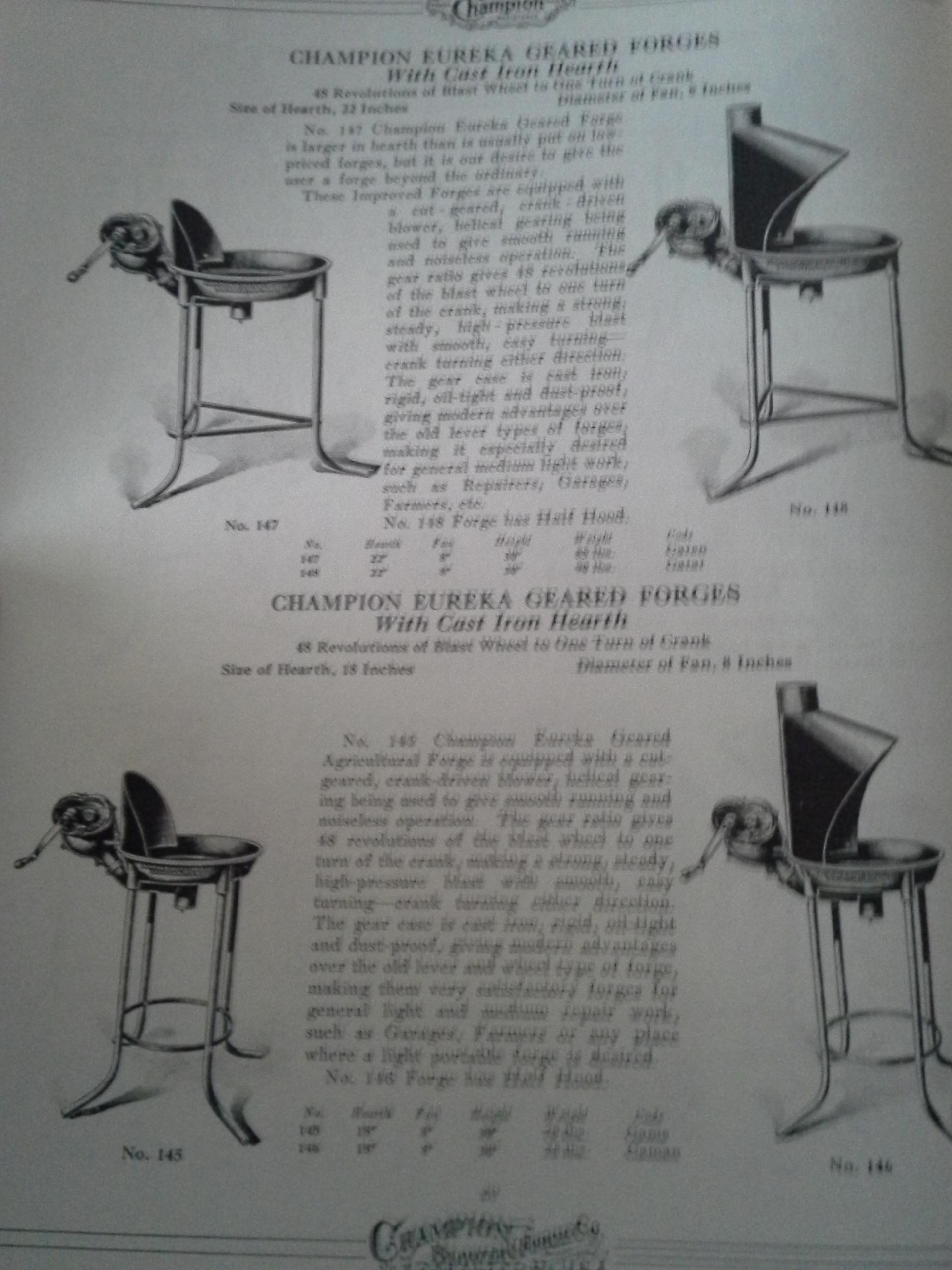

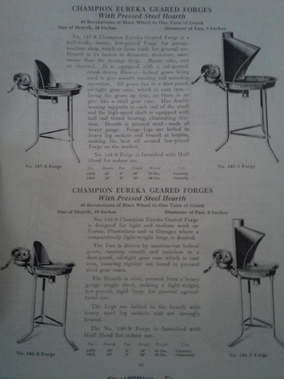

SReynolds Posted January 15, 2017 Share Posted January 15, 2017 Check these out. To answer your question; size of pan. How about that retro look with the sheet steel cabinet, huh? I kill for that. Quote Link to comment Share on other sites More sharing options...
SandHuf Posted January 15, 2017 Author Share Posted January 15, 2017 So is mine the 145 S, 147, or 146 S? Quote Link to comment Share on other sites More sharing options...
SReynolds Posted January 15, 2017 Share Posted January 15, 2017 Yes sir. If your is cast with 145 on the pipe then it is 145-18. The 18 is, of course, the pan size. S = steel (pan) Model 145 (no S) is cast iron pan These are late model units. Not 1880 or nothing like that. 1930 era (?) Not sure when the bagan these, but must have been the 30's as they are advadvertised in 1940 catalog Quote Link to comment Share on other sites More sharing options...
SandHuf Posted January 16, 2017 Author Share Posted January 16, 2017 So since there is no S it is cast iron. Except since it has no S it doesn't look like the one in your catalog. Mine has 3 legs. I can't seem to find the word clay stamped into the bottom because it is rusted out. Should I do it? I really don't want this thing to crack when I fire it up. Quote Link to comment Share on other sites More sharing options...
SReynolds Posted January 16, 2017 Share Posted January 16, 2017 It will not have the letter S cast into the pipe under the pan. That pipe assembly is used on cast iron and the pressed steel pan. Yours looks like steel. Protecting the steel pan with something isn't a bad idea. I know some who do not but I would and do on my old champion (steel) forges. I use a1/4" thick steel plate. I do use a cast iron forge and do not have clay as the guy I bought it from did not use clay. It has been used hard by him and myself with no clay. However it is a newer forge and not an antique. The firepot and surrounding table is cast iron . Come to think of it, I believe the old champion forges have firepots made of cast iron. No? Just says "Tuyere Iron" in the ads. So why is the firepot tuyere iron up to the challenge but the cast pan surrounding the fire (no fire contact) isn't? sounds like bunk. Maybe somebody at champion blower and forge was smoking something. Nonetheless. You dont have a fire pot. Your fire sets direct on the pan. Quote Link to comment Share on other sites More sharing options...
