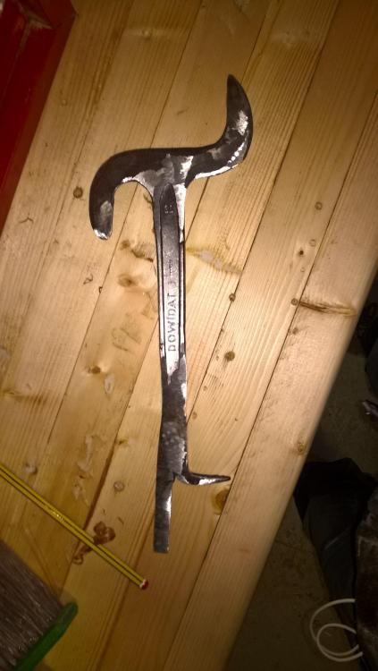

Millhand Posted January 14, 2017 Author Share Posted January 14, 2017 Well she works! Needs a few adjustments. More pipe, need a plate on the top of the inlet to help funnal and I think I'm going to move the hood in 2" Not super proud of my first forging project but hey I didn't have a anvil. In hindsight I should have just put it on the floor. Nothing like starting with half by 2. Was really happy with the heat time on a long piece but boy does she like her fuel! Fan on low is a bit much for a small fire too. Quote Link to comment Share on other sites More sharing options...
ThomasPowers Posted January 14, 2017 Share Posted January 14, 2017 was that the work piece laying on top of the fire instead of being covered with hot coals totally? Quote Link to comment Share on other sites More sharing options...
Millhand Posted January 14, 2017 Author Share Posted January 14, 2017 It was still in my hand, just setting it in as I took the picture. I did keep my fire low because it was super late and I didn't want a huge fire to have to wait to go out. Was a long day. 16 hour day going when I took that picture. Quote Link to comment Share on other sites More sharing options...
ThomasPowers Posted January 14, 2017 Share Posted January 14, 2017 I was just thinking how pleased you would be when it was being used correctly! Quote Link to comment Share on other sites More sharing options...

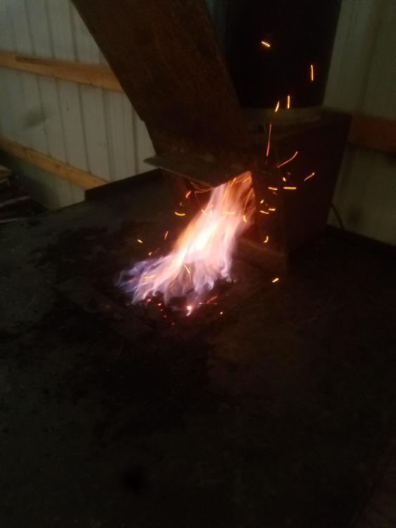

Millhand Posted January 29, 2017 Author Share Posted January 29, 2017 Side draft works wonderfully! About 11' of 12", I'll post pics tomorrow. Stoked the forge works great! I on the other hand need a lot of work! Top pic is charcoal, bottom is coal out of my outdoor woodstove. Pot Burns both quite well. Quote Link to comment Share on other sites More sharing options...
arkie Posted January 29, 2017 Share Posted January 29, 2017 Job well done!! You are gonna really like that setup. Glad you got the flue pipe and all set up; looks like it works like a dream. Quote Link to comment Share on other sites More sharing options...
