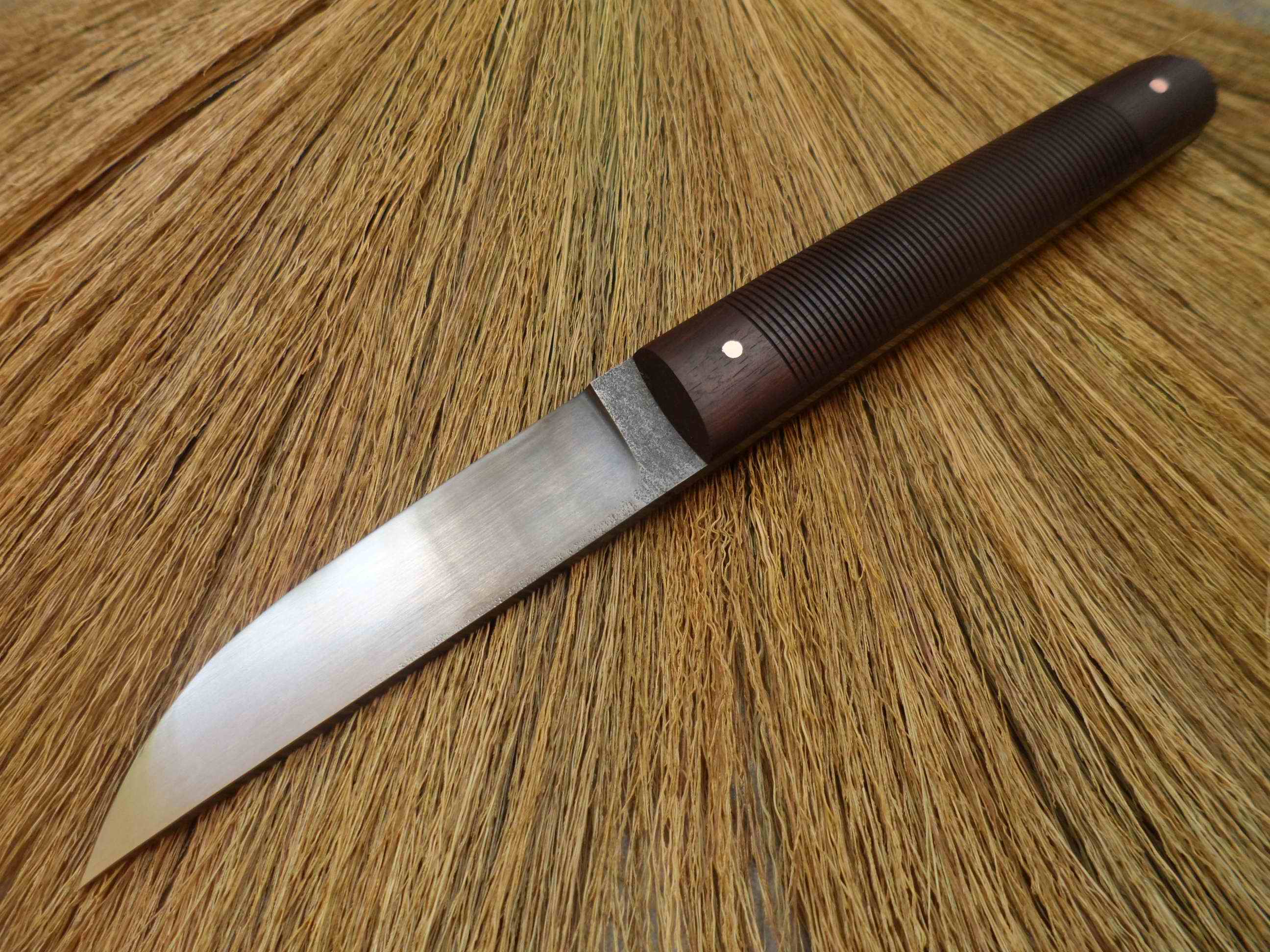

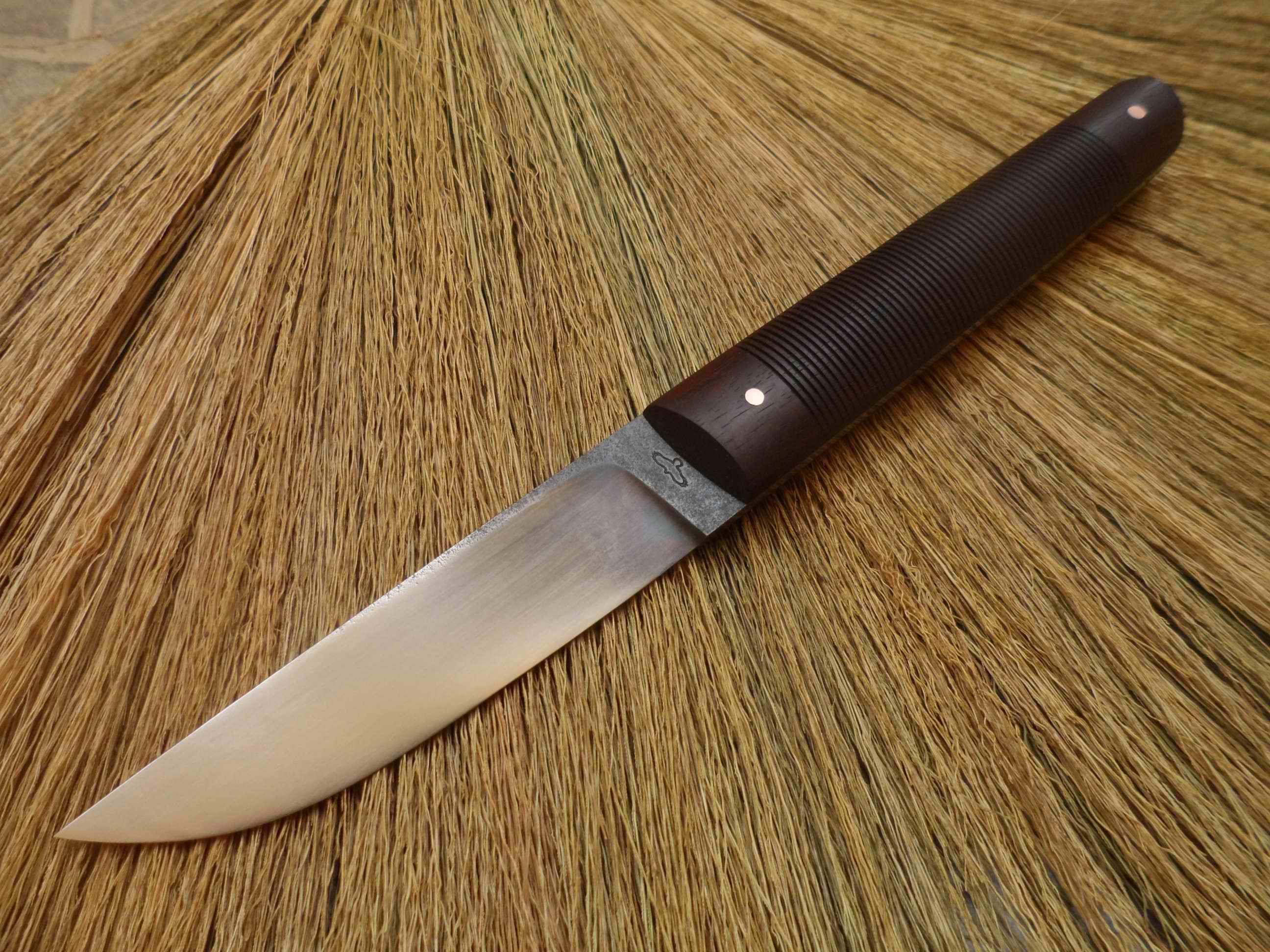

templehound Posted December 22, 2016 Share Posted December 22, 2016 Every time it is a new cognition how conducive straight Asian forms are. Forged Boehler 2513 TWR with Sterling riveted giraffe shin bone. Cheers Quote Link to comment Share on other sites More sharing options...
John McPherson Posted December 22, 2016 Share Posted December 22, 2016 Tight, crisp, and precise: everything it should be and nothing more. Excellent work! Quote Link to comment Share on other sites More sharing options...
aessinus Posted December 22, 2016 Share Posted December 22, 2016 All John's adverbs. Very striking. Did you use checkering files on the handle? Quote Link to comment Share on other sites More sharing options...

boisdarc Posted December 23, 2016 Share Posted December 23, 2016 Man, you are making me rethink this whole "I want to make a nice knife" idea that I used to entertain. I can't tell by the pics, do the scales extend past the tang like many of your knives in the past have? Quote Link to comment Share on other sites More sharing options...
templehound Posted December 23, 2016 Author Share Posted December 23, 2016 13 hours ago, John McPherson said: Tight, crisp, and precise: everything it should be and nothing more. Excellent work! Thanks for Your fine comment, Sir! 12 hours ago, aessinus said: All John's adverbs. Very striking. Did you use checkering files on the handle? Yes, I used a checkering file with about 18-20 lpi, cut 00. Thank You aessinus! 12 hours ago, JHCC said: "Any idiot can make the simple complicated. It takes genius to make the complicated simple." -- Thelonius Monk Thank You JHCC, that goes deep! Quote Link to comment Share on other sites More sharing options...
templehound Posted December 23, 2016 Author Share Posted December 23, 2016 11 hours ago, Daswulf said: Well that's a new one to me, giraffe shin bone. Should have enough for a whole lot of beautiful knives. as always, thanks for sharing your great work. Daswulf, giraffe bone is, besides whale bone the toughest bone I know. Cattle, buffalo and camel bone are IMHO too brittle to make satisfying scales.G-bone has a much bigger fat content. I personally think has to take besides pressure a lot of bending according to the giraffe's long legs, compared to buffalo and cattle which have to take more pressure than bending. Thanks for Your comment, always much appreciated! Quote Link to comment Share on other sites More sharing options...
Daswulf Posted December 23, 2016 Share Posted December 23, 2016 Thank you for the explanation Templehound. I would have thought it was just more exotic. There usually is more reason to the details of the work done by excellent craftsmen. Quote Link to comment Share on other sites More sharing options...
templehound Posted December 23, 2016 Author Share Posted December 23, 2016 2 hours ago, boisdarc said: Man, you are making me rethink this whole "I want to make a nice knife" idea that I used to entertain. I can't tell by the pics, do the scales extend past the tang like many of your knives in the past have? No, the scales don't extend over the tang.I like them extend over the tang, but that would have changed the drive of the design and raised the effort. Thank You boisdarc! Quote Link to comment Share on other sites More sharing options...

templehound Posted December 29, 2016 Author Share Posted December 29, 2016 9 hours ago, BCROB said: worth a second reply , really like this knife , may have to steel a portion of your idea....... Well,... I am honored, Thanks a lot BCROB! ...some additional input to encourage You I still have an image of the first study, it told me very fast about the angle of the checkering according to the design. Then I tried it on scales, figuring out the difficulty of continuing the evenness in the checkering pattern when the handle tapers too much. My pleasure Cheers Quote Link to comment Share on other sites More sharing options...
