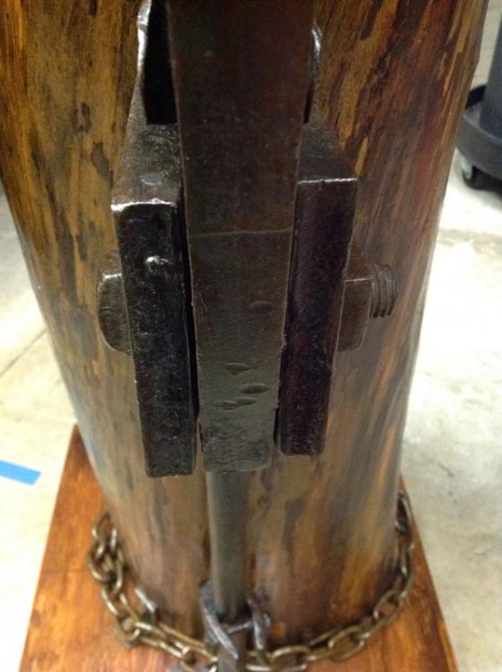

Quench. Posted December 21, 2016 Author Share Posted December 21, 2016 On December 18, 2016 at 11:10 AM, stockmaker said: I had the same problem when I put mine back together. Like Jim Coke says, tighten the pivot bolt, and make sure that part of the vise is as tight as it can be without binding. Hopefully that is all that is needed. This fixed most of the issue. I think everything is lined up, and the spring seems even. Post fits into a pipe fitting, welded onto a plate, bolted to the base that the stump rests on. So the post doesn't move. The vise will close properly with nothing in the jaws. After tightening the pivot joint as much as I dared, then backing it off just a smidge, it mostly stays aligned with the work in the jaws on the right side and it stays aligned all the way with the work on the left side. I'll have to make some shims as well. Thanks for your help. Picture below is after tightening. Still see a lot of gap, but the left and right plates, forming the outside parts of the pivot sandwich, are not parallel. The gaps are tight on the stump side of the pivot. -Q Quote Link to comment Share on other sites More sharing options...

stockmaker Posted December 21, 2016 Share Posted December 21, 2016 Good Deal. Don't forget to lube it, don't use grease it will gather dirt and filings, I used 20 wgt motor oil, but any light oil will do. Quote Link to comment Share on other sites More sharing options...
Quench. Posted December 22, 2016 Author Share Posted December 22, 2016 10 hours ago, stockmaker said: Good Deal. Don't forget to lube it, don't use grease it will gather dirt and filings, I used 20 wgt motor oil, but any light oil will do. Drat, I used grease. Oh well, guess I'll clean it out and squirt some oil in there. Have more oiling to do on various tools. Screwy weather over here is rusting everything in a flash. WD40 is easy to spray but just doesn't last worth diddly. -Q Quote Link to comment Share on other sites More sharing options...
