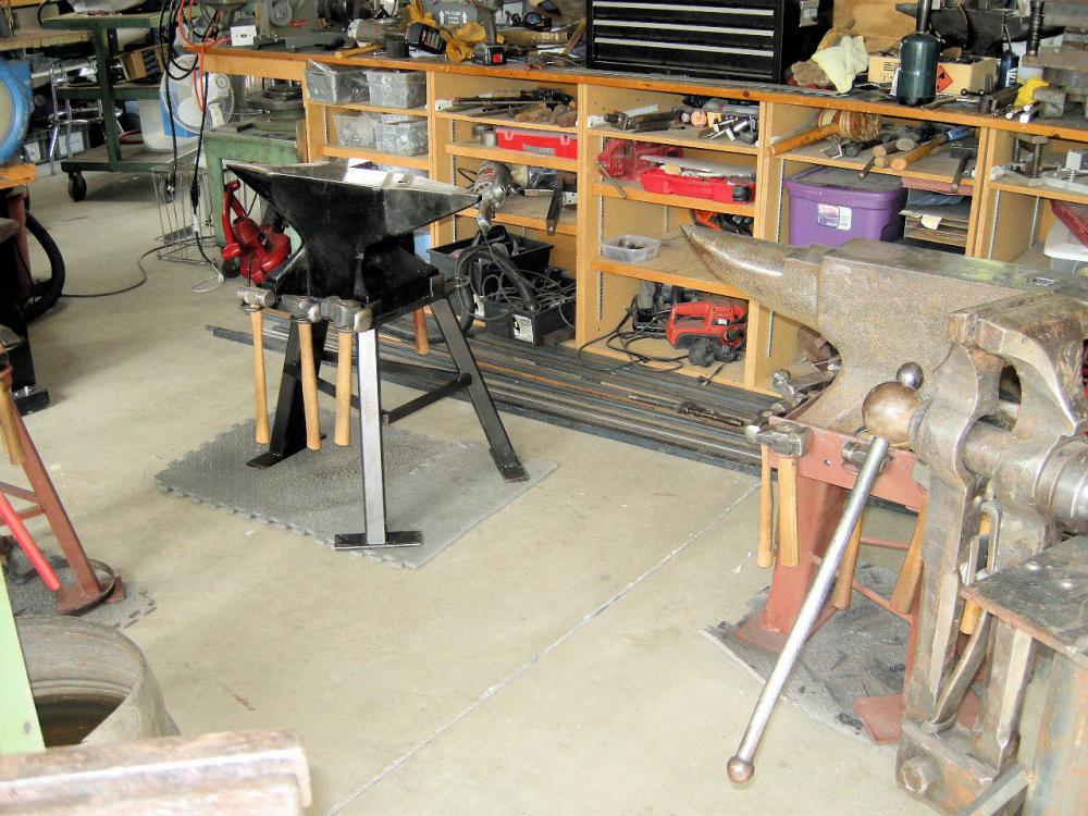

Not to dissuade you, just remember that unless you are a herculean human, moving a 330lb anvil will be difficult to do, whereas I can lift and move my 220 as needed.
It has also been said that sometime size is just ego.
I can easily "walk" my 180kg anvil, sitting on a solid oak sump, around the shop, that's not an issue. I also effortlessly raised my 150kg anvil on its base, alone, using a thick 3m long plank as an incline - 30 seconds job. so, unless it's 500kg, that's a non-issue.
hey, Martin Moldovan, are you of Romanian origin?
And then you get the "Oh the smithing demo is on the backside of the building and no you cant drive over the garden and there's 2 sets of steps anyway"   My demo anvil is my lightest one!  (Though I'll sometimes have a heavier one as a backup if they say, "Sure drive right up to your spot and we'll help unload!")
I've also had campouts where I had to pack stuff in; the viking anvil makes those trips
