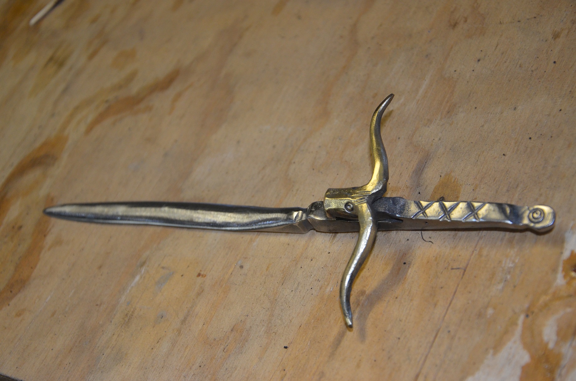

ausfire Posted December 11, 2016 Author Share Posted December 11, 2016 On 9/12/2016 at 7:09 AM, Daswulf said: Aus, those are really nice. How bout on the long horn you leave enough material in the handle to fold him up after making the bull head to look almost like a guard on a dagger. OK Das, I gave it a try. This is the first go, and as usual, learned a few things: I don't know why I drew the neck down to make it thinner. I could have used much more material in the handle end. Next one will be bent back full size stock so I have enough meat to taper the handle nicely and maybe have a finial or ball on the end of the handle. Probably will make the horns a bit shorter so that it looks more like a guard. I will also leave the horns square until forge welding the two parts of the handle fold together. That way there will be less chance of burning the horns at welding temp. They can be drawn out last. Interesting experiment. Thanks for the suggestion, Das. I'll improve with Mark II. Here's how it looks. Quote Link to comment Share on other sites More sharing options...
Daswulf Posted December 11, 2016 Share Posted December 11, 2016 Yeah Aus, Thats the idea. Looking at that one, I'm thinking the bull head would look good being past the handle and at the blade. I guess it would depend on what order you forged the parts. You could leave the handle beefier and maybe just forge weld the end and punch and drift a loop. It looks good. I should try one before I keep suggesting stuff to change yours haha. Mark II is always better. It works the kinks out. Next someone will recommend making the pommel look the the back end of a bull with a tail.. Quote Link to comment Share on other sites More sharing options...
ausfire Posted December 11, 2016 Author Share Posted December 11, 2016 Leave the handle beefier. Ha Ha, I like the pun. But yes, definitely more meat needed there. I guess if I made the handle thick enough it would look like the body of the bull. You could make a Brahman bump (except that Brhmans are not longhorns) and draw the end out to a curly tail. Ah, the possibilities are endless! Do have a try, Das. I would like to see your take on these. Quote Link to comment Share on other sites More sharing options...

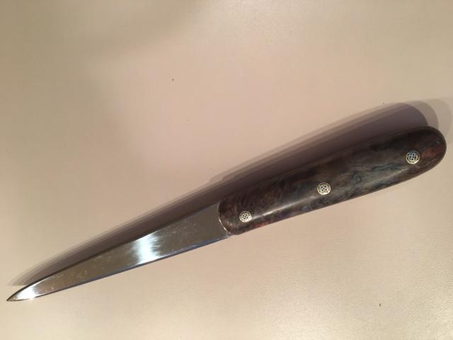

Buzzkill Posted December 12, 2016 Share Posted December 12, 2016 Probably not what you had in mind, but this is the one I made for my mother's birthday last month. She has arthritis, so a larger handle is better for her grip. I really like those longhorn and ram heads though. Good stuff. Quote Link to comment Share on other sites More sharing options...

Daswulf Posted December 13, 2016 Share Posted December 13, 2016 Buzzkill that's a beaute! I haven't seen antiques as nice. Well done. Blaster Joe, gotta love multifunction nice pineapple twist. Quote Link to comment Share on other sites More sharing options...
ausfire Posted December 13, 2016 Author Share Posted December 13, 2016 Yeah, what Das said. Those rivets are neat. Combination barley twist and pineapple twist! Quote Link to comment Share on other sites More sharing options...
