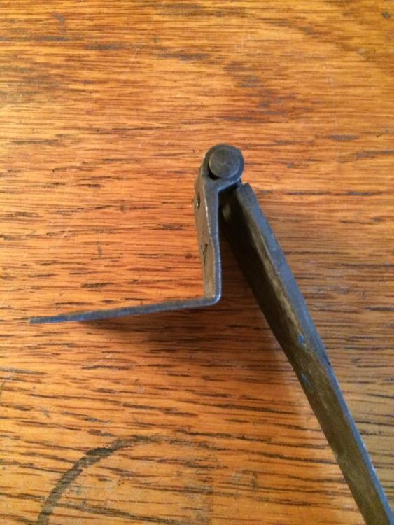

josef Posted November 7, 2016 Share Posted November 7, 2016 I need to make a pair of cranked chest hinges. These things are mounted on the inside of the chest with the hinge eye or barrel sticking out the back. My question is about the geometry of the hinge eyes. Anyone have any drawing references? I can visualize how the eye of the long strap that mounts to the lid would go. Having trouble seeing how the eye of the bent leaf would go. I can certainly play with some ideas but thought maybe someone else has historical references or solutions. thanks, Joe Quote Link to comment Share on other sites More sharing options...

bigfootnampa Posted November 8, 2016 Share Posted November 8, 2016 As long as the entire barrel of the hinge protrudes from the back of the chest you will have clearance for the swing of the lid. If the center of the hinge barrel falls inside the outer edge of the chest... the fitting gets a bit more complex. Do it the easy way! Quote Link to comment Share on other sites More sharing options...
Frank Turley Posted November 10, 2016 Share Posted November 10, 2016 I don't have an example to look at, but I keep trying to envision what you're after. I think that I would make the straps meet together like the leaves on a modern butt hinge. For example when butt hinges are installed, gains are chiseled the thickness of the leaf. Each leaf is inlet into its gain making the leaf flush with the face of the wood. In case of the chest, the gain would be chisel cut into the bottom edge of the lid and the top edge of the chest back thus allowing the lid to sit tightly in the closed position; ie., no daylight. I assume the bends will be right angle ones measuring from the barrel to the wood thickness. Say the wood thickness is 3/4", then the INSIDE CORNER of the hinge bend would be 3/4" from the barrel. If clinch nails are used, they would be in the main strap and tail strap. You're not going to be nailing into the edge of the wood, but a countersunk, flat head, wood screw could be used. Make pilot holes for nails and screws. Quote Link to comment Share on other sites More sharing options...
josef Posted November 11, 2016 Author Share Posted November 11, 2016 Hi Frank, thanks for your comments. You have it pretty much correct. Where I am having difficulty is visualizing how the eye turns on the leaf that mounts to the back of the chest and I'm just trying to avoid trial and error. I think I've got it figured out so back to the shop and try it. I've also got an email into the local historical society to see if they have a chest in their collection that I can study. All I have to work from so far is one broken leaf, the one that mounted on the lid. Quote Link to comment Share on other sites More sharing options...

Frosty Posted November 11, 2016 Share Posted November 11, 2016 The magic thing to remember, call it a rule is. The pin must be outside of the stationary wall of the box. It doesn't matter which half of the hinge is attached to the box or the lid so long as the pin is outside. If you want the lid to turn all the way and lay flat against the box's side you have to move the pin above the lid's top. If you want to make this a hidden hinge you end up with 3 90* bends, one in the lid half and two in the box half. This is much trickier. This bit of practical problem solving is the perfect place for a basic CADD program. Or, just make models with cardboard and pins, it doesn't matter if the hinge is unrealistically thick it's just a model you can move and test configurations. Frosty The Lucky. Quote Link to comment Share on other sites More sharing options...
