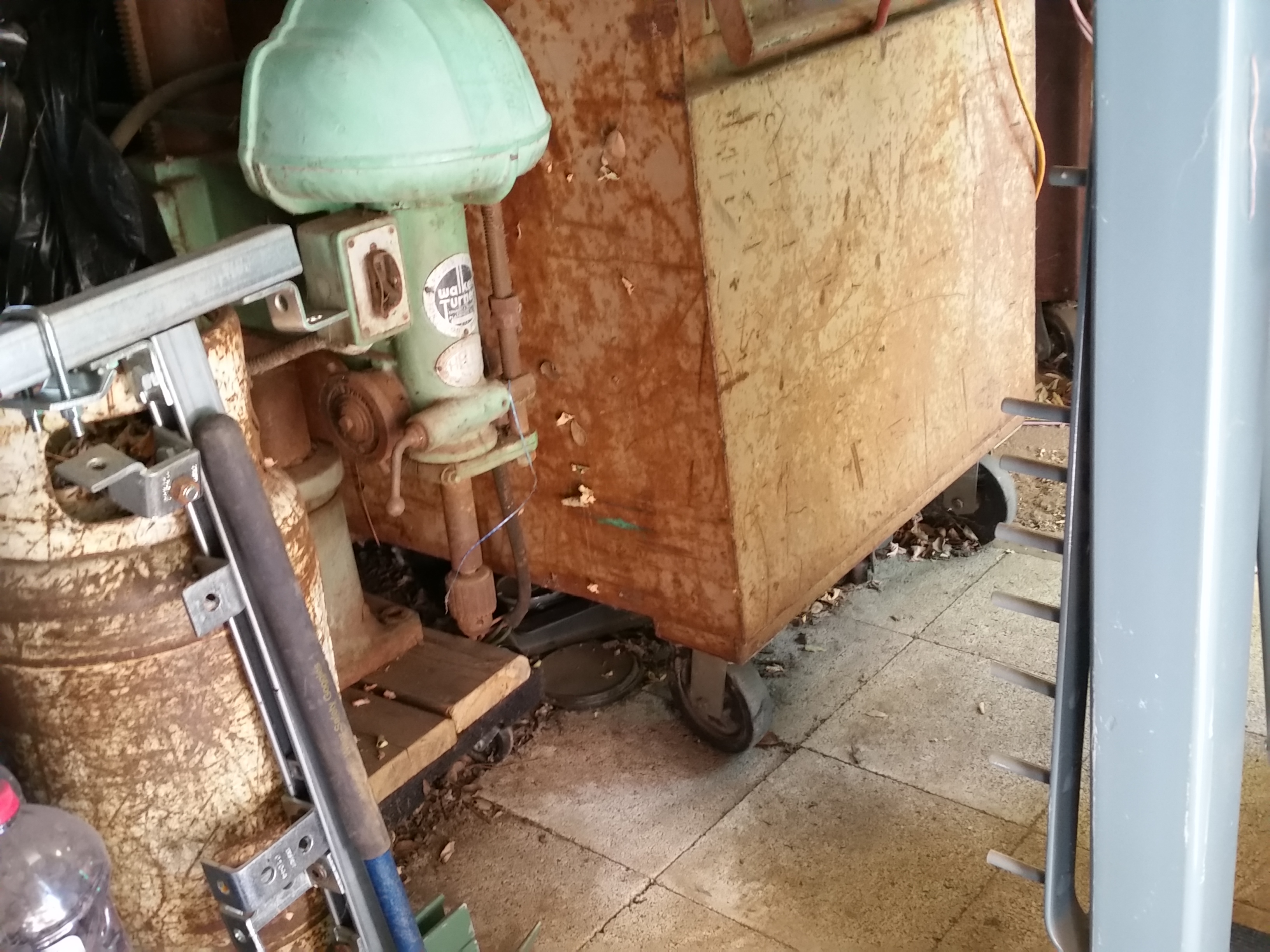

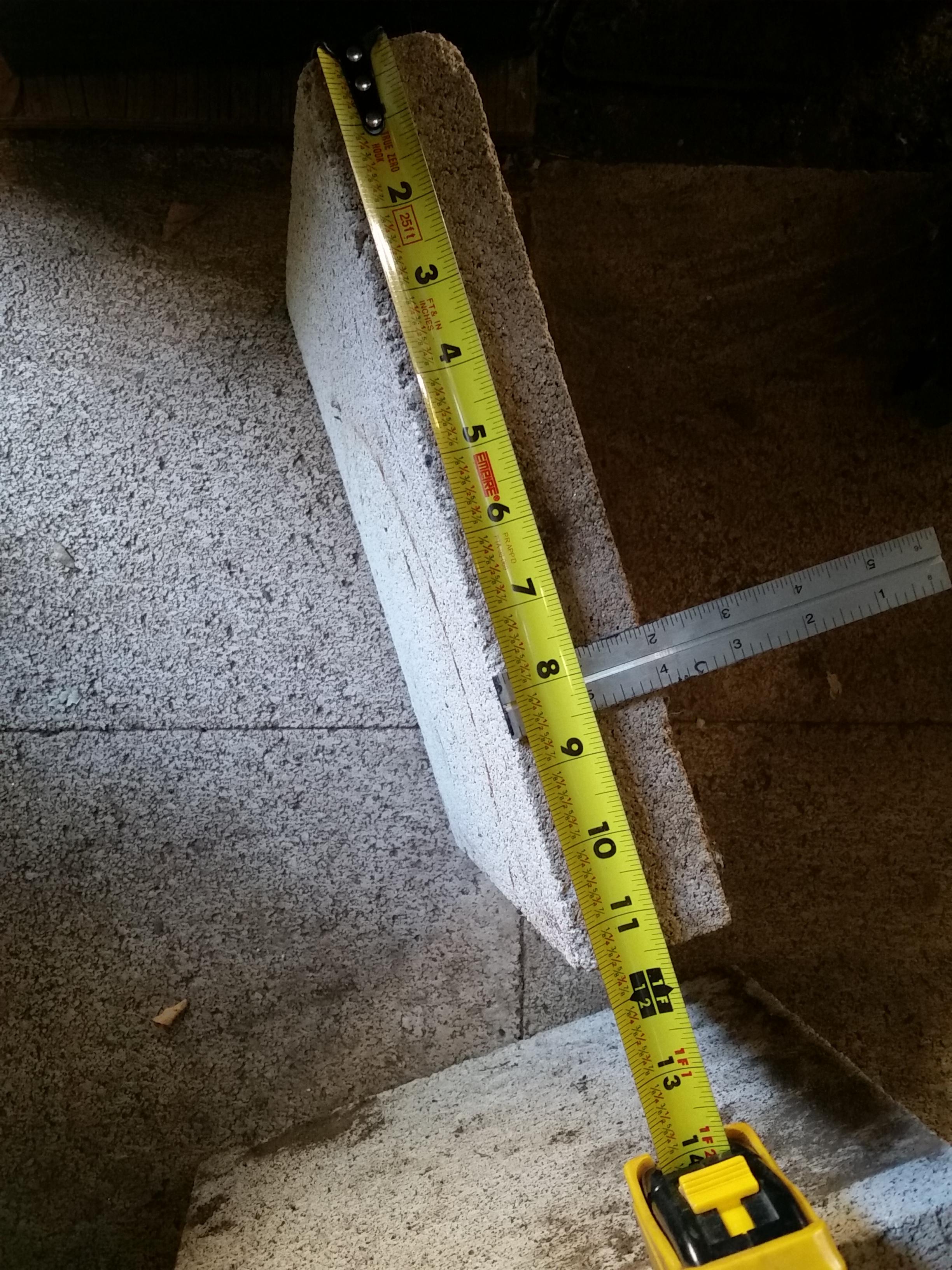

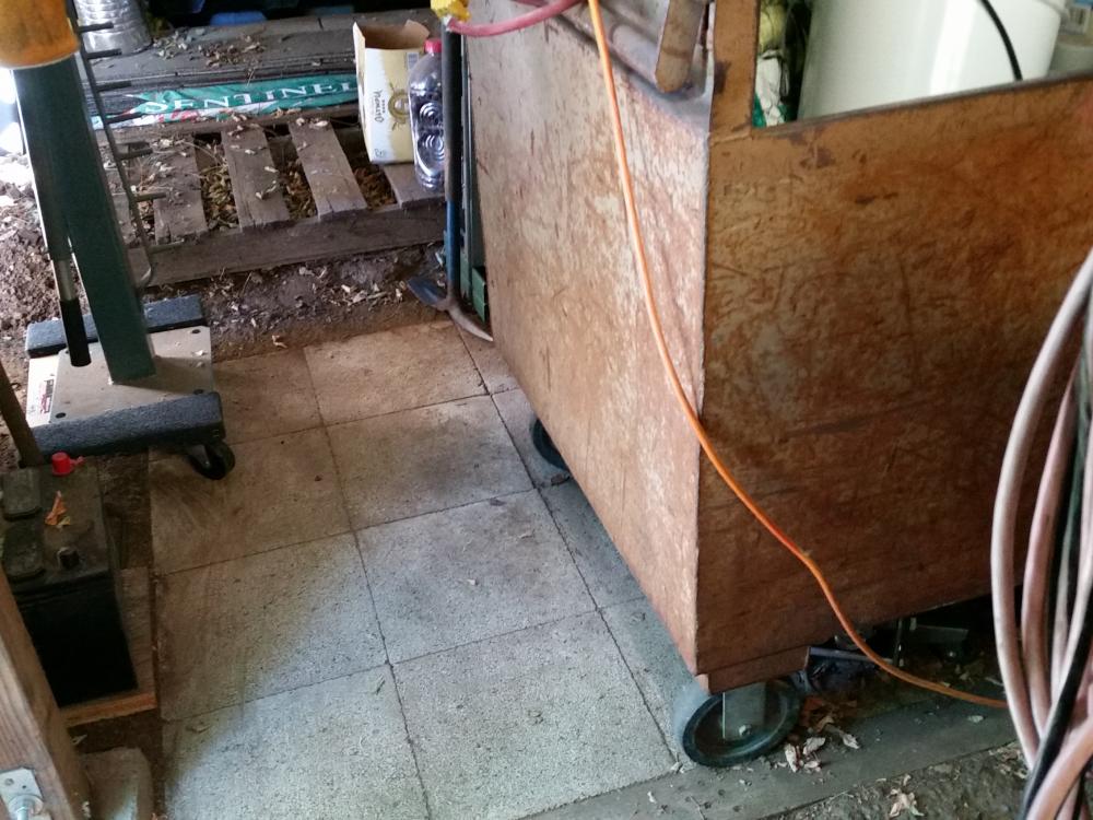

Anachronist58 Posted November 2, 2016 Share Posted November 2, 2016 (edited) I like the end-grain floor, I'd like to walk on some of that. Below is what I use here and there; not pictured is a 100 sq ft out-building with the same system, that has been stable going on 16 years. The Knack box weighs 360# empty, and the three drill presses, 250# each (all on wheels). I will provide prep details if requested, but 1/4" grout spacers make this system very repairable, if needed. Robert Taylor Edited November 2, 2016 by Anachronist58 Post Assembly Quote Link to comment Share on other sites More sharing options...
paradox1559 Posted November 3, 2016 Author Share Posted November 3, 2016 Is there a special grout to use on wood flooring? It seems sand is the best option, as Glenn mentions. It also may not hurt to get a ground "stomper" to ensure an even surface. Low spots are UNACCEPTABLE!!!!!! Quote Link to comment Share on other sites More sharing options...
VaughnT Posted November 3, 2016 Share Posted November 3, 2016 If you go with the end grain blocks, you'll be pretty happy with the results! The slight unevenness is really comfortable on the feet, and the floor just looks "right" in a shop. You can grout with an equal mix of portland cement and sand. The cement hardens with ambient moisture and helps look the blocks in place. Might not be absolutely needed, but a small bag of the stuff is cheap enough. Keeping the floor dry is really important because you don't want moisture being trapped underneath. I've seen bad jobs done where the top looked great, but the bottoms were rotted halfway through. You couldn't tell until you stepped on one and it gave way under your foot like some kind of pressure plate in an Indiana Jones film. Quote Link to comment Share on other sites More sharing options...
