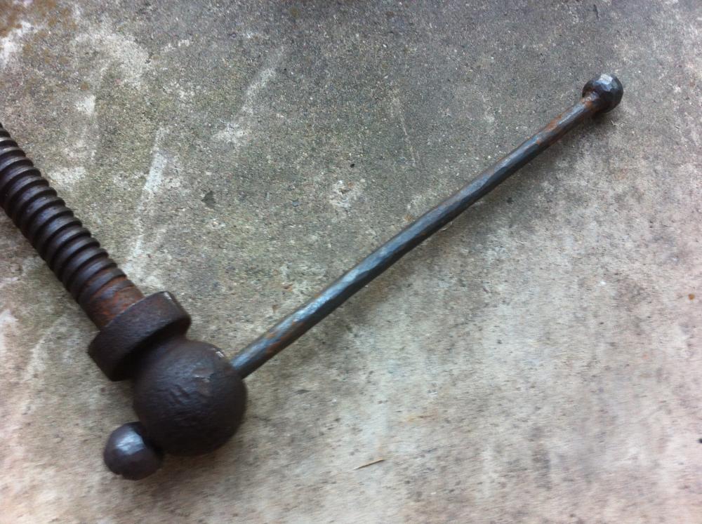

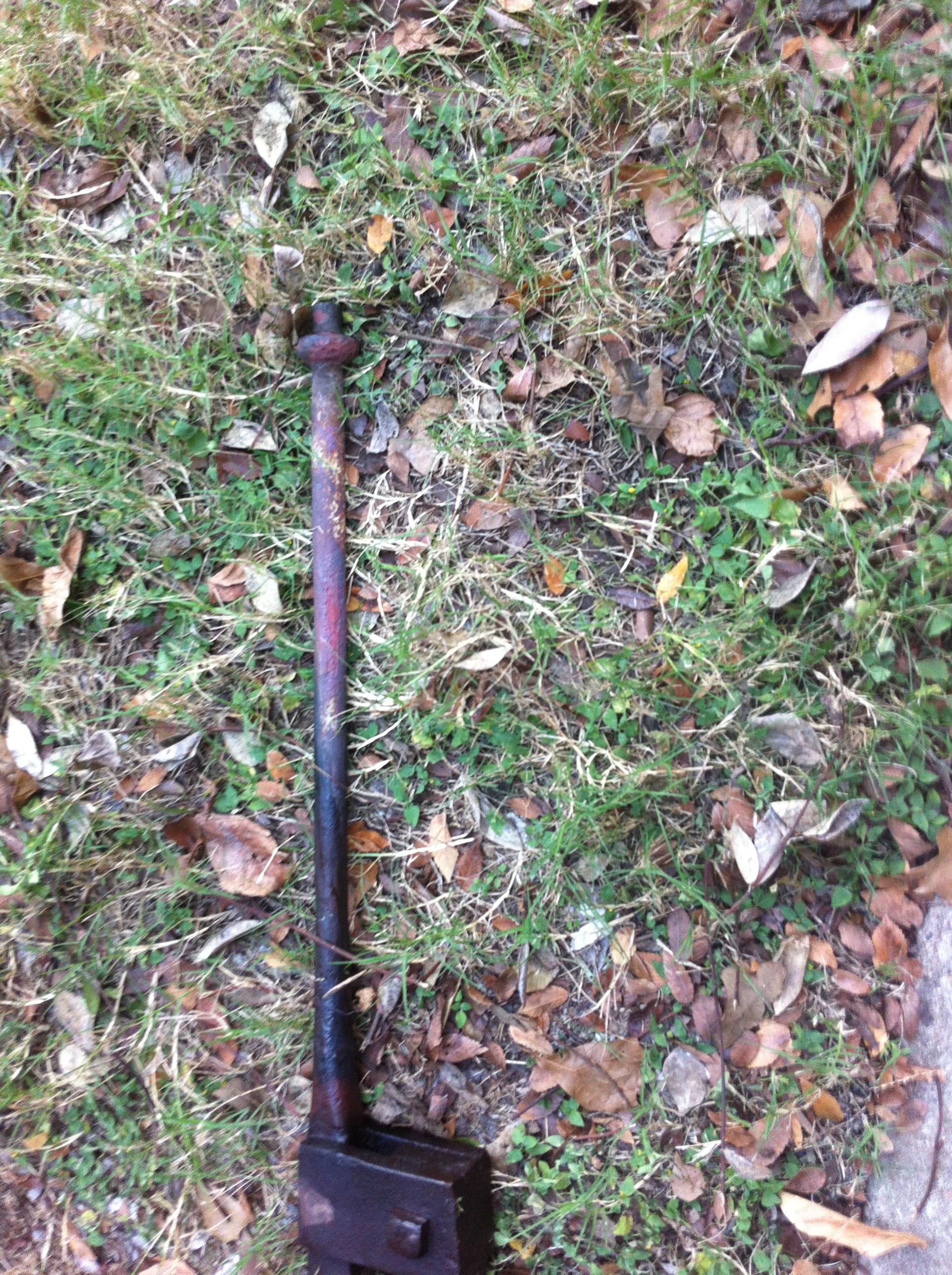

Mark Ling Posted October 30, 2016 Share Posted October 30, 2016 I have a vice that I'm working on, and one of the things is that the handle is bent and rusted thin were it was bent that when ever you use it, it re-bends at that spot. I am planning o re-forging a handle for the leg vice, and didn't know if it would be beneficial to make it out of a spring steel (I have a coil spring that I straightened out)? I would leave it un-heat treated. also, the wedges that keep the mounting bracket on were mushroomed, and so I took them to the grinder to remove it, and they appeared (doing a spark test) to be a medium carbon, or high carbon steel, is it necessary in the future to forge them out of a high carbon steel, or mild steel? thanks guys! Littleblacksmith Link to comment Share on other sites More sharing options...

Mark Ling Posted October 31, 2016 Author Share Posted October 31, 2016 Thanks Frosty and C-1 ToolSteel! Had some time today and forged a new handle for the leg vice (is there a proper term for that?). It was forged from 3/4 round mild steel, to a little over 1/2" round. On one end I forged a ball (it was the first ball that I had ever forged, they're actually kinda fun!) and the other one is riveted on to a tennon. The vice that I am making this for had a bent leg that I also straightened out. Littleblacksmith Link to comment Share on other sites More sharing options...

Mark Ling Posted October 31, 2016 Author Share Posted October 31, 2016 6 hours ago, arftist said: Nice work but I think it will bend in use. Try spring steel for the handle. Thanks, that's what I thought at first, but then was told by two people not to, and so went and forged it. If I'm unhappy with it that I will make a new one. This is very much learning experience for me, and so we will see how it works! Littleblacksmith Link to comment Share on other sites More sharing options...
