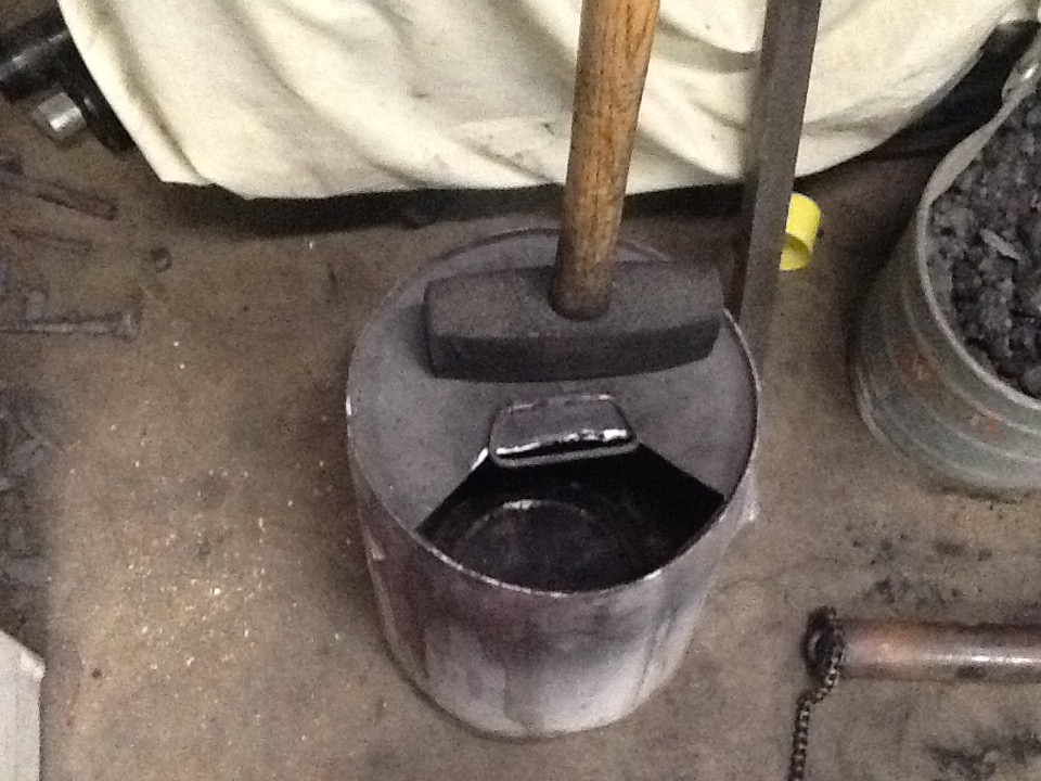

Kevin Olson Posted October 21, 2016 Share Posted October 21, 2016 I have a metal 5 gallon bucket and sledge hammer. The hole in the top is big enough to put a scoop of coal through yet keeps the coal in the bucket when I'm smashing xxxxxxxx out of it with the sledge. Like a butter churn. Then I just pour it onto the coal staging area on the forge. Easy peezy Quote Link to comment Share on other sites More sharing options...
