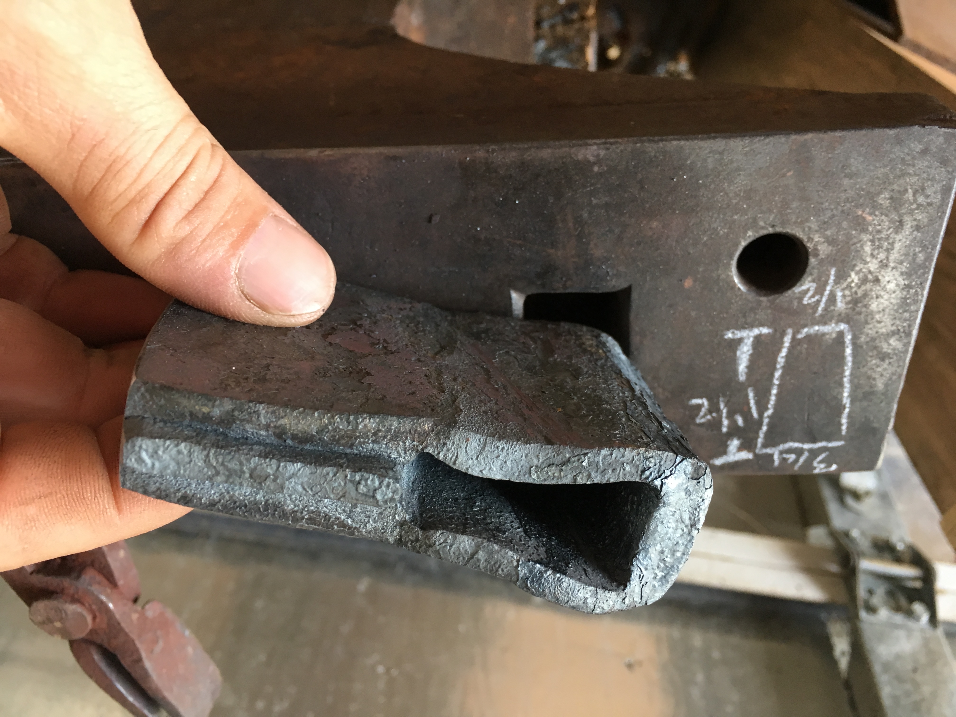

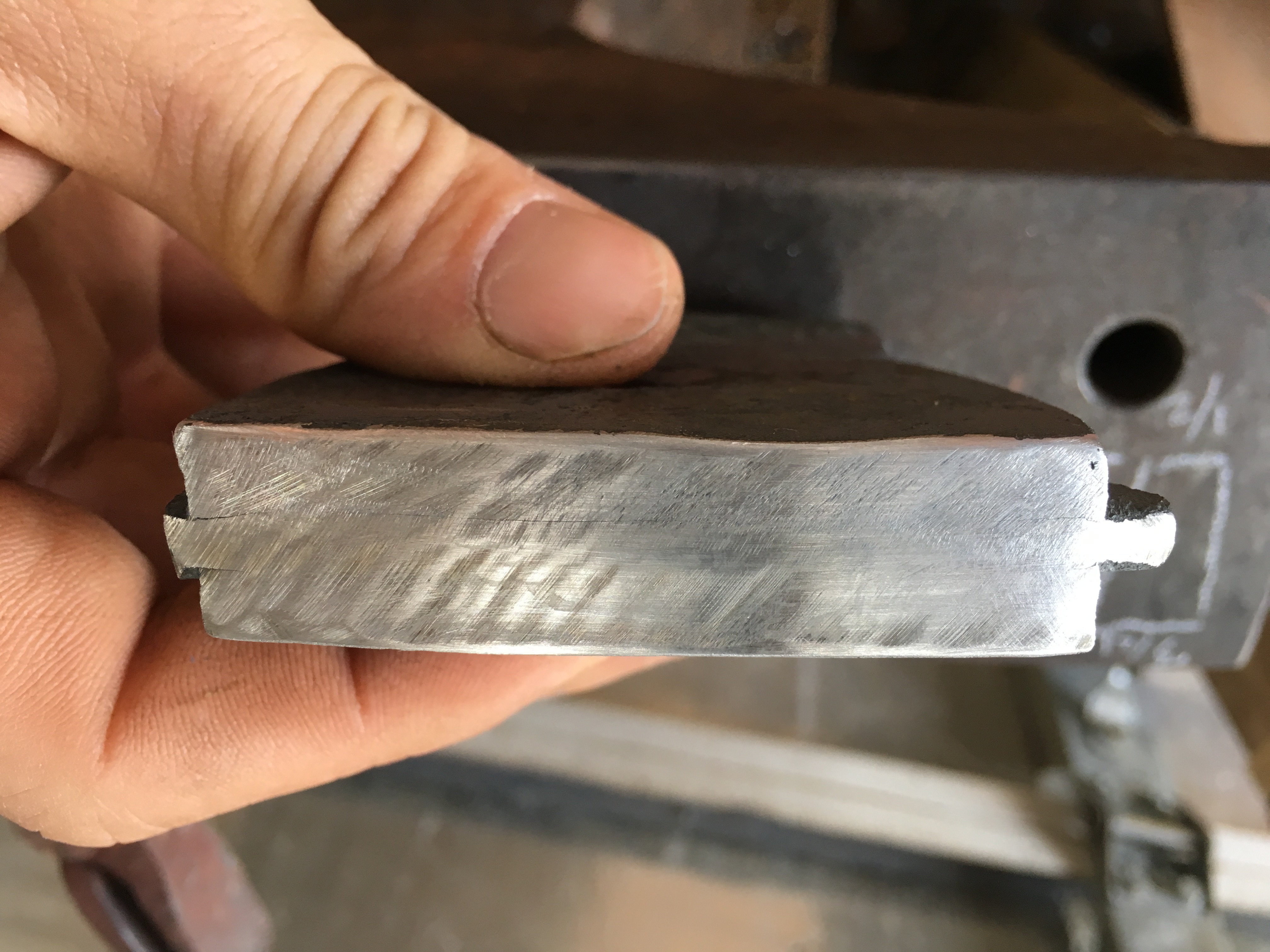

Michael Cochran Posted October 16, 2016 Share Posted October 16, 2016 I managed to get some shop time today and decided again to try for a folded style axe and got it looking decent. I now have to make a drift and I'm not sure I have anything large enough on hand that I can use. The rough measurements on the eye right now are .75" wide at the back tapering to .5" in the front and 1.5" front to back. I have a piece of axle that's roughly 1" round and I have 1x.375" that I could use. I know if I use the flat bar I'll have to weld two pieces together and might have to add a small piece of something else to make it thick enough I can smooth it up and be about the right size. I could try to upset the axle but usually I'm the one that gets upset not the steel. Any suggestions would be greatly appreciated. Quote Link to comment Share on other sites More sharing options...
Steve Sells Posted October 16, 2016 Share Posted October 16, 2016 looks like a good solid weld. If you want to reduce the loss of carbon in your bit due to migration at the cutting edge, now is the time to trim back the mild outer layers only at the tip, grind away like maybe a 20 degree or sleeper slope. you will have to reduce it there anyway to make a cutting edge, may as well have it exposed higher carbon. Quote Link to comment Share on other sites More sharing options...
Michael Cochran Posted October 16, 2016 Author Share Posted October 16, 2016 I was debating on doing that simply because the bit is so much thinner than the mild jacket and I new I ran the risk of it being consumed. I'd hate to get to the end of the process and find that the mild has completely enveloped the bit. I do appreciate you taking the time to make that suggestion, I'd never seen that mentioned before. Quote Link to comment Share on other sites More sharing options...

Michael Cochran Posted December 31, 2016 Author Share Posted December 31, 2016 I finally got to work on my drift some more but failed to do my math and other things right. I ended up forging the drift too long leaving too little meat to get the size I mention above. So I now have a piece of tools steel shaped like I wanted just much smaller. I'm hoping I didn't waste my time and fuel on this and need to start over but if I do then I do. The size I ended up with is about 3/8" on the narrow side and about 7/8" on the wide back side and is roughly 1 1/4" front to back. I know the ones you see at some stores now use nothing more than a piece of 5/8" tubing for the handle and they work ok as long as you don't get too rough. I have the steel and I have a fire right now so I can start over if I need to but I need to know is what I have large enough for a reliable hatchet? I'm hoping someone can tell me some good news here. I need a win after some of my recent failures but I don't want to sacrifice function just to feel better. Quote Link to comment Share on other sites More sharing options...
turbo7 Posted December 31, 2016 Share Posted December 31, 2016 Mate there is a line in your weld. Quote Link to comment Share on other sites More sharing options...
Michael Cochran Posted December 31, 2016 Author Share Posted December 31, 2016 18 minutes ago, turbo7 said: Mate there is a line in your weld. I assure it's not there anymore. Since those pictures were taken I took a few more welding heats and went back over the whole thing. I also have the blade section roughed out waiting for the eye to be finished. It's been sitting for a couple months now patiently waiting for me to come back to it. Thank you for that observation though. Quote Link to comment Share on other sites More sharing options...

turbo7 Posted January 2, 2017 Share Posted January 2, 2017 How about a front profile shot mate? The front profile needs to be smaller than the rear of it, also you want the edges well rounded mate. Quote Link to comment Share on other sites More sharing options...
NickOHH Posted January 2, 2017 Share Posted January 2, 2017 As turbo said. Should be tapered toward the front and the back should be tapered in a bit like a smushed egg and I would taper it toward the tip a bit more legnth wise, you want the top wider than the bottom so when it's wedged it can't come free even if loose. Quote Link to comment Share on other sites More sharing options...
Michael Cochran Posted January 2, 2017 Author Share Posted January 2, 2017 1 hour ago, turbo7 said: How about a front profile shot mate? The last picture shows the edge for the front of the eye. I stopped cleaning up the shape when I realized I had no idea the the size would be ok. I knew I still needed to do lots of work to it. Quote Link to comment Share on other sites More sharing options...
