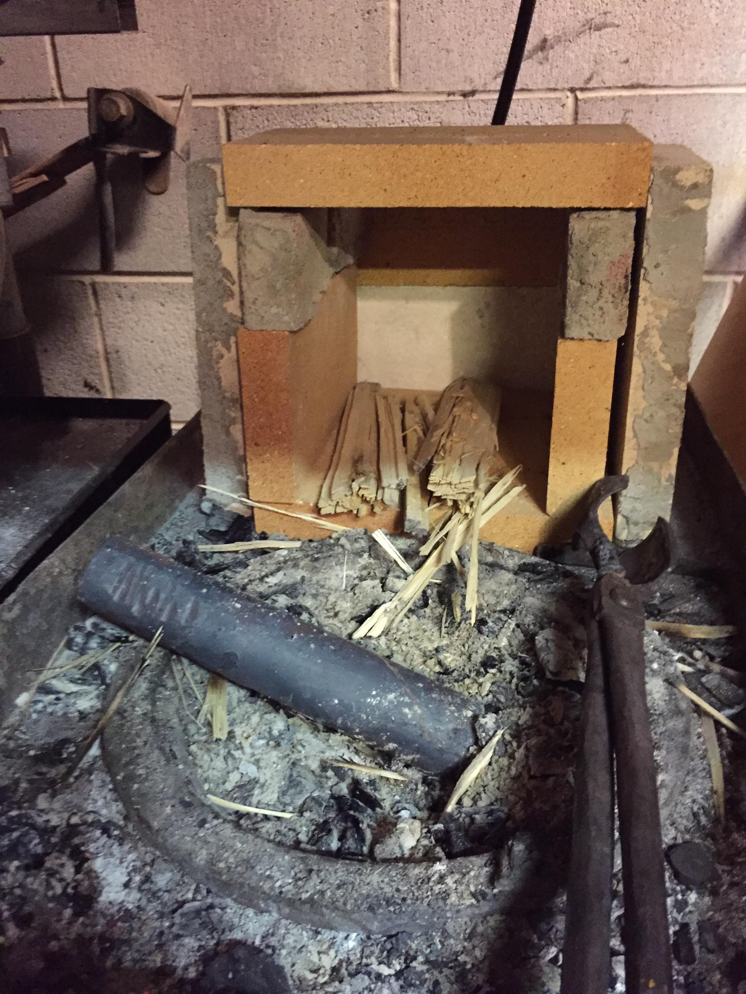

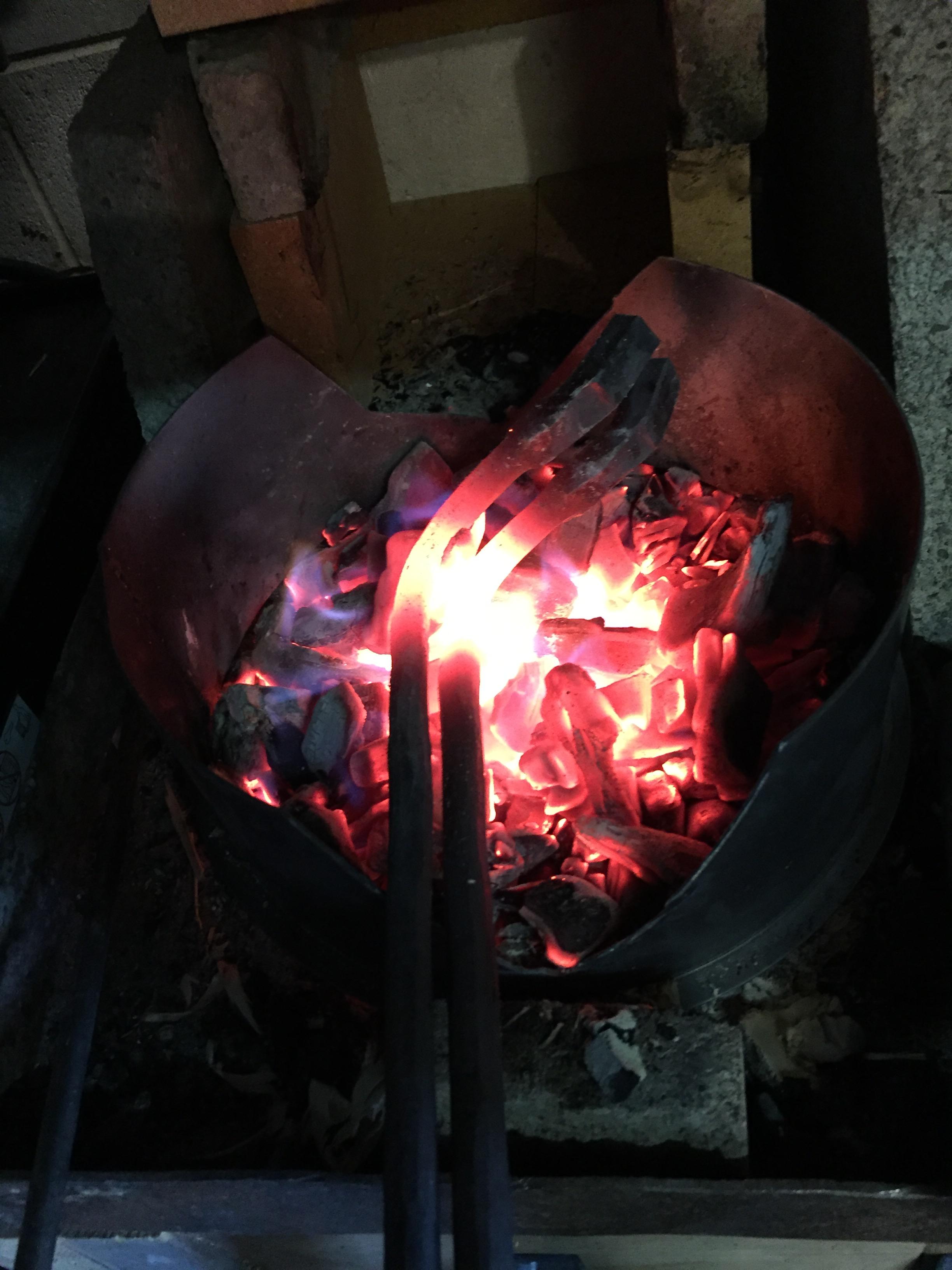

AdamG Posted April 2, 2017 Author Share Posted April 2, 2017 Ok, next round of hammers. I wanted a rounding hammer so I tried to make one out of 1045. I don't have the gear to move this size stock on my own. Just barely made the punch through. Next is my first Asian style hammer head. It's just mild steel, so it may be a prototype. Still had a hell of a time punching the hole. I don't think I am getting hot enough, and I need tongs for intermediate size round stock. Some pics of the fire... and a fail with large stock 4140. I thought I would make an axe eye drift. Barely made a dent! Quote Link to comment Share on other sites More sharing options...

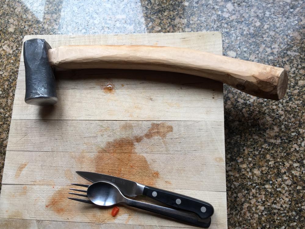

AdamG Posted April 8, 2017 Author Share Posted April 8, 2017 Just for fun I started a handle for the Asian hammer from a crabapple branch. What do you think? It's only rough right now, but I might keep it. This is the mild steel one anyway. Well, it not be very practical as is. The eye should be drifted much larger and more parallel I think. And I know that the wood grain direction is all wrong, but what the heck. Quote Link to comment Share on other sites More sharing options...
JHCC Posted April 8, 2017 Share Posted April 8, 2017 Looks nice. I'd taper the handle down towards the head a bit more, but otherwise leave it alone. How does it feel in the hand? Quote Link to comment Share on other sites More sharing options...
AdamG Posted April 8, 2017 Author Share Posted April 8, 2017 It's a bit strange, I won't lie, but mostly because the handle is wide relative to the size of the head, but there's a knot at the bottom that acts like an axe handle. I think I will thin some of it down and see if it ends up good for chisels or maybe some small knife bevel forging. Mostly I was trying to get some miles on my tools (hammer eye punch and power hammer). Both need some work! Quote Link to comment Share on other sites More sharing options...
AdamG Posted April 9, 2017 Author Share Posted April 9, 2017 Looking better I think: Quote Link to comment Share on other sites More sharing options...
C-1ToolSteel Posted April 10, 2017 Share Posted April 10, 2017 The problem I'm thinking of with the hatchet style handle is that your hand will be significantly lower than when using a regular hammer. I like the swell at the end, though. Quote Link to comment Share on other sites More sharing options...

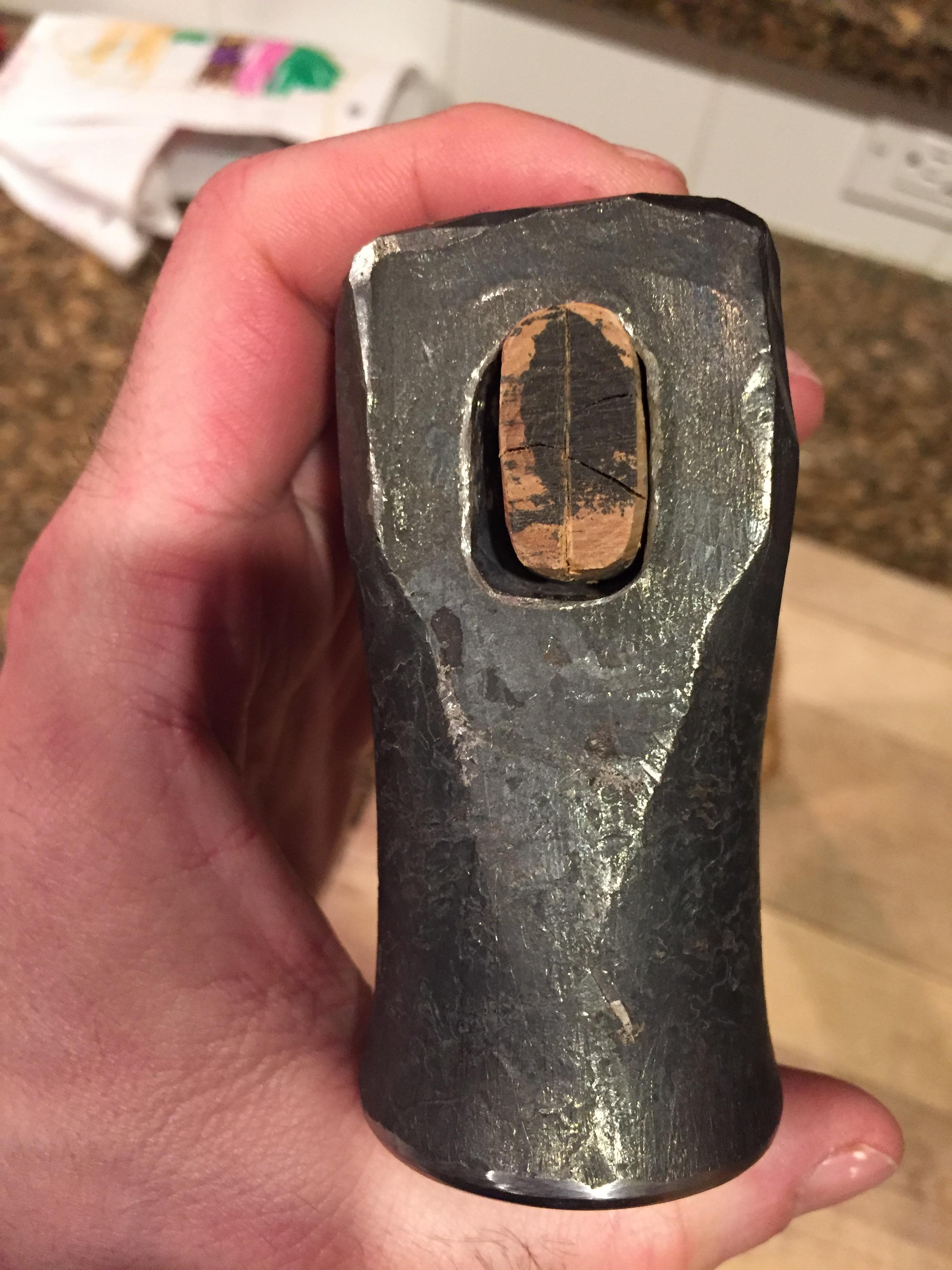

AdamG Posted April 24, 2017 Author Share Posted April 24, 2017 Here's a bit of a diversion making bolt tongs (poorly) and some pics of the dog head hammer in use: I used Gorilla Glue on the wedge, but I don't think I would recommend it. After trimming back the foam so it didn't look ridiculous there was little left to hold in the wedge. I thought it would expand into the voids and be more flexible than epoxy. The eye was not perfect. Good of fun anyway, and even the mild steel didn't get banged up working on mild steel tongs. Quote Link to comment Share on other sites More sharing options...
Frosty Posted April 24, 2017 Share Posted April 24, 2017 Nice hammer head but I sure don't like the handle. It wouldn't automatically index in the hand and strike parallel with the anvil face. I don't want to use a tool I have to devote more thought to making it hit correctly than the work. As a test, hold it loosely in your hammer hand, assume a relaxed stance like you're working at your anvil and lay the hammer face on the anvil. Do you have to hold it in a special way to allow the hammer face to lay flat on the anvil? Ideally you should be able to just let the hammer head drop and have it strike the anvil parallel in both dimensions. That is just MY opinion and preferences your's are your's. No problem, different is good, you learn from different. Frosty The Lucky. Quote Link to comment Share on other sites More sharing options...
AdamG Posted April 24, 2017 Author Share Posted April 24, 2017 Good points, thanks, Frosty. I did flatten the sides so it indexes to my fingertips , but the dogleg handle might have to go. Quote Link to comment Share on other sites More sharing options...
Frosty Posted April 24, 2017 Share Posted April 24, 2017 It's what works for you, some things are pretty universal but everybody is different. I'd keep the knob on the end, all my slab handles have a knob. I don't like my hammers taking solo flights in the shop. Frosty The Lucky. Quote Link to comment Share on other sites More sharing options...
