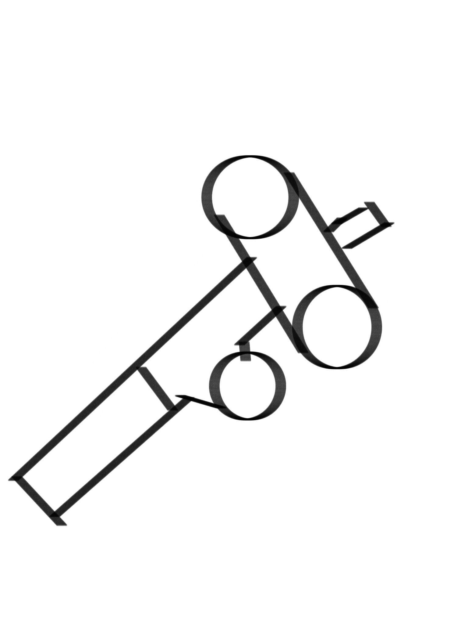

Lou L Posted May 8, 2018 Share Posted May 8, 2018 Okay, Frosty, here is my ridiculous idea. I have a 100 CFM blower that doesn’t have super high static pressure. I don’t believe it can power a regular ribbon burner but thought it might increase be fun to see if it offered increased ability for me to power a slightly larger burner or perhaps offer more tuning options. We’ve already established that I am ignorant and this would be my way to play around with some 2x4’s, experiment and learn something. I would make a regular burner using your formula first and use that once I get it right. Then I may play around... I found loads of options for every part I could imagine needing at great prices at supplyhouse.com. Awesome web reseller so far and I even grabbed thread protectors (steel merchant couplers) super cheap. It was better than playing games with the guys at the plumbing supply who didn’t even want to deal with me when I was buying the stuff for my bathroom remodel. They only like contractors. Anyway, I found a 2” wye in black iron and would attach that to the 1x1x3/4 Tee. To that I would add a 4 or 6” nipple (thinking I may need more distance for the fuel air to mix. I would weld nuts to the opening of each 1” opening on the tee to install governors. I assume the governors would have to have holes in them so,it is impossible to completely shut off the draw of air through them. The forced air would enter through the wye connector on the bottom of the burner. I love your NARB because it requires no power and no expensive blower. But I figured it may be worthwhile to see if a cheap blower could be added to the design to any benefit. Be prepared...my drawing looks like my five year old got his hands on the sketch app on the iPad. That’s not far from true. But I think the concept is clear enough. It is obviously not to scale... It is, in fact, embarrassingly bad. But I figured it works good enough for the purpose. I read Mikey’s post about fitting blowers in the shell and the effects of air gaps and realized that more air can often be a bad thing. This could result in a fuel hog that burns dull red at best. Feel free to tell me I’m tilting at windmills. I wouldn’t share my dumb ideas with the pros if I wasn’t willing to hear that Lou Quote Link to comment Share on other sites More sharing options...
Frosty Posted May 8, 2018 Author Share Posted May 8, 2018 I'll play Lou, I've been wrong so many times I'm used to it. I had to look up what a plumbing WYE is and discovered it's more of an adverb than an adjective. Two things: One, the connection between the blower and the NA tube needs to be almost tangential so the blast (blown air) entrains air from the NA circuit rather than cause back pressure. Yes? I don't see a WYE I think is acute enough but maybe? Two, I think you're going to need a second propane jet or the blower is going to lean the mix till it won't burn at all. OR if the NA jet is large enough to supply the blower it'll be too rich to burn as a NA, probably just won't entrain enough or any air in the NA circuit at all. Just not enough velocity. The same thing in effect but two different causes. I think this is going to be an exercise in mating two kinds of burners and the real trick will be in making it an either or device. Do we use a barometer sensor to open the second jet when the blower kicks on or perhaps an anemometer that opens the second gas valve in increments depending on the blast metering the fuel for the correct ratio. Does that make any sense? I use graph paper to make concept and working sketches it makes a big difference. I'm no sketch artist but I can make mechanical drawings. There's a BIG difference and graph paper makes it so you don't need a T square or triangles. This is going to be fun, I'll brainstorm with you, let you experiment and take credit. Frosty The Lucky. Quote Link to comment Share on other sites More sharing options...
