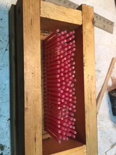

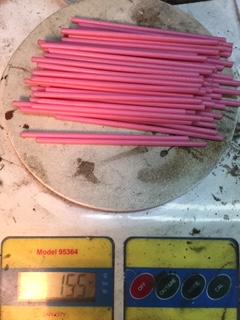

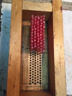

D.Rotblatt Posted March 16, 2019 Share Posted March 16, 2019 Since the burner is working so well, I thought I'd post some pics of the build. I used an ancient box of Kerr sprue wax, the rods measured 1/8" x 4" long. Can't find that brand anymore, the closest I see on amazon is 8 gauge which is 3.25mm or .128". I cut the 4" rods in half. 123 holes = 64 pieces cut in half. It came to 1.55 oz of wax. The wax on amazon is $25 for 8 oz. That's enough for 5 burners the size mine was, so purchased new it comes to about $5 of wax for the one burner. The main problem I had was that the aggregate in the Mizzou was too large to fit between the sprues. I had to use a thin knife blade to push the refractory between the rods in little bits. Took quite awhile and the Mizzou started to set up around the edges...then I had to dig up a groove to put the Plenum into...basically it was a bit of a cluster ****. But I got it together (no pics of that part of the build). I believe that Frosty has mentioned running the refractory through a strainer to remove the aggregate. I'll try that if I do this again (and I might for my longer forced air ribbon burner). I made a plate with matched holes thinking the wax would bend, but the 2" pieces kept pretty straight and I didn't use it. Link to comment Share on other sites More sharing options...
Frosty Posted March 16, 2019 Author Share Posted March 16, 2019 That's really close spacing Dan, I had trouble getting Kastolite between the crayons and they're a lot farther apart. I wonder how it'd work to replace the aggregate with zircopax. Your method looks just like mine without paint. Frosty The Lucky. Link to comment Share on other sites More sharing options...
D.Rotblatt Posted March 16, 2019 Share Posted March 16, 2019 It was a pain, and it took a bit of time, but it ended up with a good solid face. I did a lot of vibrating to try to get the bubbles out and it worked. One thing I'm noticing is that the area with the nozzles is staying pretty cool, but I ran out of gas and haven't run it very long. I'm hoping this might be a cure for the low pressure backfire issues of multi-burners. Zircopax is a powder (or my zircon is) and I don't think it will perform the same function as an aggregate, though it might work as a filler. On the other hand, it seems the muddy liquid that bleeds out of the refractory when vibrated still sets up hard so I'm going to try just sifting the Mizzou through a screen and see if that works. If it does, I can try adding zircon to see if it extends it. I might also try a paste of zircon and colloidal silica binder. We'll see if I have the time to really play with this. I also saw a post here of a person using a mix of 95% calcined alumina and bentonite to make a burner nozzle. He seemed to just fire in a forge after baking it at 400 till dry. I'm trying to figure out what those white ceramic burner heads are made of - I think that would work well. The spacing of the burner tubes could even be closer. This is the only thing I've found online. Dan R Link to comment Share on other sites More sharing options...
Frosty Posted March 16, 2019 Author Share Posted March 16, 2019 I found the aggregate was too course to get it to flow under vibration. The milky water pumping out while vibrating indicates too wet a mix and water is displacing refractory. Don't worry though, this isn't a road grade so mechanical strength isn't an issue, we're not using it to carry weight. It's an indication though and we don't want to flush the calcite binders out. I was thinking of shifting the gradation to more of a grout than a concrete by replacing aggregate with zircopax. Now you mention it I have zircopax flour which by definition passes a -200 seive. The field test is to touch a bit on your tongue and se if you can feel it against the roof of your mouth or gums. NO I'm not suggesting anybody to that I'm only mentioning an old test when you didn't have the lab tools. One of our guys here made a darned impressive zircopax and Bentone (in the bentonite family) refractory tiles experimenting with kiln washes and forge liners. IIRC he had excellent luck with 97% Zircopax to 3% Bentone. About not burning back. Isn't there an opening size under which a flame can't propagate? Frosty The Lucky. Link to comment Share on other sites More sharing options...

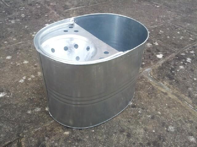

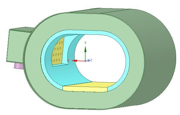

tinkertim Posted March 24, 2019 Share Posted March 24, 2019 Well I've been hunting for a suitable container to build a new forge within, to suit my IFB-based NARB. Having seen commercial oval forges for sale, as well as reading about people using an exhaust "muffler" (or silencer in the UK), I had an idea. You can get oval steel mop buckets from a company called Screwfix (Google: screwfix steel mop bucket) as well as lots of other places on the web. They offer dimensions for these buckets, but it's not clear where the measurements are taken from, but from my initial guestimations it should come under my 350 cubic inch target, so I went and bought one. I then measured it accurately and mocked up a CAD layout for a two-layer of 1" ceramic fibre, with an Insulated Fire Brick (IFB) as the base, and cut a hole in it where I think the NARB would suit. The depth of the bucket is 8.5", and with the dimensions I calculated, the inner volume to be ~324 cubic inches! Right where I wanted to be with a 3/4" AMAL Propane injector feeding the NARB. I'm hoping with the longer roof (due to the oval shape) that there should be a good amount of roof and wall to radiate IR downwards, and the oval shape should allow for swirl as well. I will be making up support brackets at the front and back to allow for IFBs to be positioned to reduce the opening size, and I will be grinding off the galvanised finish on the edges of the bucket where flames might reach, and will coating the inner, and outer edges with the Colloidal Silica slurry and Zircopax mix in D.Rotblatt's fashion. Any feedback on the orientation of the NARB burner? Tink! Link to comment Share on other sites More sharing options...
Frosty Posted March 24, 2019 Author Share Posted March 24, 2019 It's a good shape but have you considered how much trouble it'll be to strip the galvanizing? That's a lot of vinegar. It won't get hot enough to matter on the inside but where the dragon's breath hits the outside it sure might. You don't want to breath zinc oxide smoke, it's BAD for you. Frosty The Lucky. Link to comment Share on other sites More sharing options...
