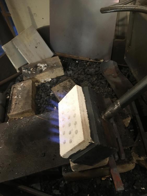

Judson Yaggy Posted December 30, 2018 Share Posted December 30, 2018 Hi all, here is my entry into the multi-port game. 3/4" with an AMAL commercial injector. 7" tube. Started with 19 @ 5/16" holes, got some backfires so ended up plugging 2 of them with furnace cement and it runs like a dream. As an experiment/proof of concept I used a 3000 deg. insulating fire brick as the burner block. Super easy to drill and cut, very precice holes. I put a little countersink/taper/flare on the buisness end of the burner holes. Only used for about 6 hours so far but the brick still looks lilke new. Time will tell if it has the longevity needed. Delivers a high yellow heat at 10 psi, starts to backfire around 3 psi. Like everyone says, these things are nice and quiet. The hiss of gas going thru the injector is louder than the noise of the burn. The smaller block was the drop from the brick I cut down, with hole spacing half as far apart. I drilled it a little more aggressively, got it up to yellow in my other forge, and manhandled it a bit as a stress test. When it didn't crack I felt like I was good to go with the hole spacing in the bigger block. Quote Link to comment Share on other sites More sharing options...
Daguy Posted December 31, 2018 Share Posted December 31, 2018 Nice job, Judson! Another new idea: cutting a firebrick to shape and drilling it out to use as for the working end of the burner. If you have the tools, it looks like a good option. Hope it lasts, keep us updated. Daguy p.s. (how is the brick attached to the mix chamber? Quote Link to comment Share on other sites More sharing options...
