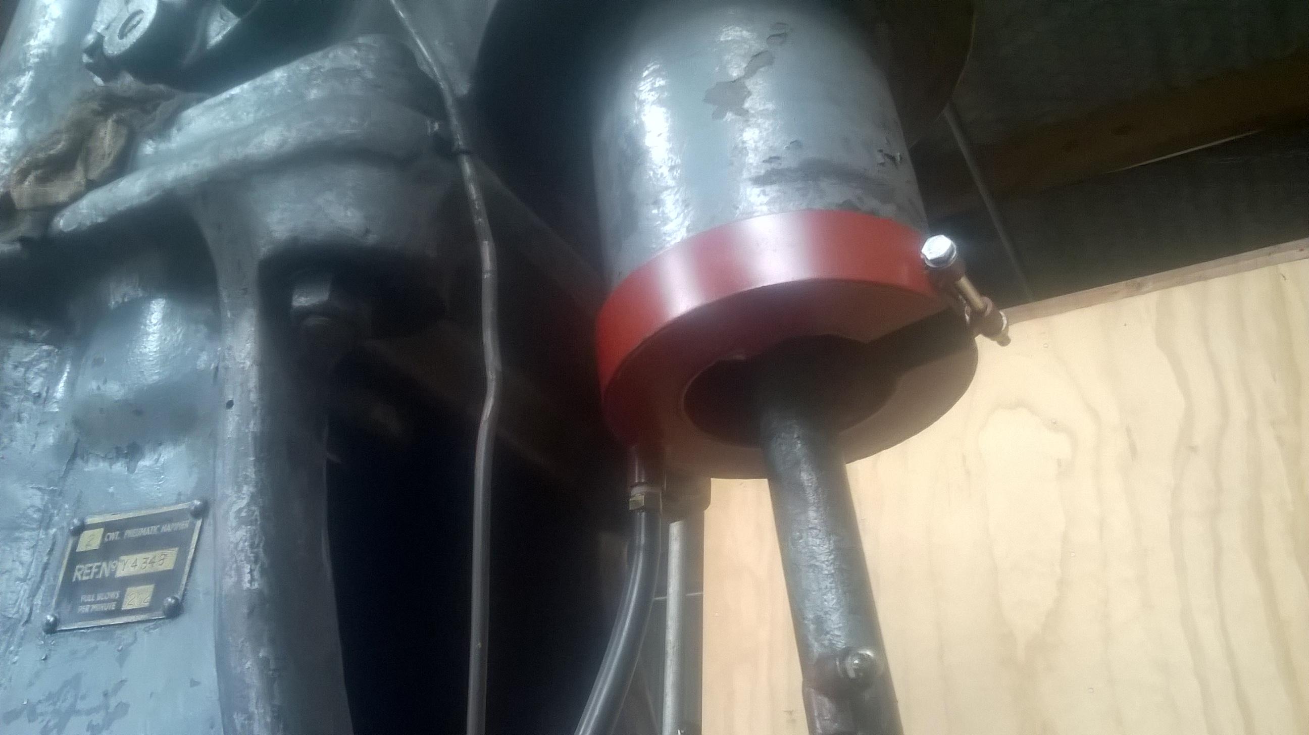

BeaverNZ Posted May 15, 2019 Author Share Posted May 15, 2019 I have finally got my power hammer instillation complete apart from painting the motor mount and new guarding Yippie its only taken two years but the winter weather is here and I dont want to get soaked by doing the outside work. I may yet put a rolled flat bar around over the foot pedal yet just to stop any heavy items that get away from pushing the bar down I think that will be the least intrusive meathod of making this safer Quote Link to comment Share on other sites More sharing options...
Peter_Omakau Posted May 15, 2019 Share Posted May 15, 2019 Congratulations on getting it finished. Great job! I finished my "economical" install and have been using the Massey for a few weeks. Only about 2 cubic meters of concrete with 150mm of end grain timber under the anvil. Apparently the ground shakes but you certainly don't notice that as the operator. I have been using it for making pattern welded steel and only need one heat for every fold. The force keeps the billet up almost at welding temperature for the weld and drawing out. Very productive but because of the efficiency it doesn't get as much use as my Anderson used to. Quote Link to comment Share on other sites More sharing options...
