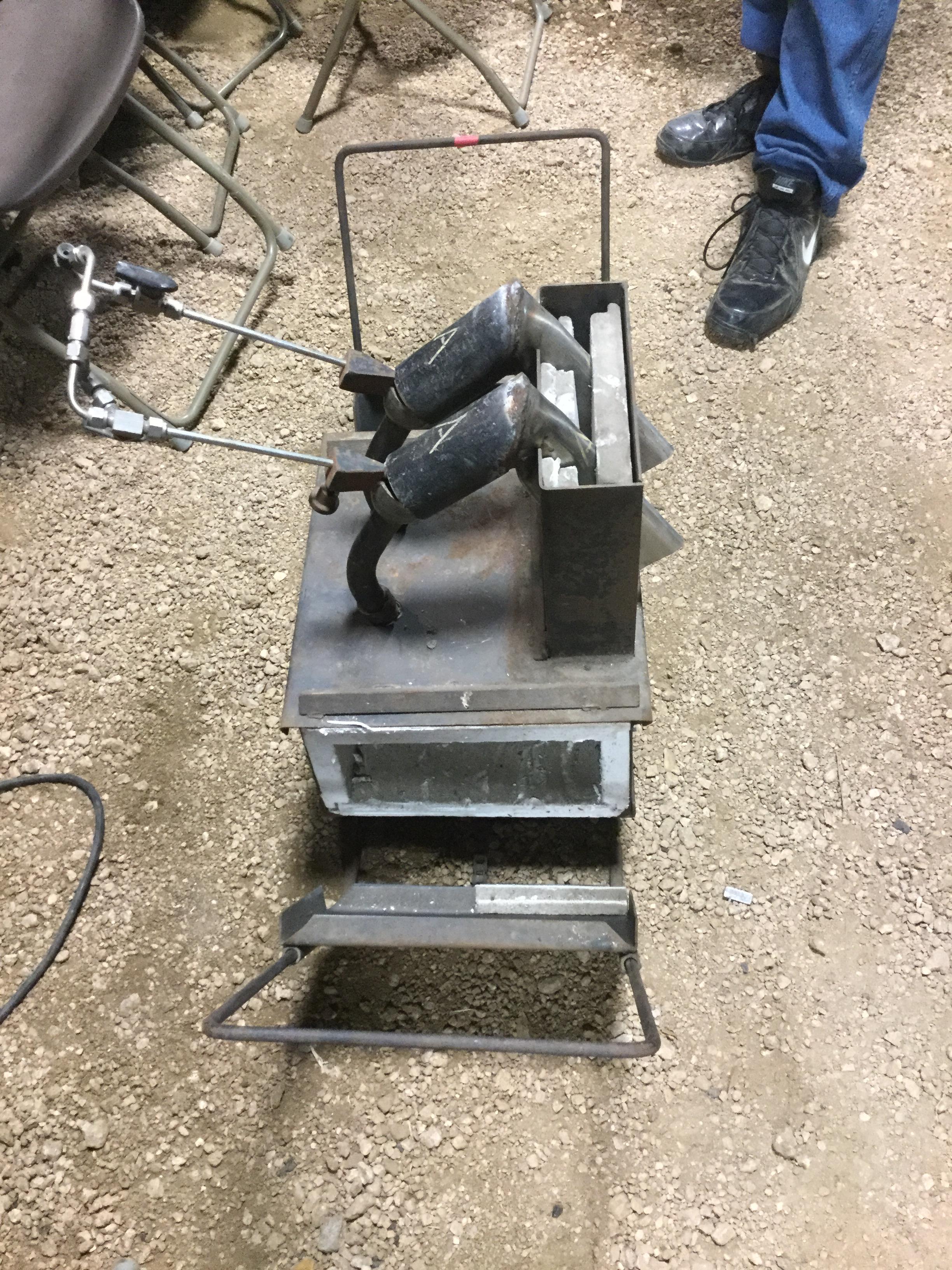

ThomasPowers Posted August 13, 2017 Share Posted August 13, 2017 I rather like using the workpiece opening as the exhaust as it means that heat is being pushed that away . Have you looked at the Sandia Forge Design that uses the exhaust to preheat the incoming gasses? AKA as a recuperative forge. Quote Link to comment Share on other sites More sharing options...

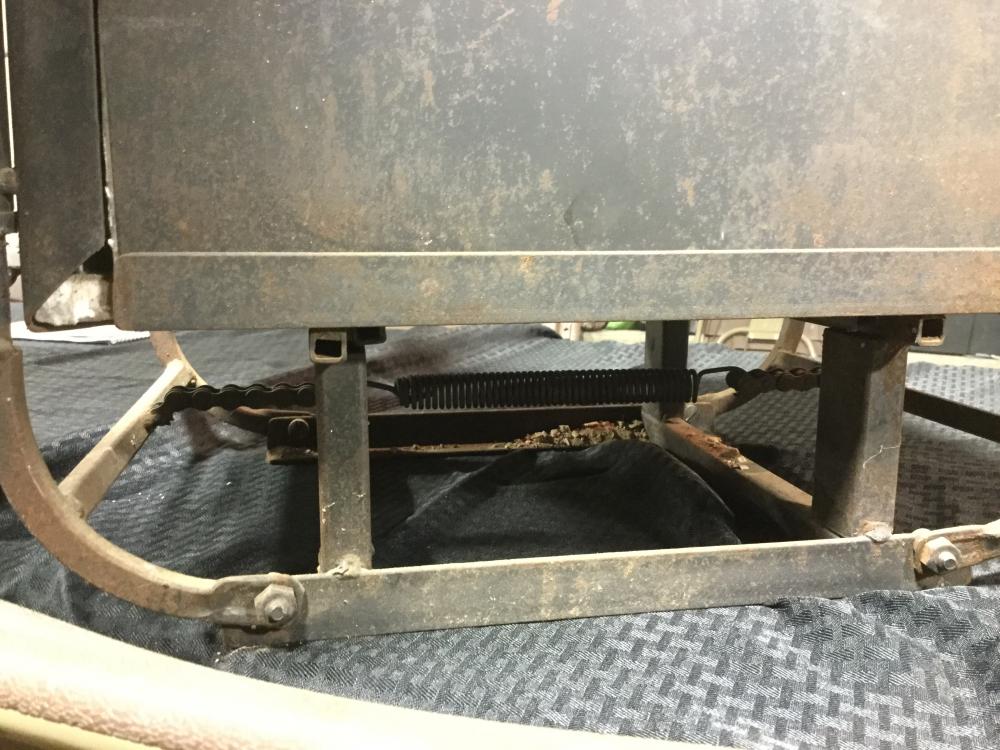

ede Posted August 14, 2017 Share Posted August 14, 2017 I saw a Sandia recupertaive forge come up on auction awhile back. I ended up bidding on it, but didn't win. I took plenty of pictures of it. The gas manifold was expertyly tig welded together. Mikey, thanks for the pic of your vortex burner! Ede Quote Link to comment Share on other sites More sharing options...
