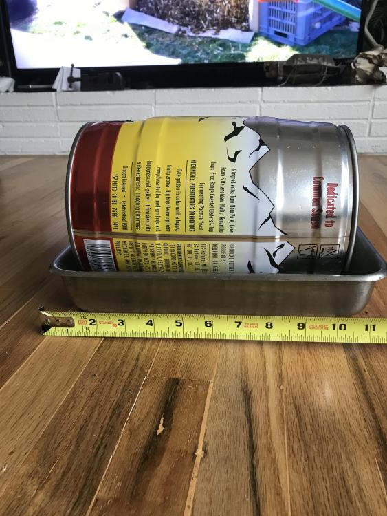

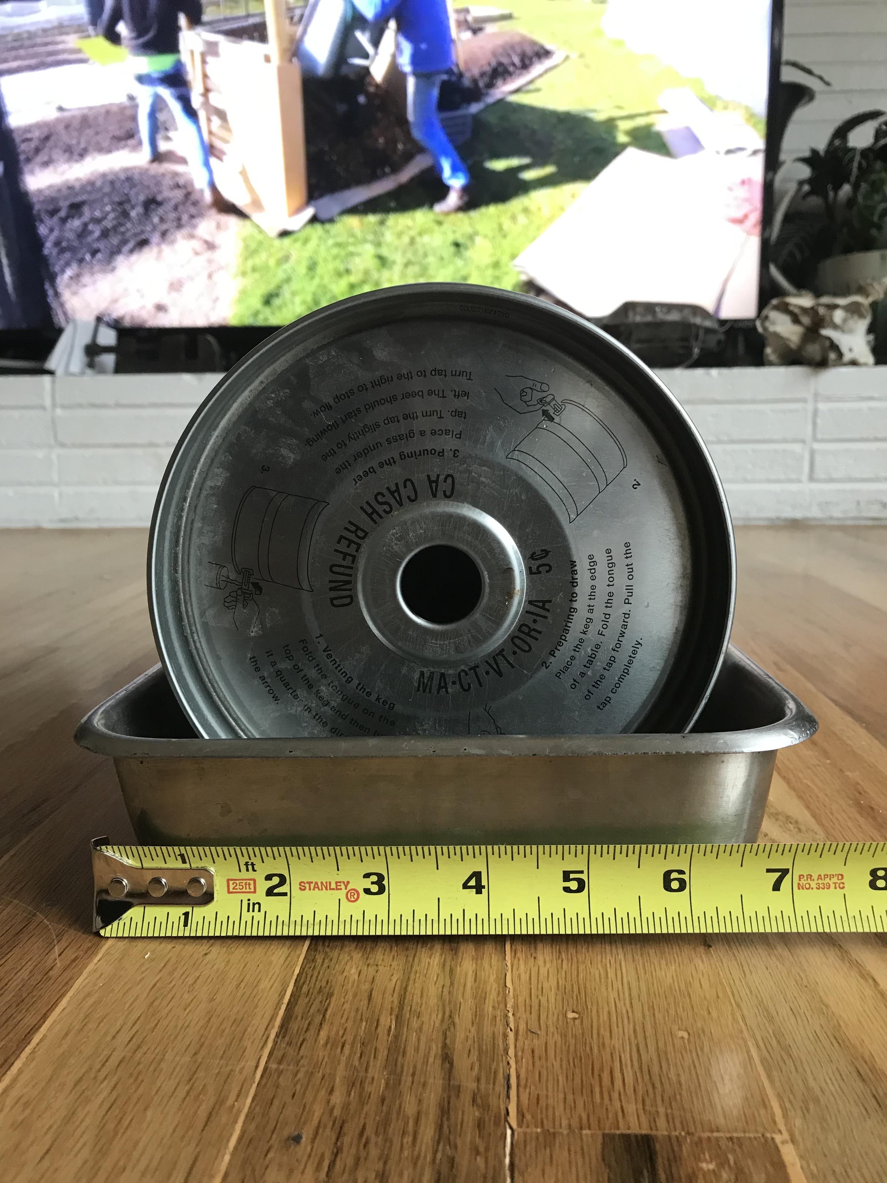

671jungle Posted April 15, 2019 Share Posted April 15, 2019 New forge build. Dropped the last one with the aluminum body and the kasto cracked. I didn’t bother sealing it up and the heat leak was too much for the aluminum. Which I knew/hope would happen. So, eager to build again (I think I’m more addicted to design than anything), I gathered more materials. I wanted the same D shape but even smaller. I would like to use a 1/4” burner or burners. If more than one which I’m leaning to, how many? Is three too much? It will be insulated accordingly: 2” of rigidized wool everywhere coated with kasto. Quote Link to comment Share on other sites More sharing options...
Mikey98118 Posted April 16, 2019 Author Share Posted April 16, 2019 22 hours ago, 671jungle said: So, eager to build again (I think I’m more addicted to design than anything), I gathered more materials. I wanted the same D shape but even smaller. Good; I would like to see more people choosing to make "D" forges Quote Link to comment Share on other sites More sharing options...
